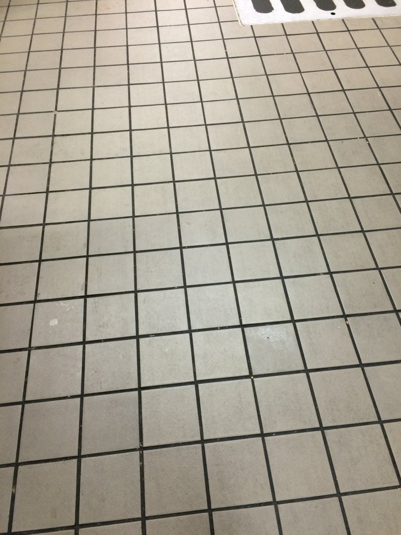

How would you clean this
jwfoulk12
Aug 10, 2012
861
PA
Justin Foulk
Hasn't been cleaned in probably 15 years or so. It's in a kitchen in a correctional facility. How would you go about it? What chemicals and equipment would you use, and what would you charge for aproxamately 1200sf?
Old Coastie
Jun 29, 2015
7,504
Heart of Dixie
Stephen
Citra-solve, Viper Venom or any other good degreasing detergent. Let it dwell, agitate generously with a soft brush, 175 with a blue Malish brush, a CRB, anything. Slurp it up. Repeat as needed.
50-75 cents a foot.
Simple.
jwfoulk12
Aug 10, 2012
861
PA
Justin Foulk
Was planning on Flex with citrus, crb with stiff bristles, and a spinner. Have been wanting to pick up an Interlink brush so this will give me a reason to. Any other thoughts on price or technique?
Russ T.
Sep 26, 2008
3,556
Slater, IA
Russ Terhaar
Don't be afraid to charge near $1 per foot. I bet you can get it to pop and they will be thrilled!
Try to get them on a maintenance plan that will bring the price down considerably on subsequent cleanings.
GCCLee
Jan 29, 2012
5,113
East TN
C. Lee
Honestly, I am loving Slop n Gobble on Tile.
Dwell it, Blast it w water and Suk your hearts out : )
Can't Hate Honesty : )
115,974
SnG is great on tile
And carpet.
_(_________
Straight forward job Justin.
Add a little vct stripper to your mix you're worried.
Apr 9, 2014
550
Covert
Marcus
Agree on the shorebest just got some this summer....I also use flex citrus
Scrub with a small rotary or crb( expensive tool)
Or hire a worker with a grout brush.
The shorebest will require less scrubbing
