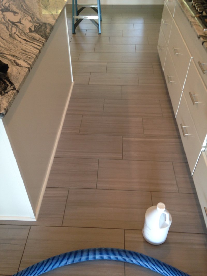

IMG_1414.JPG For me, anyway. We cleaned 3200 s.f. of this. ^^
It had grout haze all over it. I didn't know how to approach it, so I called Mikey and got the scoop. It turned out great. THANK YOU BUCKET HEAD!!!
I elected not to call Saiger, because I really needed to get it done before dark.

Is a ladder the secret to success in big tile floor jobs?
I knew I've been missing something.
Reactions: Willy P
14,080
Tile installers just wipe the grout with a wet sponge with just water to get it off. Why couldn't you just get a wet white pad and a 4-500 psi plain rinse to get it off?
Would vinegar work ? It's an acid. Spray on and bonnet off?

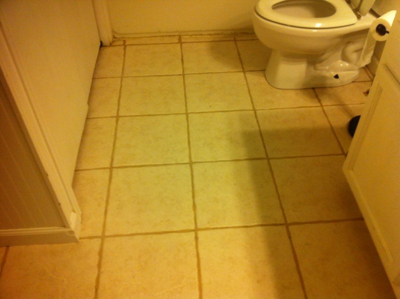

Sometimes installers (and especially do it yourself types) use a broadaxe to smear the grout around. This blurry picture shows one that actually looked like dog poop. I had to use a concrete brightener (phosphoric mix acid) to soften the grout and work it down by hand, as a pad would have torn itself up.
