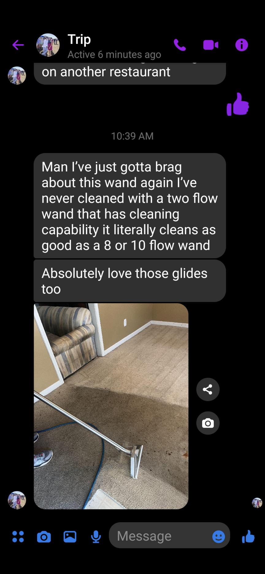

Those usually have two # 2 jets 4 flow.
I have a 6 flow 6 jet prochem to for winter when I'm looking to get better dry times.
So that aw29 has two #1 jets 8001, 9501???
115,994
No, its four flow.
He had a brain fart.
Four flow at 500 psi from two jets, properly angled, works terrific, and dry times are excellent
Assuming you've dry vacuumed, pre-sprayed, and used dwell time and or agitated
Reactions: SamIam
11,302
No, its four flow.
That makes more sense.
Yes at 4 flow it's a good little wand
