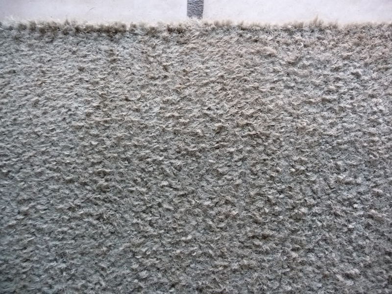

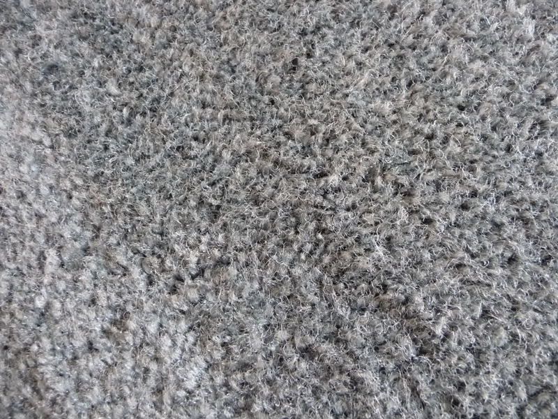

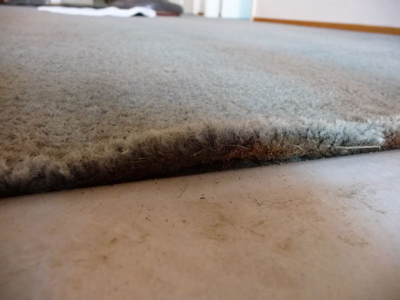

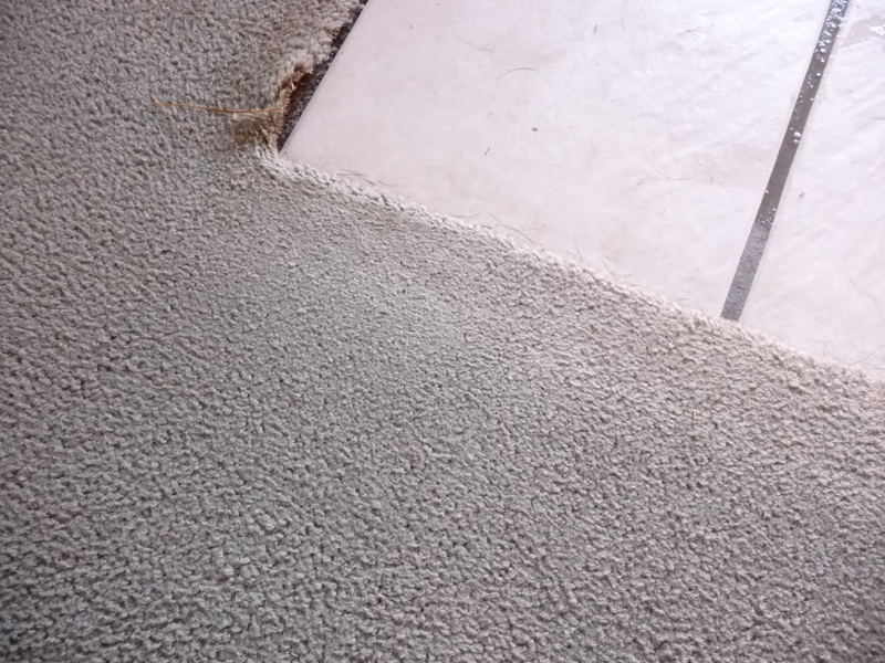

Below are some pics of a dump we "cleaned " today. After "Hello" the next words out of my mouth were, wow! time to replace this one!.
The new tenants accepted it as they have two cats and know that they will be destroying it.

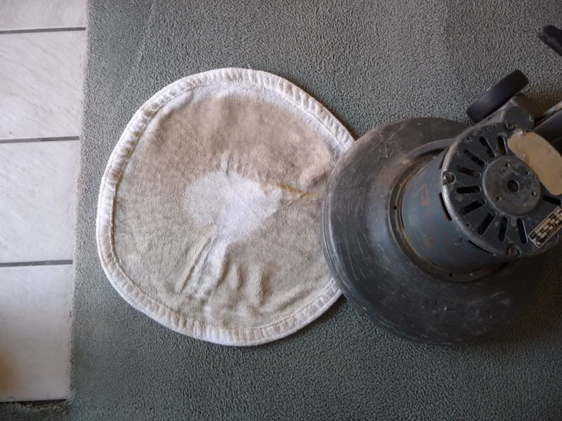

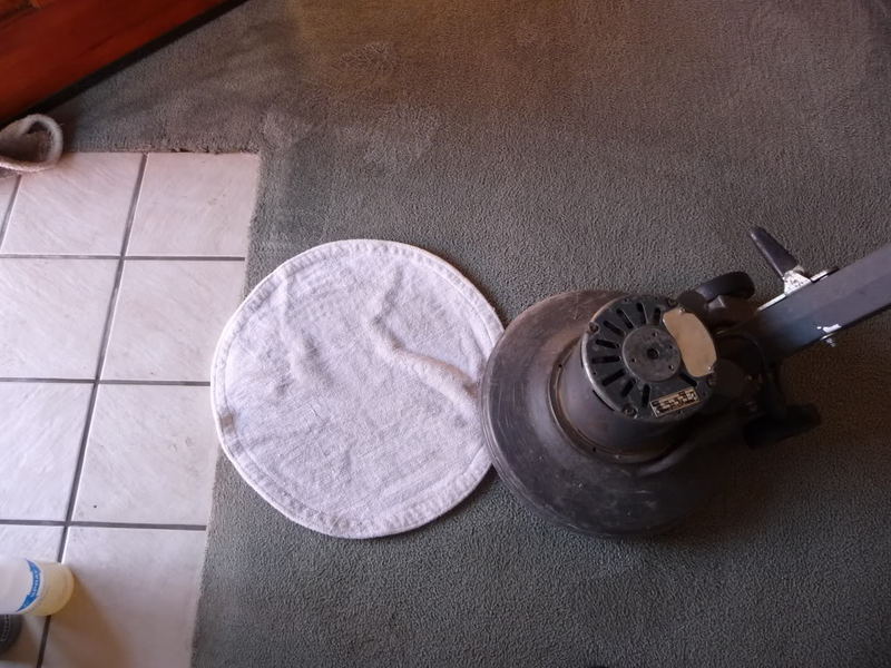

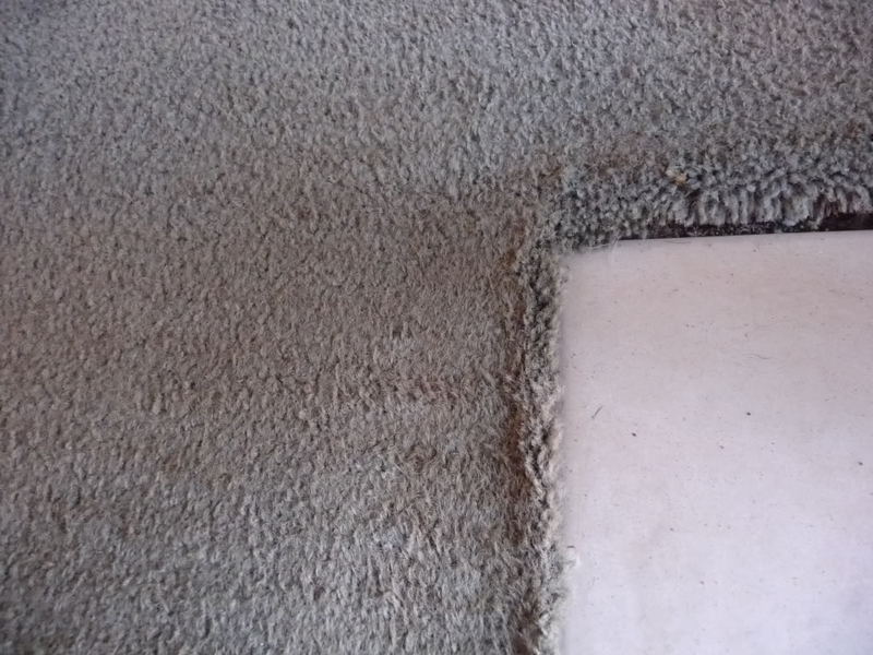

We pre vacuumed, used Redline boosted with DD12 and 40 vol and scrubbed with a Tan pad. Wanded like mad with O2 rinse and post padded with a 40 vol/encap misting. Looked better but still was so impacted by the front door you could knock on it and it sounded like wood.
Cleanest/ least worn area I could find..
After wanding , before padding
New pad..
After 9 feet of entry area..
Done and looking like Vawter's lung.

A stiff bristle brush on the rotary, a slot glide and some Esteem CBS in the rinse would have cut your time down,reset the nap better and left a better appearance.
You could maybe even have been profitable at less than the cost of replacement. :shock:
116,071
The last shot was not groomed and yes, I do need a shampoo brush for garbage like this.
Who said it took long?
.48 was worth it to both parties involved.
116,071
Sure they do.
Most carpet worth cleaning respond just fine.
Garbage like this stuff need a Nylogrit.
I doubt my GLS would have done any better.
Rex Tyus
3,720
I forget where you are. Cost of replacement is more than likely considerably higher there than here.
Didn't say it took long just know it would have taken less time with a good emulsifier and a slot. I do quite a few of those types. Not proud if it but not ashamed either. :wink: A slot with the suction you have will rip more soil out of the backing n stuff like that than one can believe.
IF, your biceps are big enough to handle it. 8)

Have to disagree,I have used both and using a pad on pile carpet is like using a loofa on your hair opposed to your fingers(which would be the brush)
What your talking about is just changing the coarseness of the pad,which works great on commercial and hard surface,but it cannot reach the bottoms of any pile 3/8 or better in lenth.just like it isnt really effective with inset grout lines.You really should have a brush ,you hack
Shampoo brush may be too soft Mikey. Suggest you also get a tile brush for real grotty polyprop carpets - don't ask how we found that out :oops:

Did you prevac?? That set of pictures looked really muddy. And yes I rember that deal thingy; I was working for SP at the time doing WDR. Yeah they lost theirs shirts on that.
