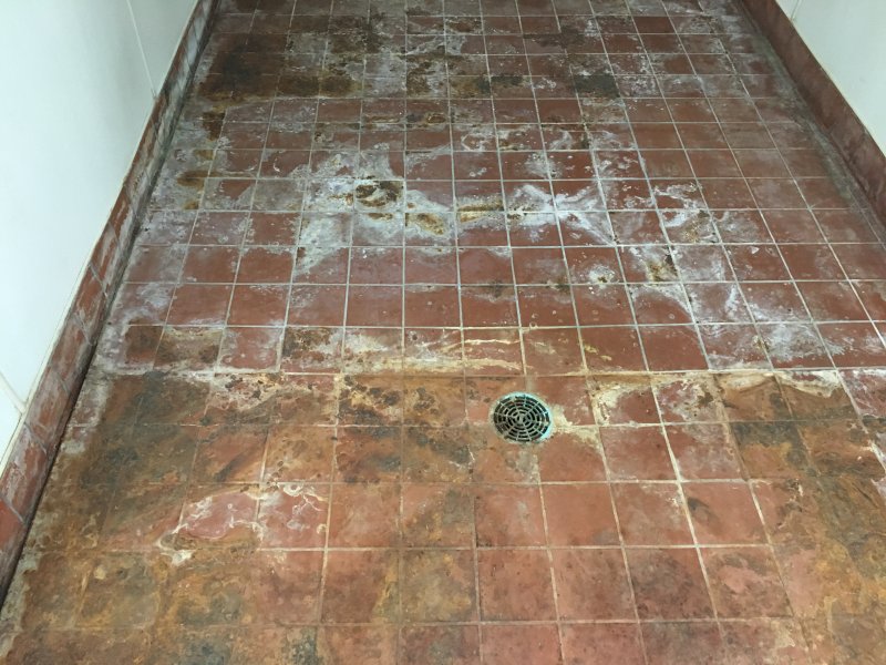

I need some help on this restaurant kitchen tile
14,083
14,083
Rust, some other goodies where s commercial freezer was
I've got a 175, truckmount and...
Who wants to go first? And how long should that take?

Just turn your heat on high and your psi up to 2500. Use a 17 inch turbo hybrid. It comes right off:biggrin::biggrin::biggrin::biggrin:

I do school kitchens every summer with that flor in them. I've found hot pressure washing with a wand that adjusts from a straight stream to a fan spray works best.
You'll figure it out.

Viper Renew to soak and break up the rust and calcium. Maybe use a floor scraper to speed it up.
https://interlinksupply.com/index.php?item_num=CH49GL
Then a strong degreaser (Viper Venom is great) to cook the grout, rinse and repeat.
I finished off the above floor with a phosphoric acid concrete brightener to whiten the lines, but it may not be necessary in your case.
Time, about four hours for that mess. Allow time to soak, so maybe six.
