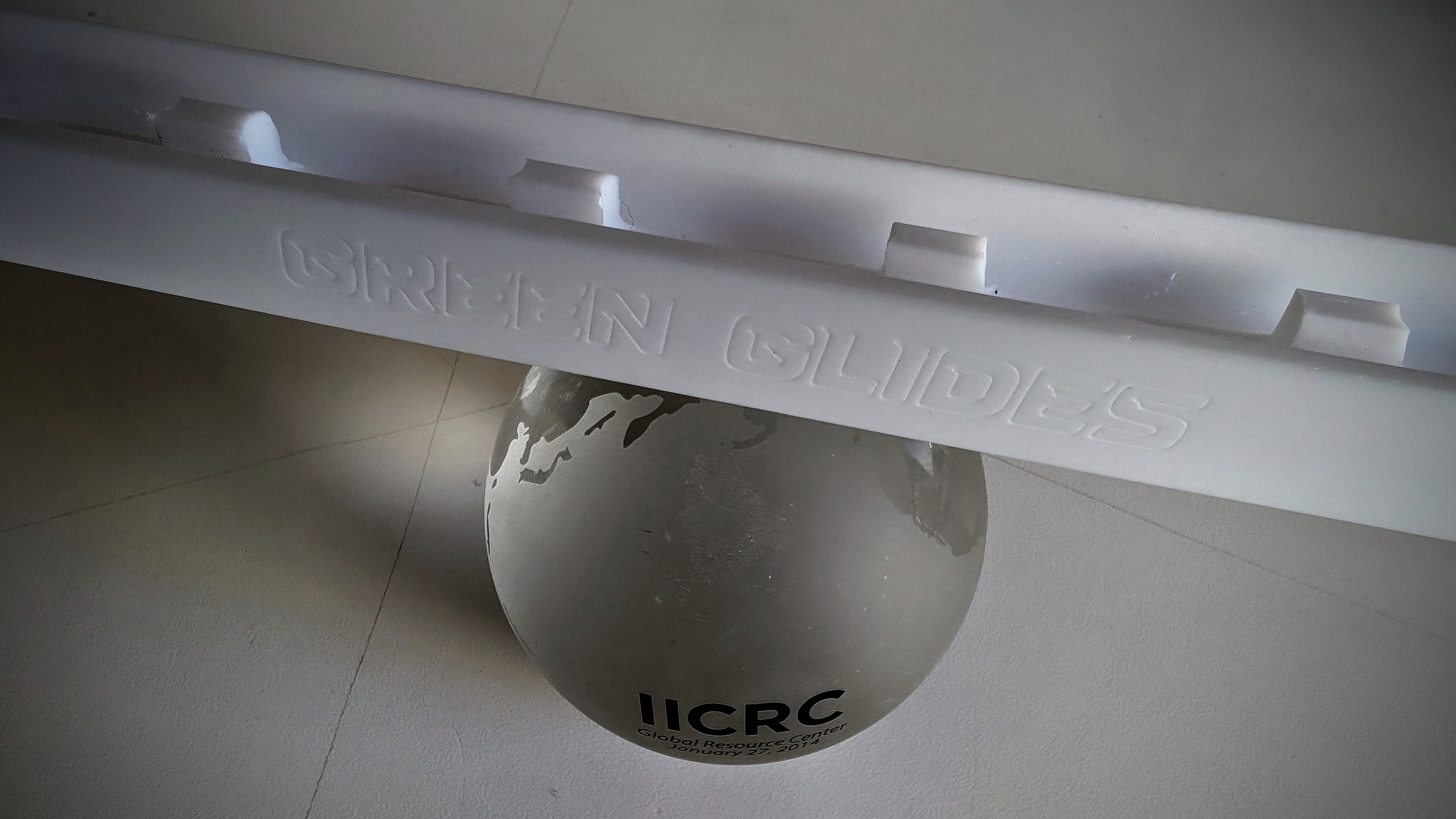

I'm kinda proud of these things...
115,981

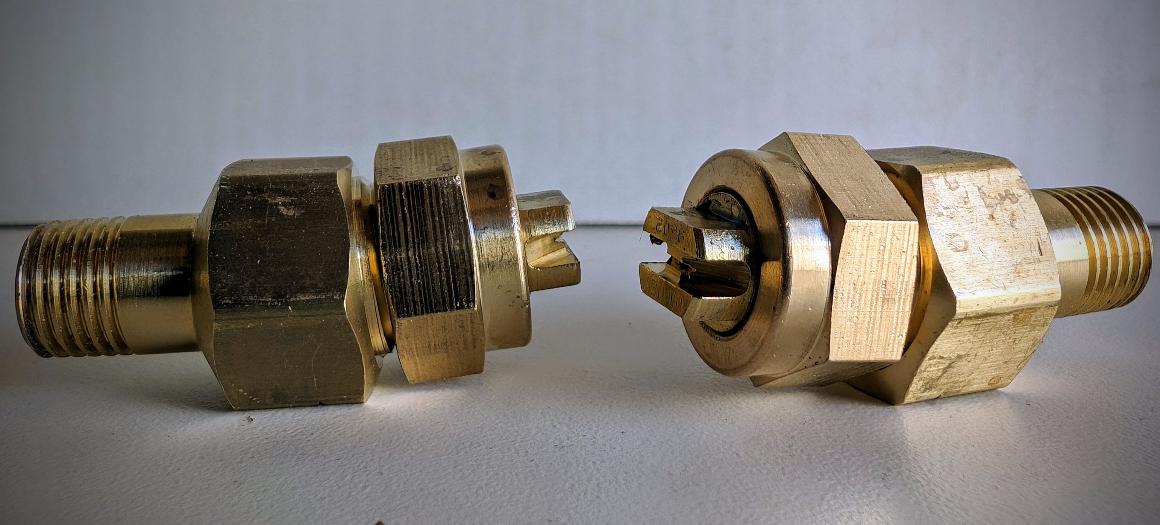

Extender Benders are selling very well these days, cleaners are figuring out that you don't need to spend $1500+ to get excellent flushing and drying performance...

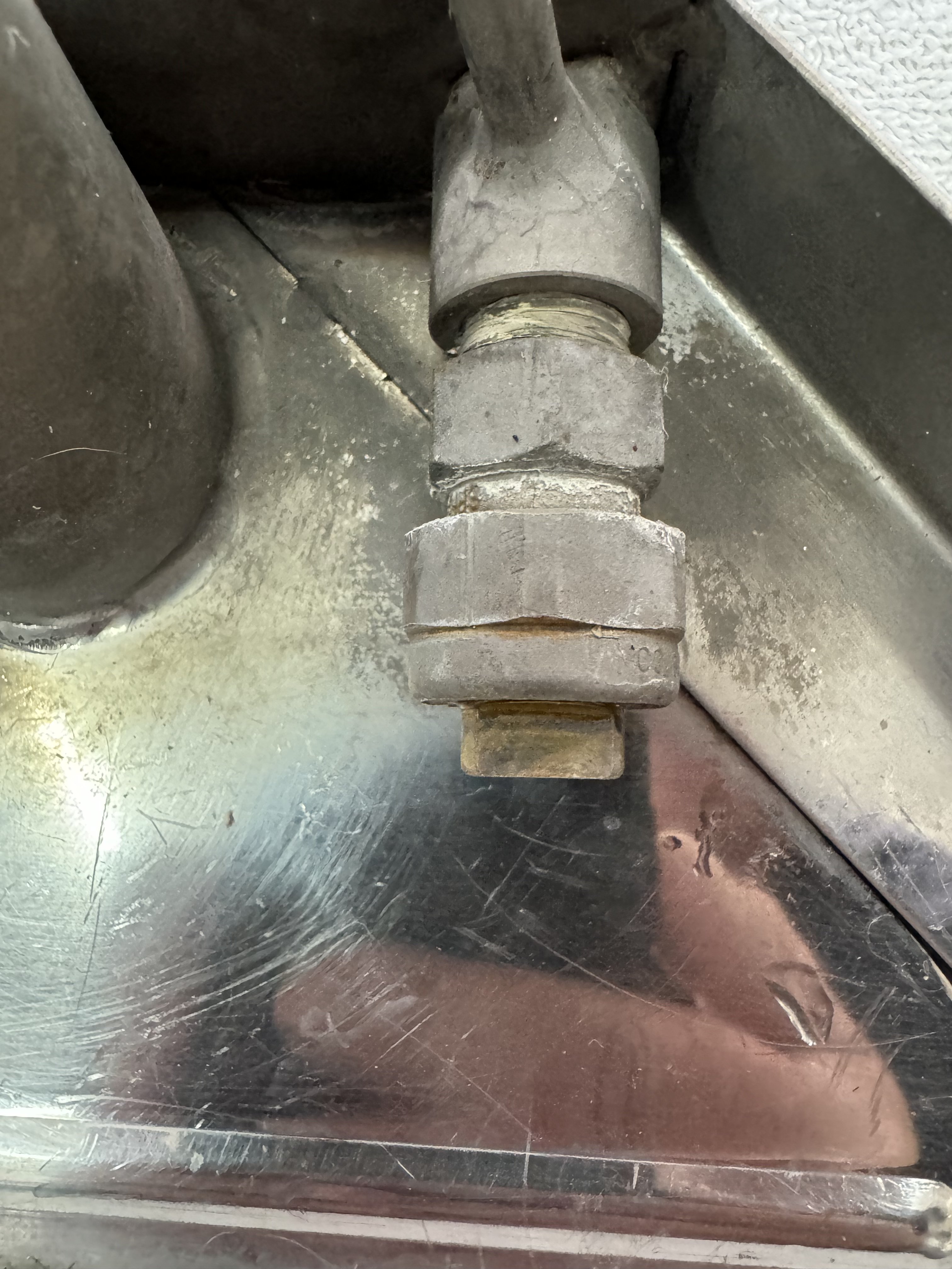

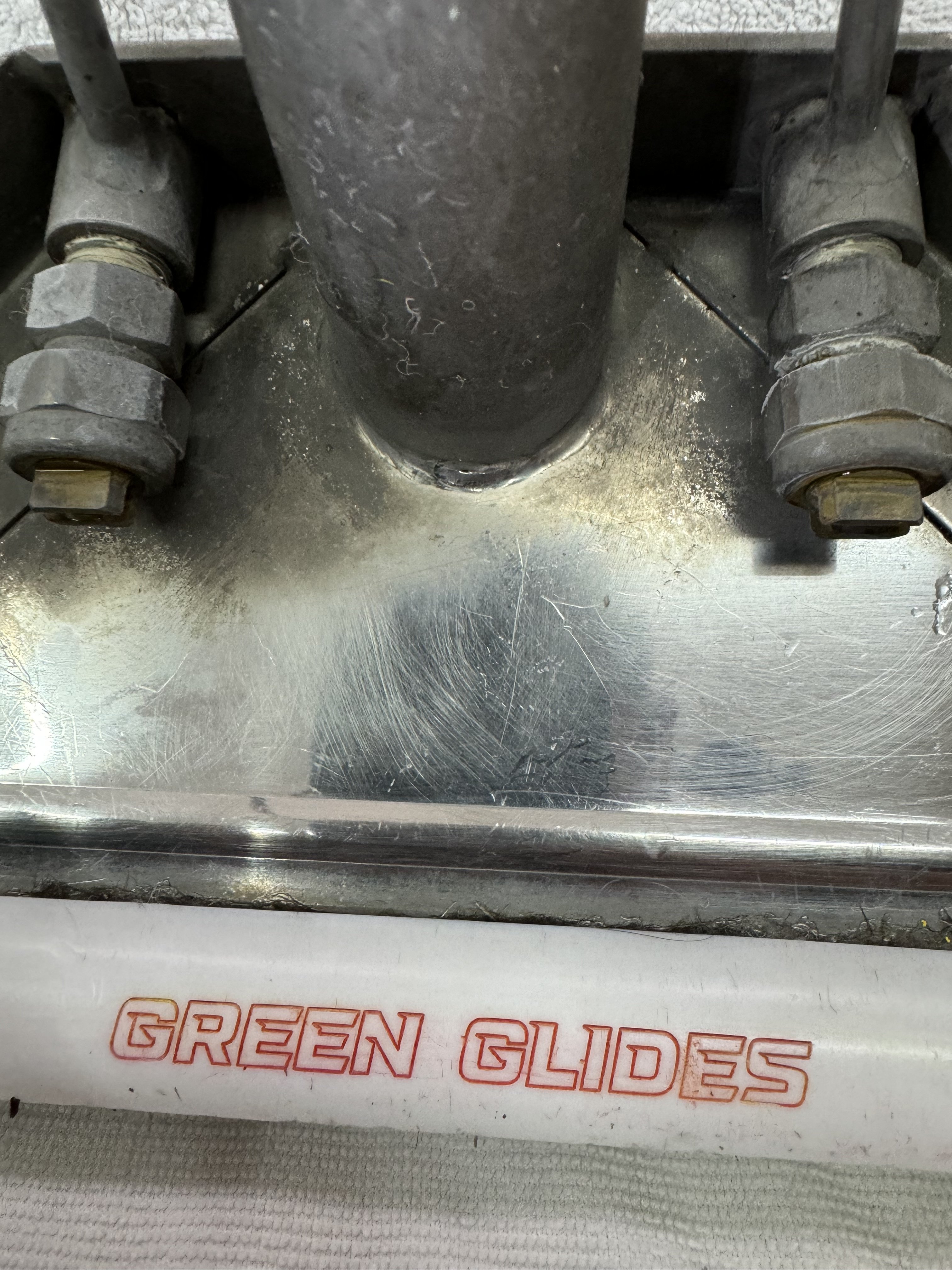

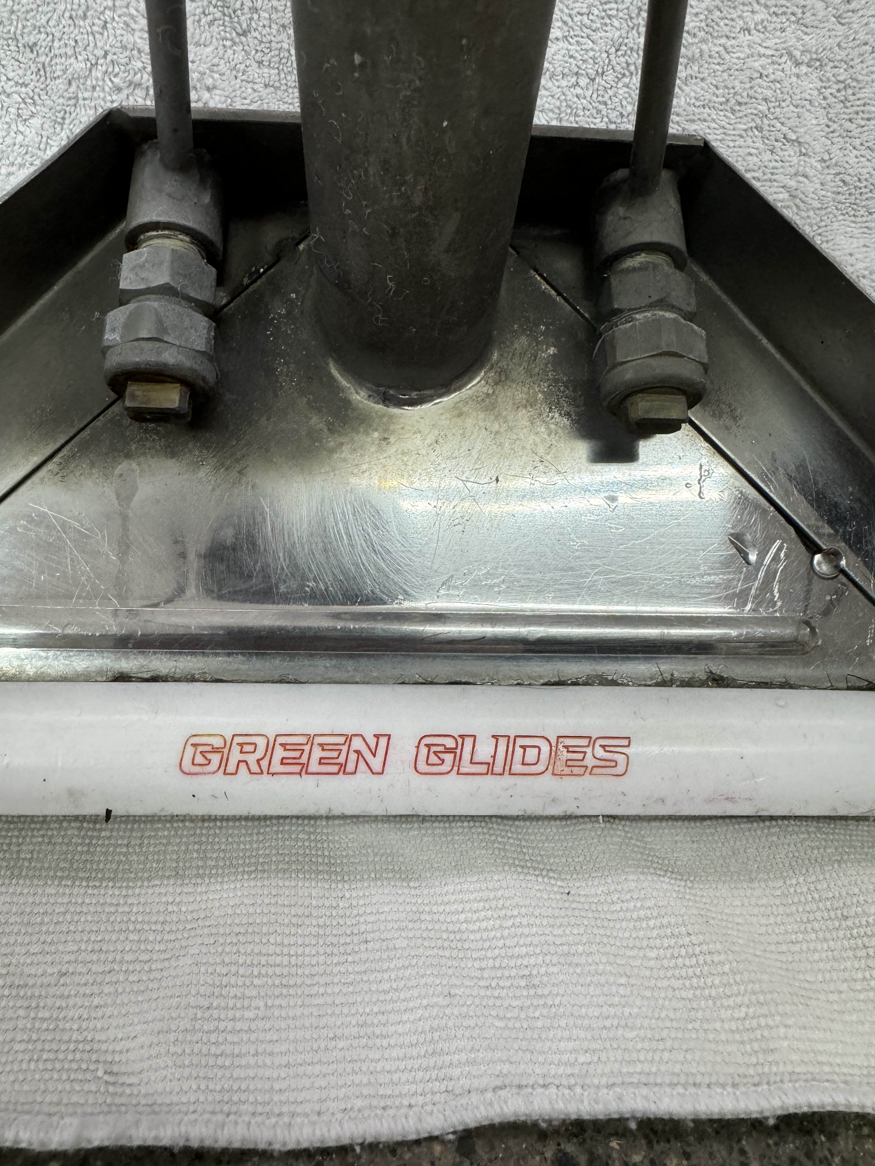

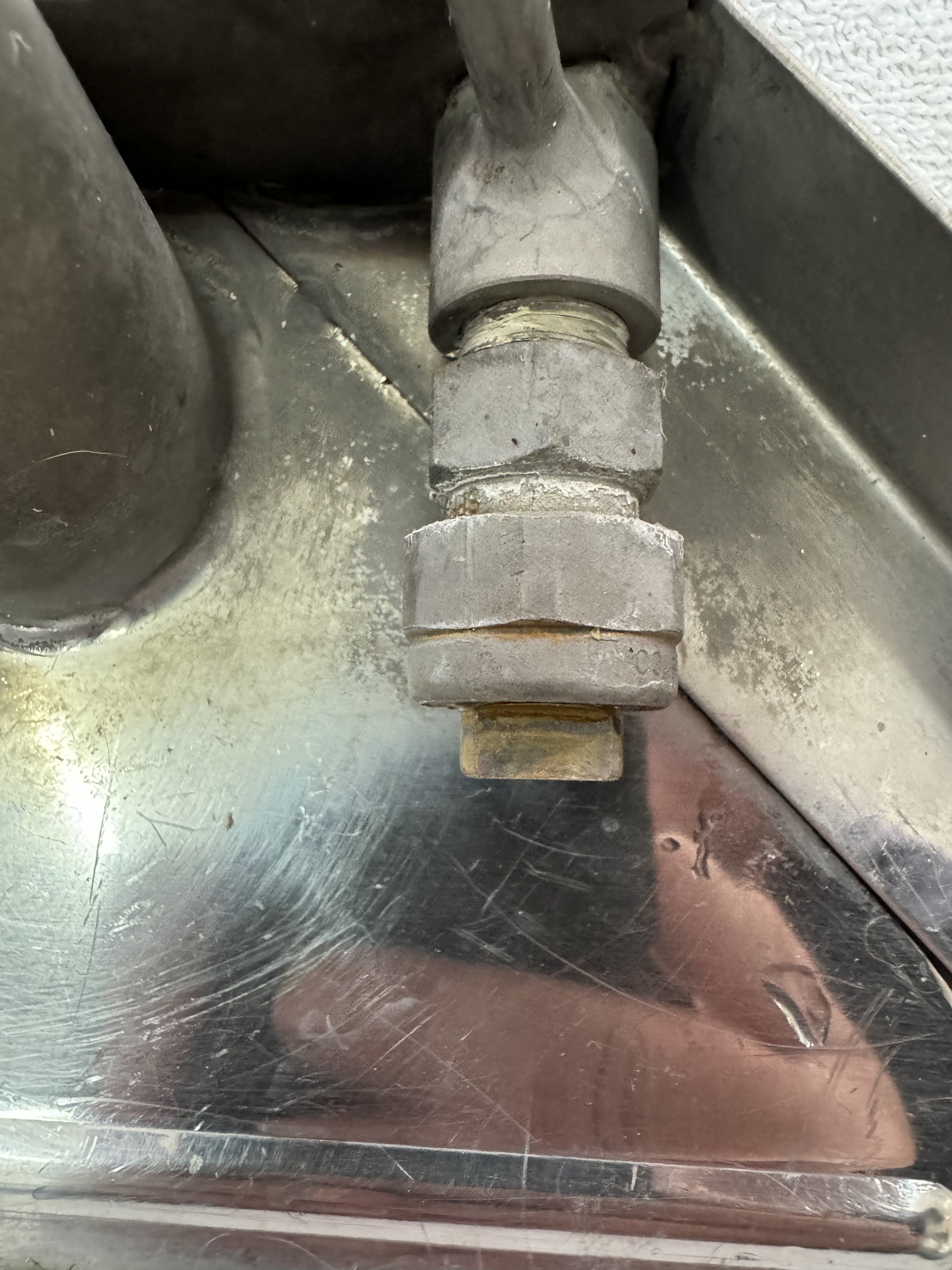

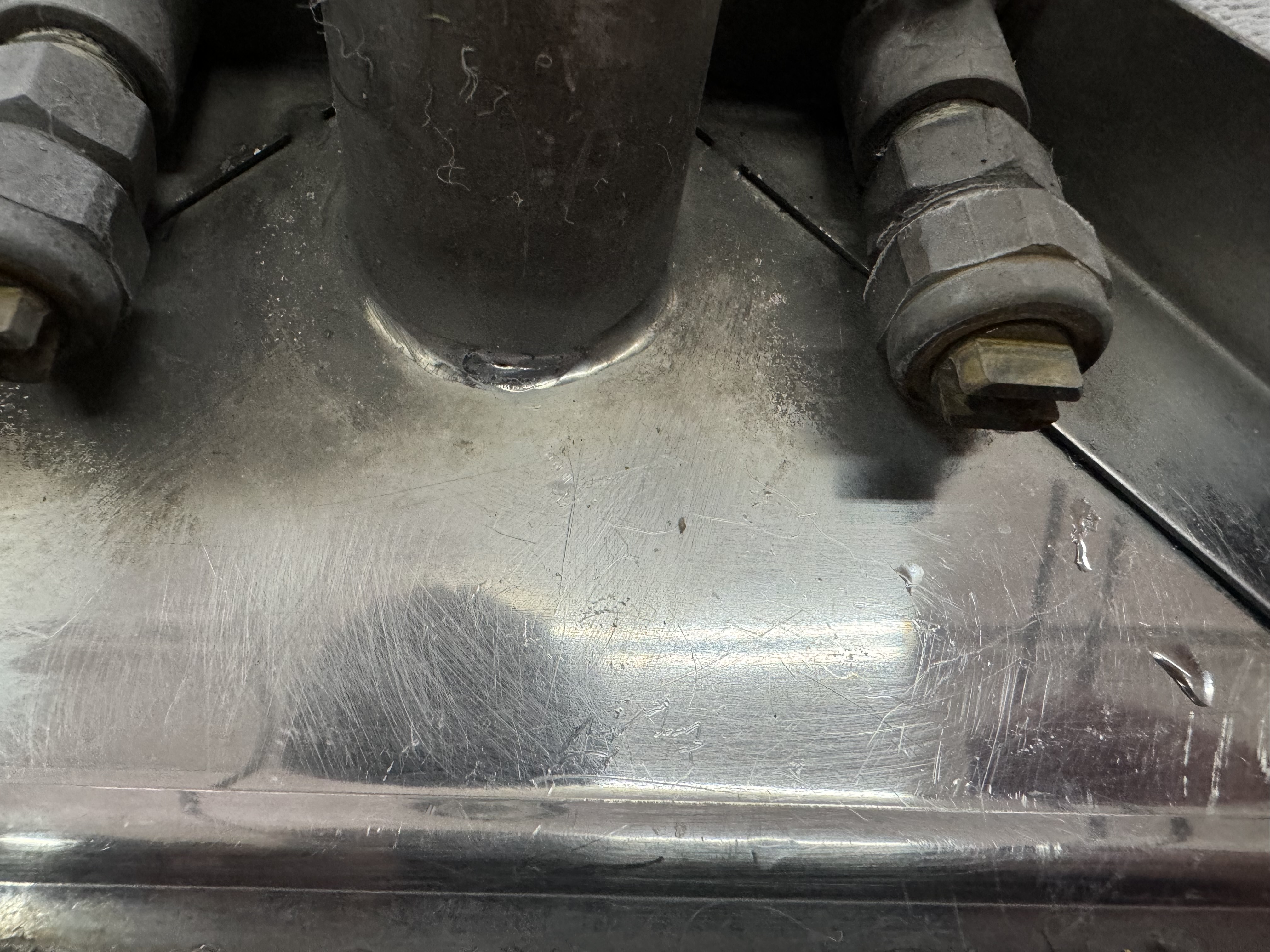

Let me see a nice clear photo of your current jet configuration on the wands in question

Ok, from the ground to normal height of holding the wand, it’s 5 1/4” off the ground to the top of the shroud.

2 slot glides, 2 sets of EB’s, and 2 sets of new stainless jets.
I’m assuming that the EB’s change the height of the jets, so…. 4 flow, and 110 angle???
Actually, one set 4flow, and one set 3 flow, the second wand for my porty…
