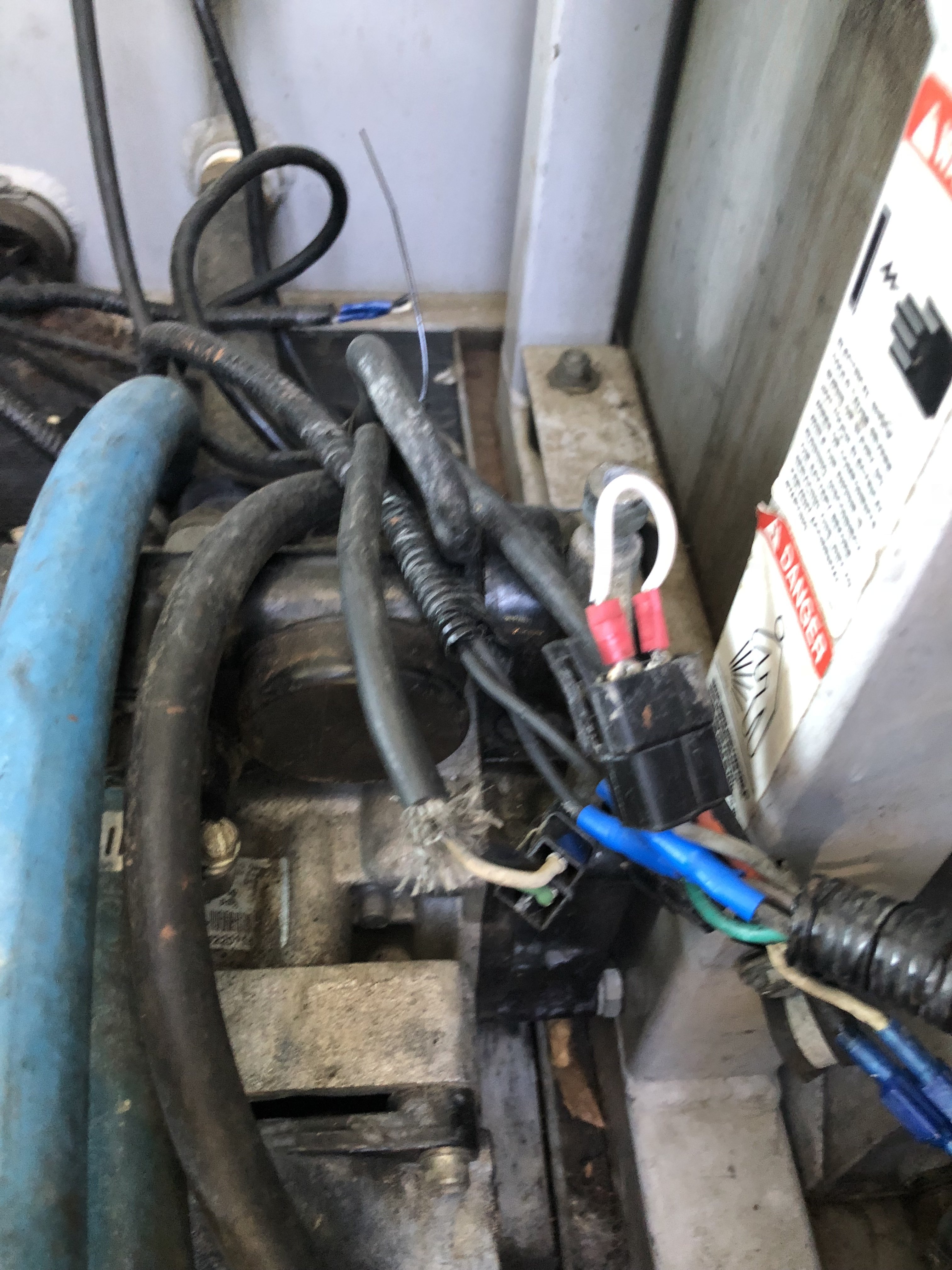

I ended up swapping trucks with Phil and trouble shooting his truck at home!
Changed fuel filter jump started it ran for 2 minutes and shut down!
I finally bypassed the shut off float switch and got it started!
Let it run 20 minutes and went and did my last job!

So happy that the loop wire helped me diagnose the bad float switch!

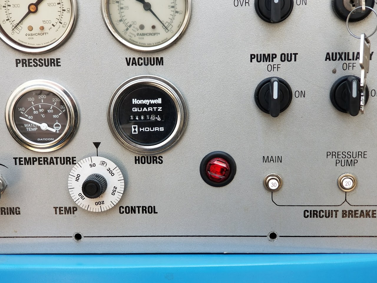

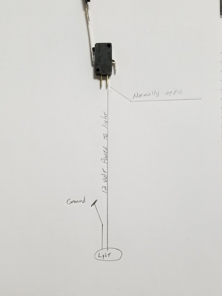

I added a light to mine...so if the tank gets full it will come on....with Jr out there using it ...it has saved me a few times....
here is how to wire one up....
Reactions: SamIam and Nomad74

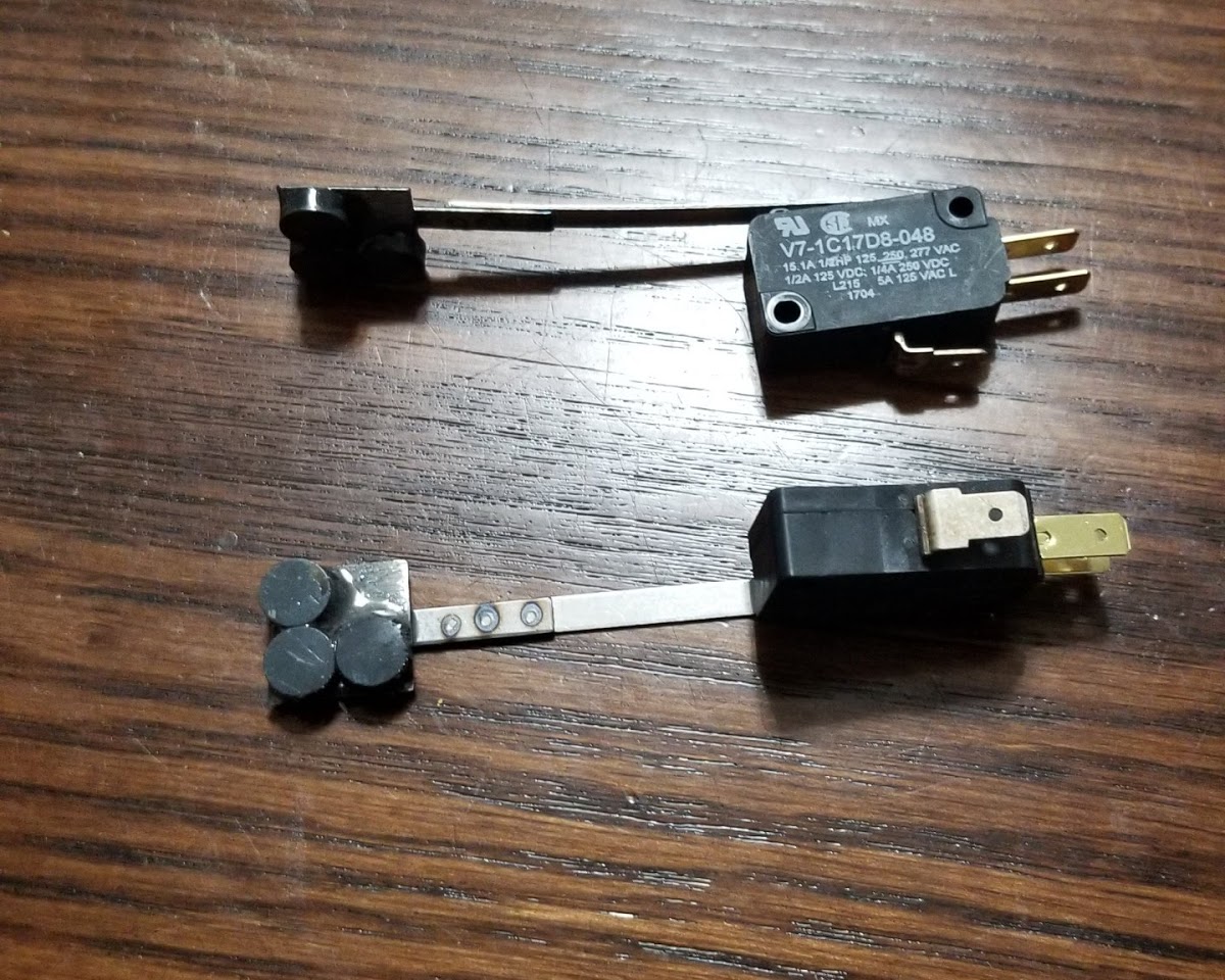

My Harwig float on my APO went out AGAIN!!!! The relay works fine when I pinch it but when i move the float up and down nothing happens. Its like the magnets just decided to stop working.
Jim Martin
Arizona
Jim Martin
if you can push the microswitch by hand and it is working....then I would check and see if either you have something stuck in the pivot of the float and it is not coming up as high as it needs to....or..the float itself is filling with water...2 good places to look before replacing the switch.....
24,041
Ill do that today.

24,041
Well, no dice :( that dang float just gave up. Guess I'm ordering a new one.
