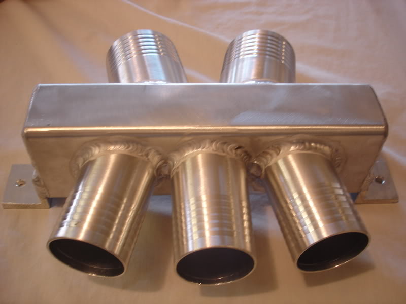

Greenie says that he is going to have some glides and other fixes for the rotovac. I’m going to purchase a high flow wand 3 inch Knuckle and the. Manifold<img src=pic's
> (2.5) and the y (2.5) from him also. . I will split the 5 inch Npt from the blower to the Greenies Manifold <img src=pic's addy > ( two 2.5 ) to two 30 gals waste tanks . Why because I’m hard headed and I have to do it my way.

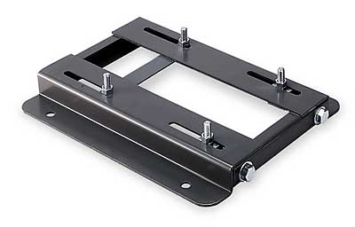

Greenie we are thinking about the following motor base
it will support 2095 lbs and this one
