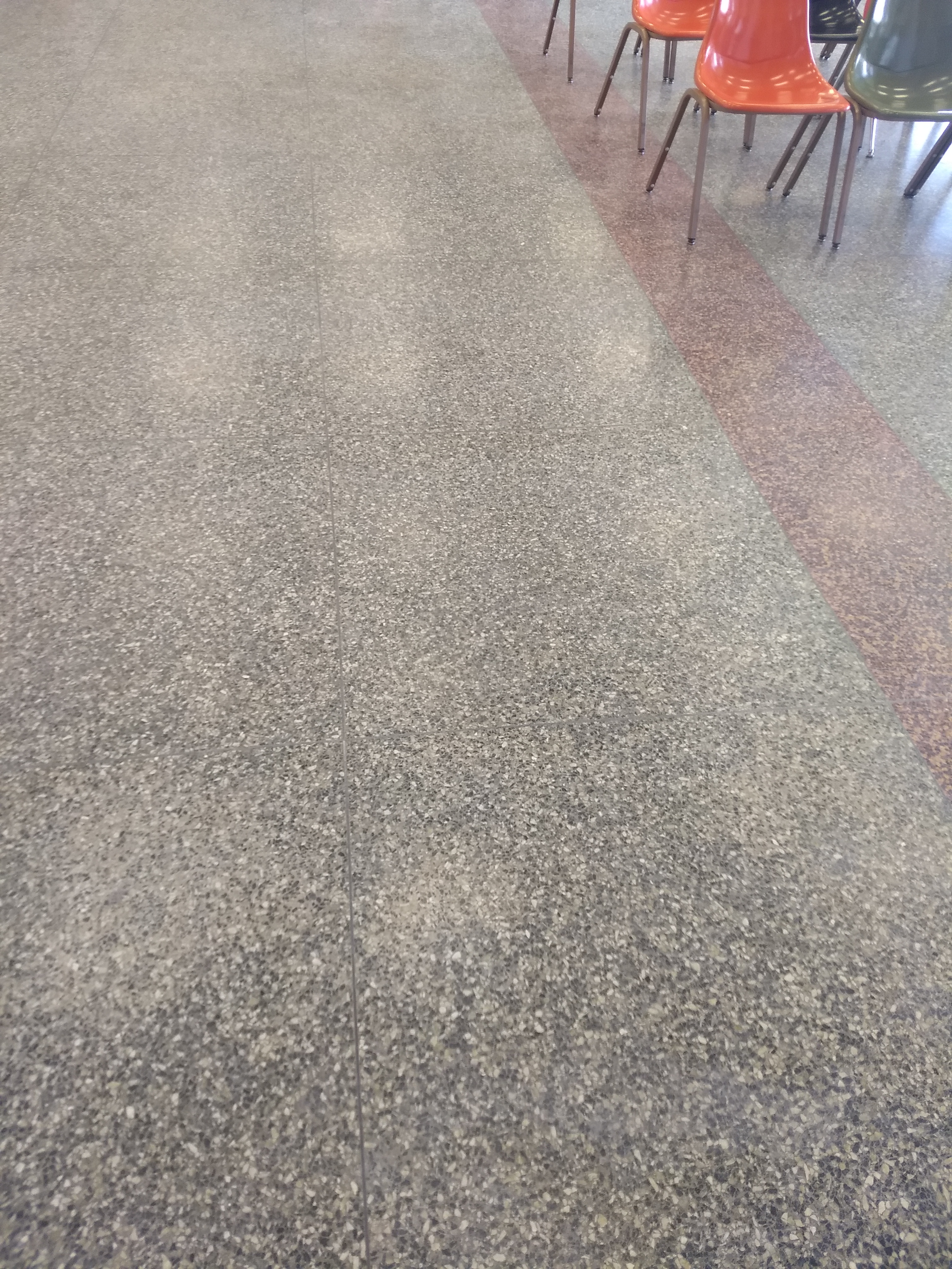

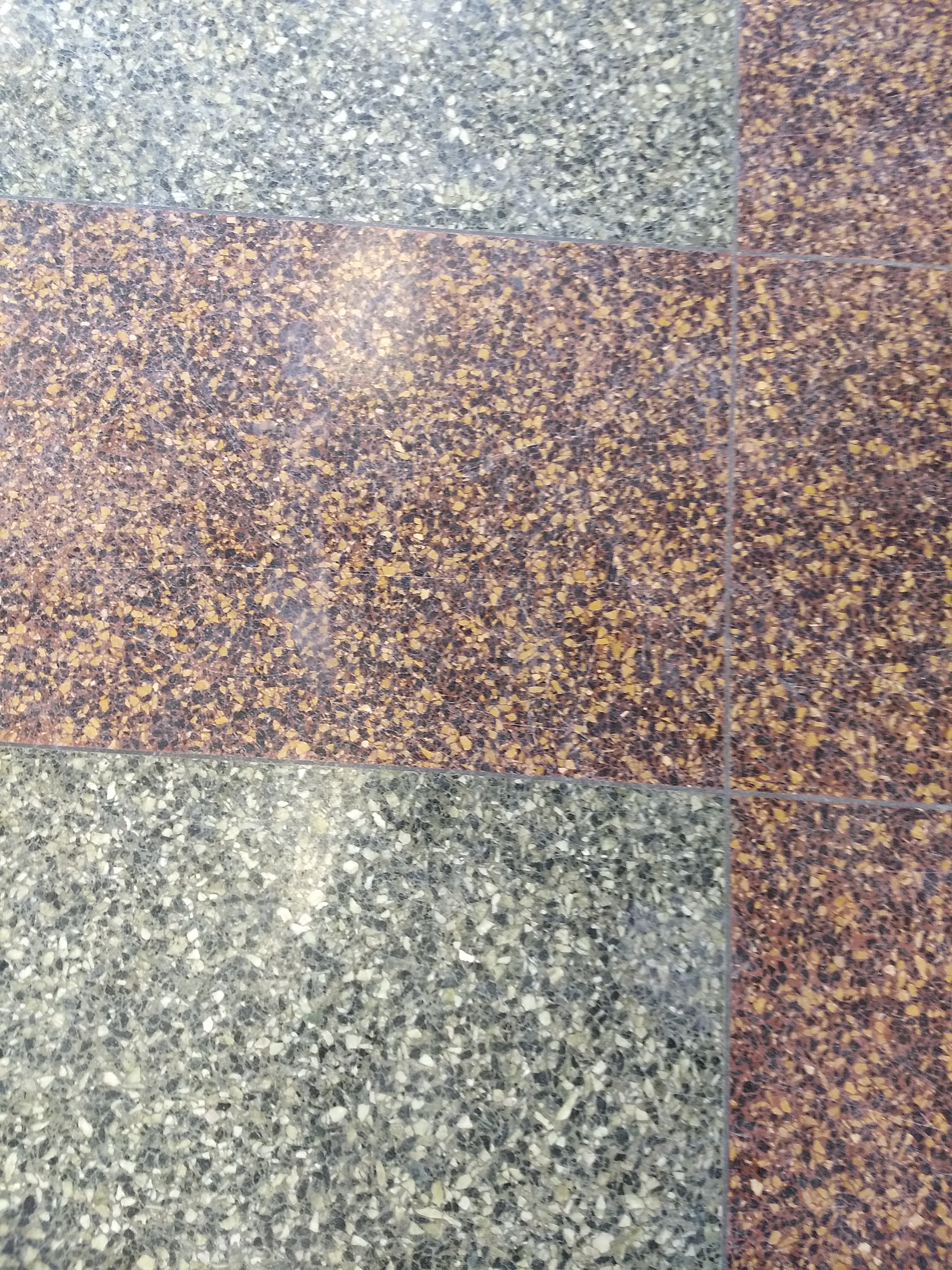

Jun 26, 2018 #1 Lyman Supportive Member Joined May 19, 2007 Messages 1,765 Location Johnstown new york Name Lyman How do I clean and or can I strip and wax?
Jun 26, 2018 #2 Mikey P Administrator Joined Oct 6, 2006 Messages 115,937 Location The High Chapperal Is it coated? Strip and wax or even better, strip and diamond polish Reactions: Kenny Hayes and J Scott W

Jun 26, 2018 #4 Lyman Supportive Member Joined May 19, 2007 Messages 1,765 Location Johnstown new york Name Lyman Built in the 60s, 8000 sg ft
Jun 27, 2018 #5 Kenny Hayes Member Joined Apr 17, 2009 Messages 9,240 Location Yukon, Oklahoma Name Kenny Hayes You can strip and refinish. Spp are great on Terrazo. My Catholic Churches have it, and that’s what I do. A lot faster than polishing.
Jun 28, 2018 #6 B Bruce Humphrey Member Joined May 12, 2007 Messages 2,519 Location Bay City, MI Name Bruce But after it's polished , wouldn't the polish hold up better then the wax? I have Terrazo that I strip and wax , wish I could polish it. Reactions: Mikey P
Jun 28, 2018 #7 Kenny Hayes Member Joined Apr 17, 2009 Messages 9,240 Location Yukon, Oklahoma Name Kenny Hayes You have to maintain both. The reason I put finish on most of mine is time frame to turn it around. Reactions: Bruce Humphrey and Mikey P
