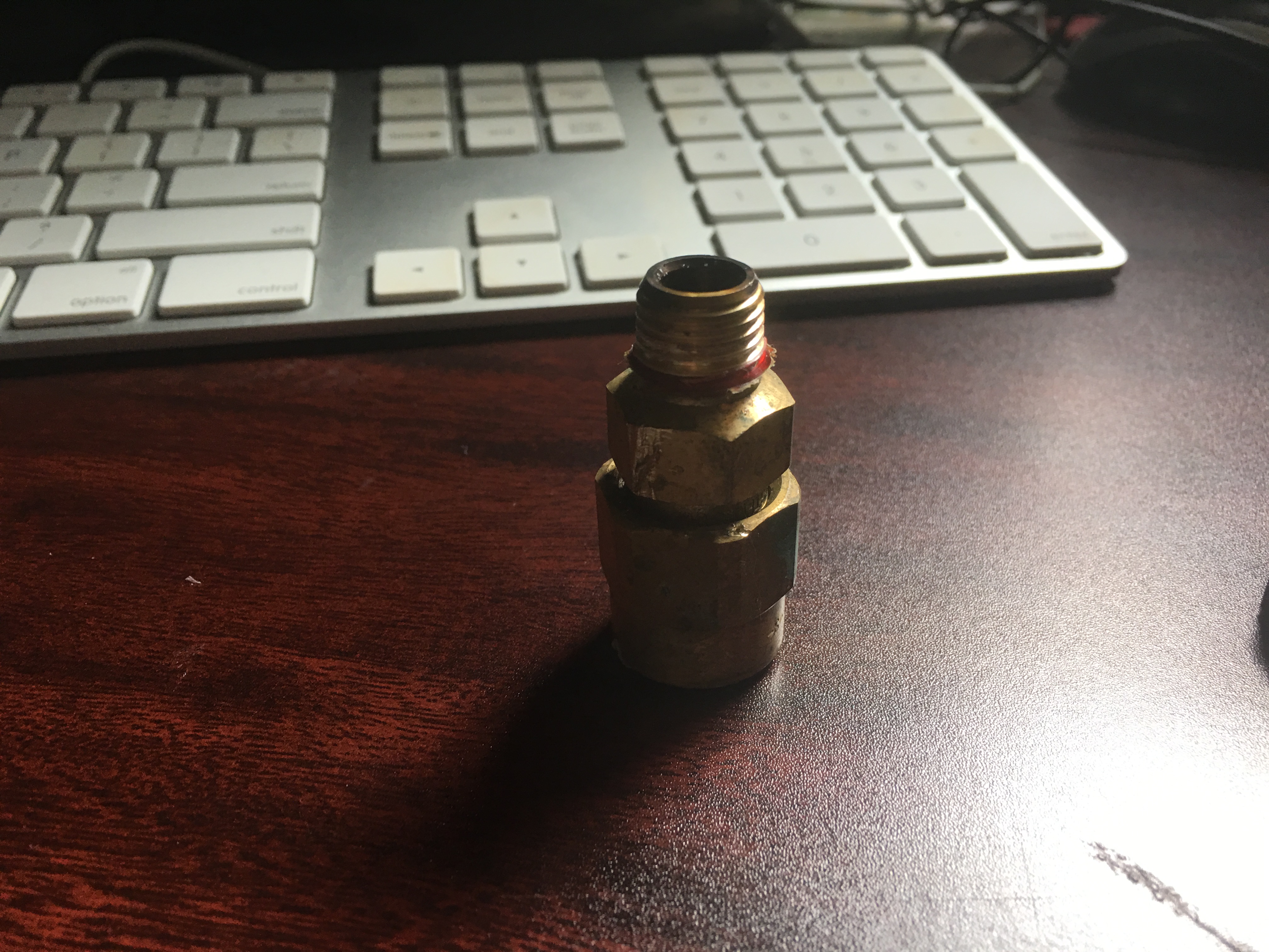

@scottw and whoever makes the one with the coin shaped dial. I'm tired of having to fix the o-rings on the dial, and the HF is always getting out of wack with the spring getting wore out inside. These $200+ sprayers are junk! Even the cheapo ones that are preset at 9:1 are always going bad also. And who put the RED thread lock on the QC on the one with the dial? freaking idiots! Just use thread tape so we can take these things off when needed. I have about ten of these in my shed that I'm using for parts when the new ones break down. Yes, I'm rinsing them out and I'm not using them when my water is scalding hot. Try another excuse

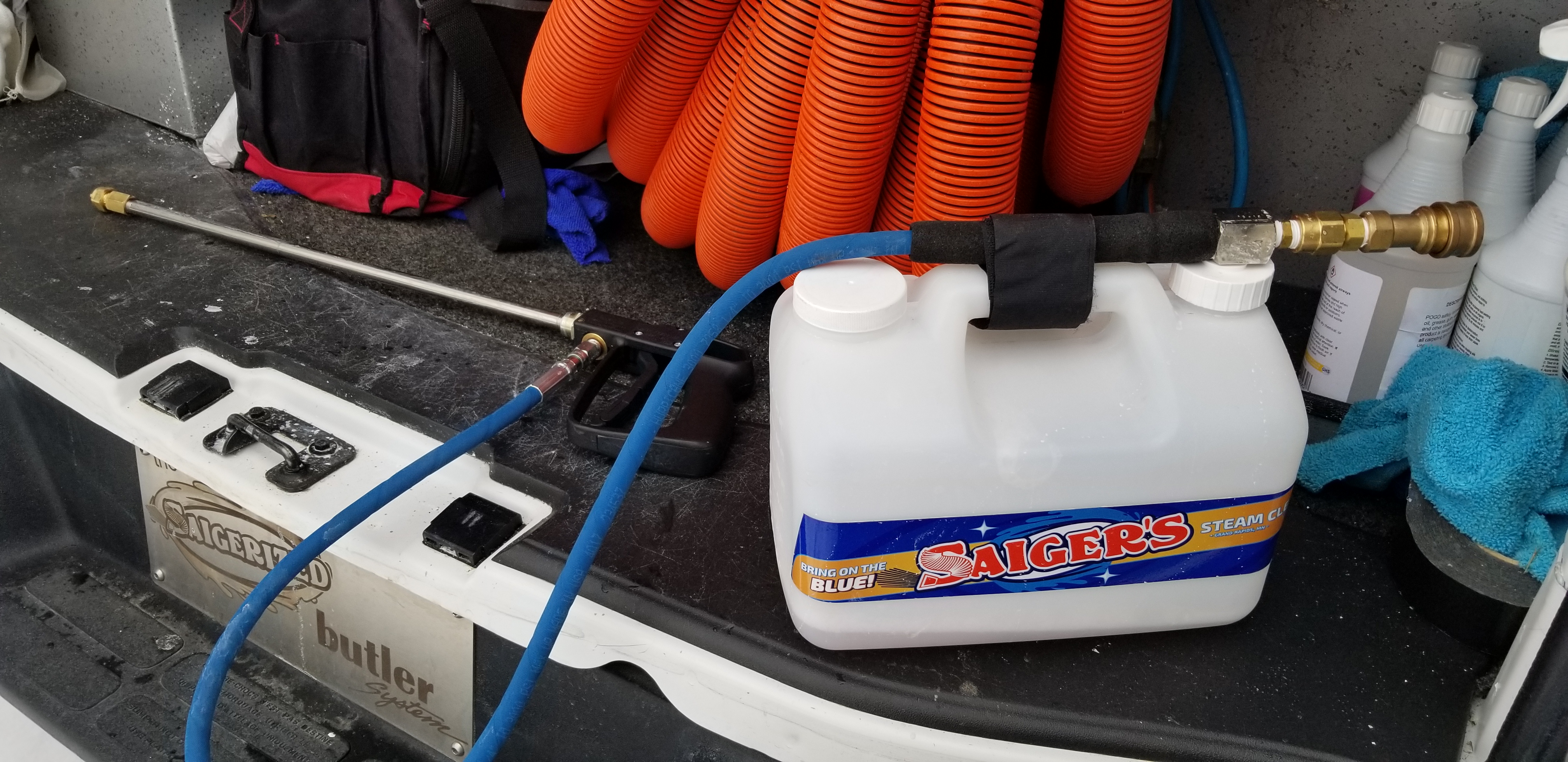

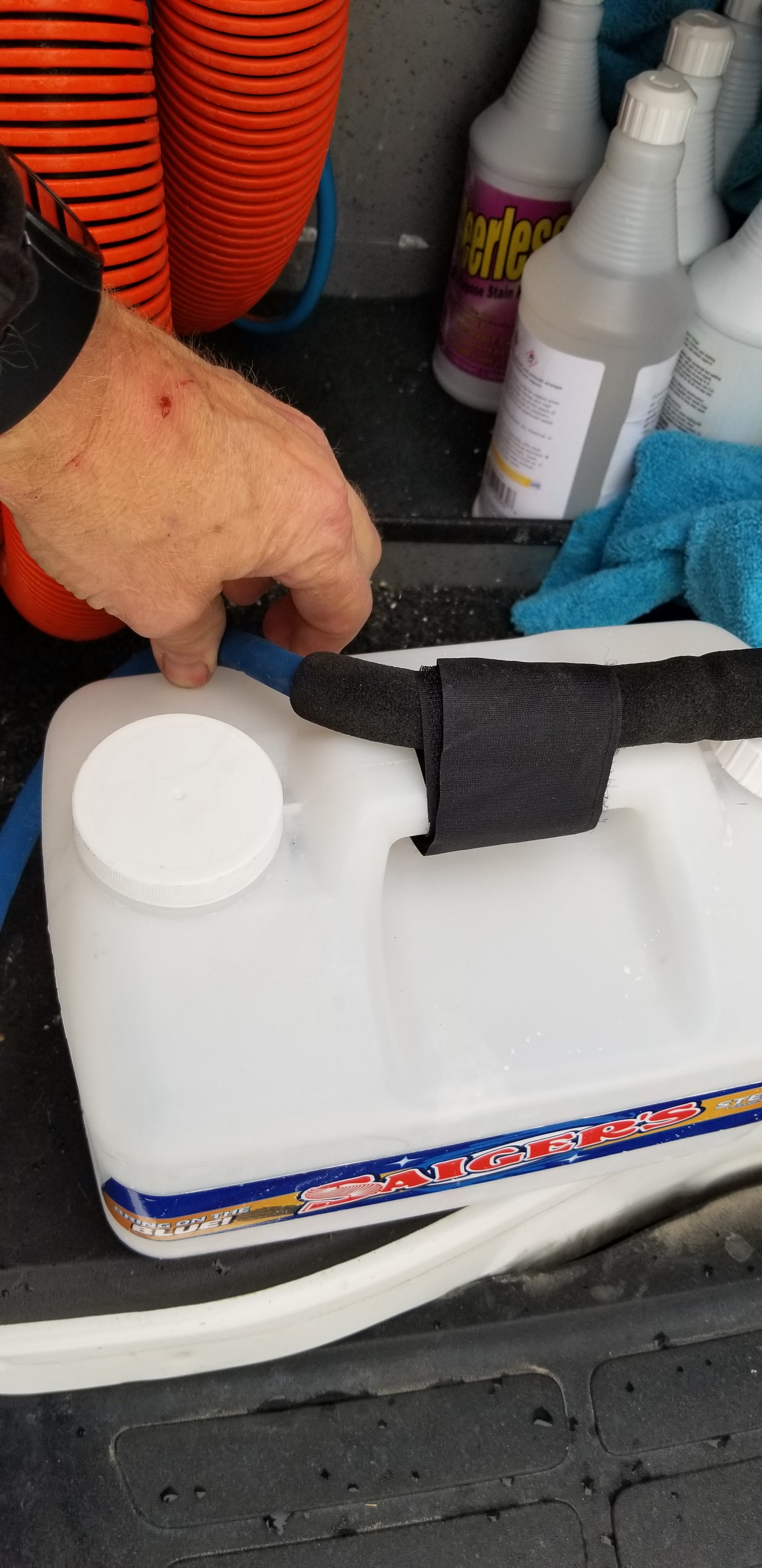

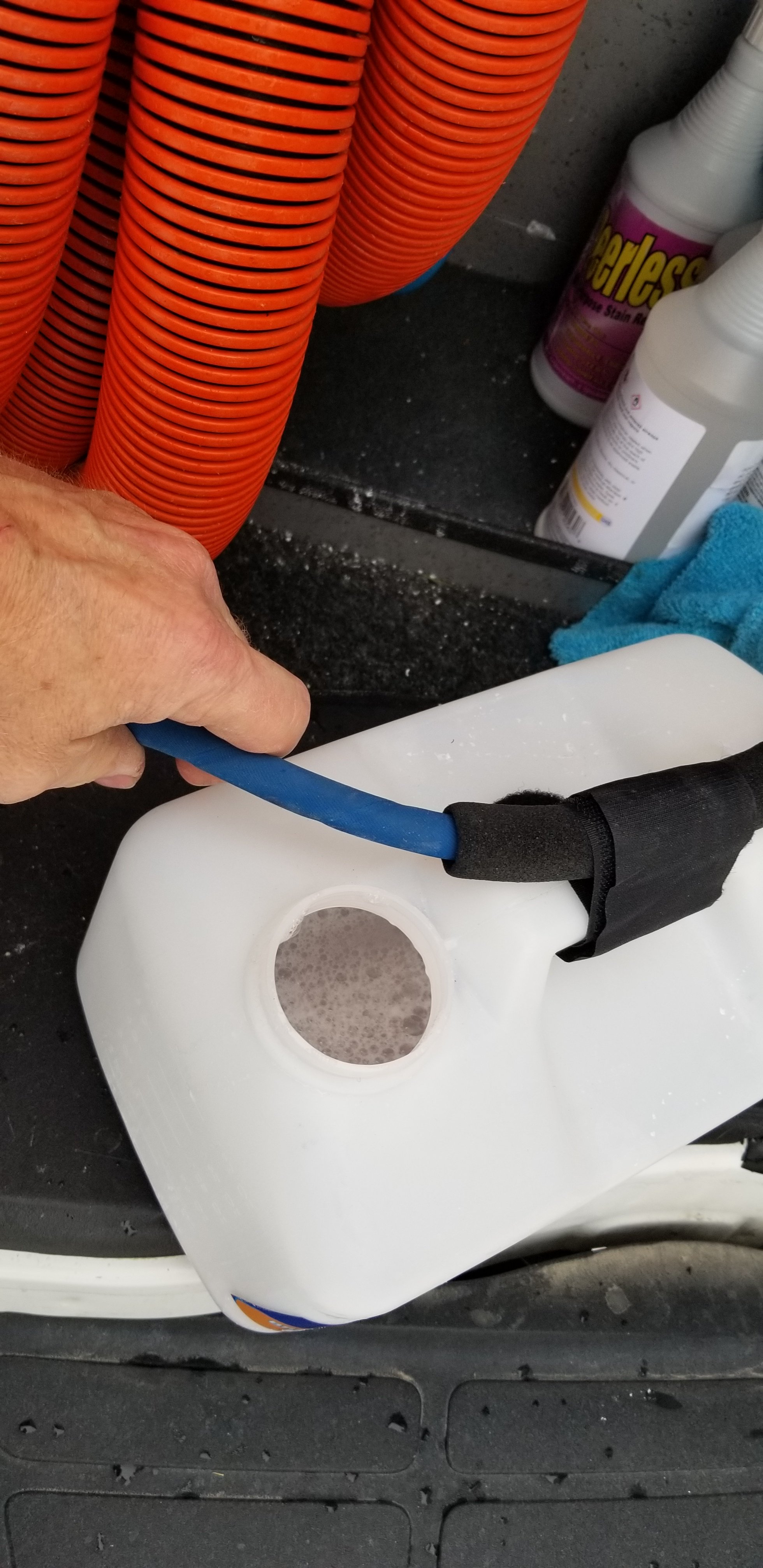

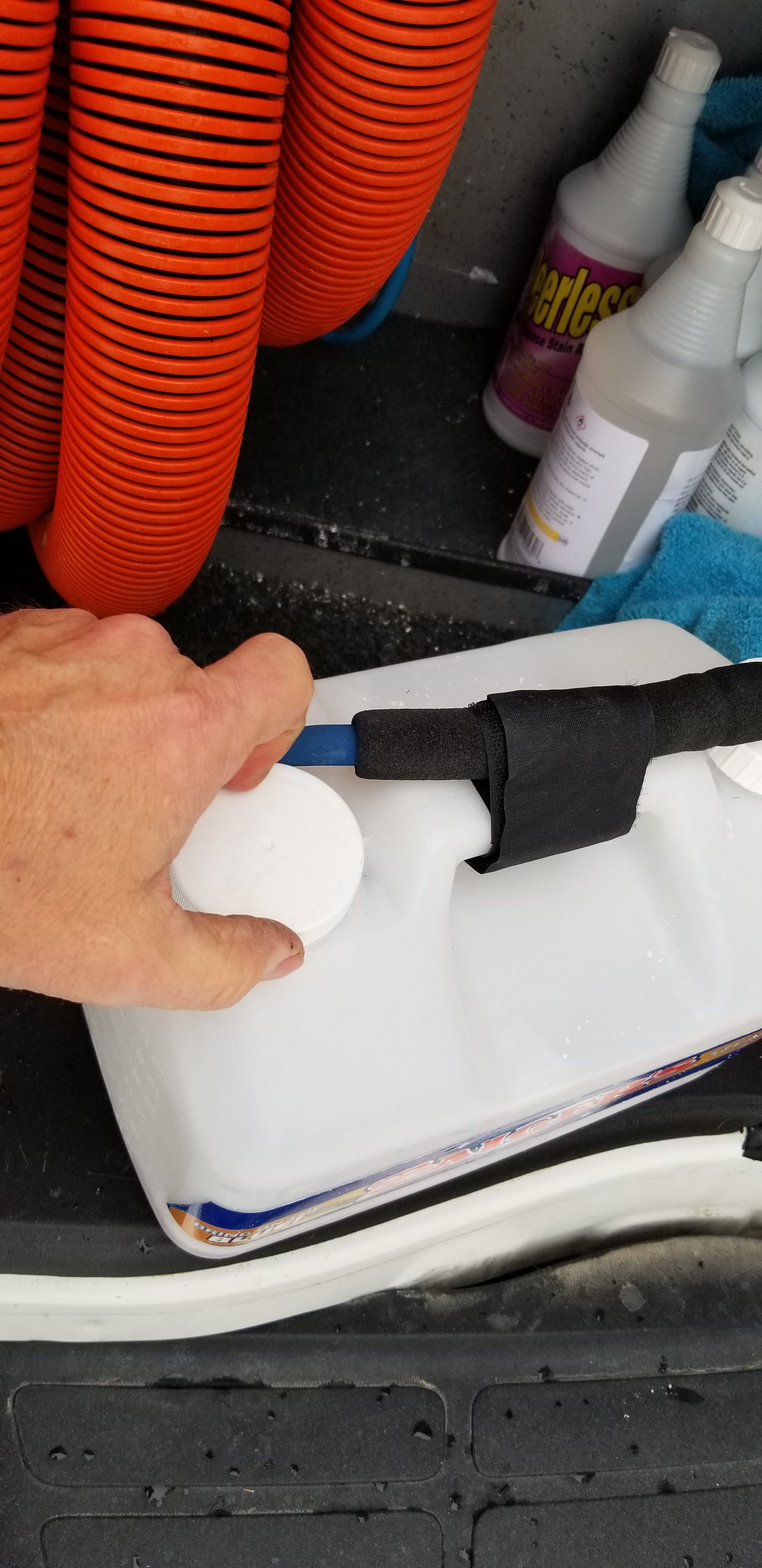

Take Jimmy's advice, carry a small pail with a mark at the 1 gallon line, a mixing stick and a funnel. Mix your powder in the pail and pour into the hydro-force.
Mark Saiger
Mr Happy!
Dec 26, 2006
11,199
Grand Rapids, MN
Mark Saiger

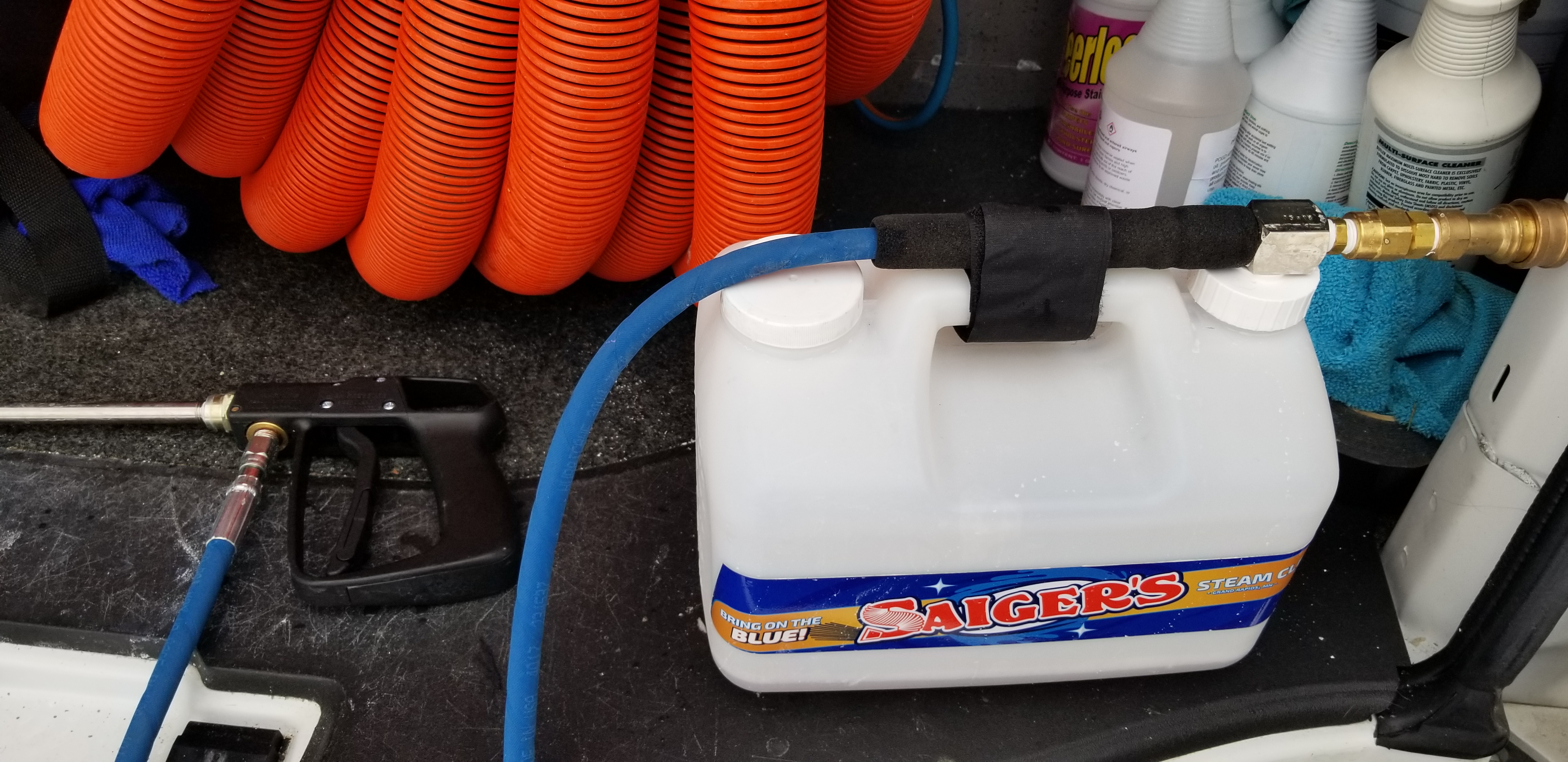

Multi sprayer brand.
Don't get the adjustable version.
Get the one with the yellow Tip in it and take that out.
Get an extra Dema valve and keep in the truck. When it goes bad you will be ready... Then order another Dema valve to have in your truck repair kit (like about every three years)
JonDon has the Multi Sprayer private labeled as Powerforce II
I am now using their new six quart version. Not sure if JonDon has on their website but a cool new feature taking out the hard inline brass tube.
Keep in mind there is a filter coming into the Multi Sprayer brand high pressure sprayer and also another filter at the end of the wand by the jet.
https://www.jondon.com/powerforce-ii-sprayer-250-1-000-psi.html
20181108_131949.jpg 20181108_131942.jpg 20181108_131938.jpg 20181108_131926.jpg 20181108_132009.jpg
Looks like it's exactly the same dema valve as the hydro-force. I leave the yellow tip in for my liquids but remove it for my powders. I adjust the dilution ratio accordingly.
I'll have to check mine to make sure it's not made in china or something. So far, they have been very reliable. I usually keep 2 on the truck and for large jobs, extra jugs I can just swap out. Fastest way to get a good prespray down. 4-1 for code Red, 8-1 for procyon extreme.
