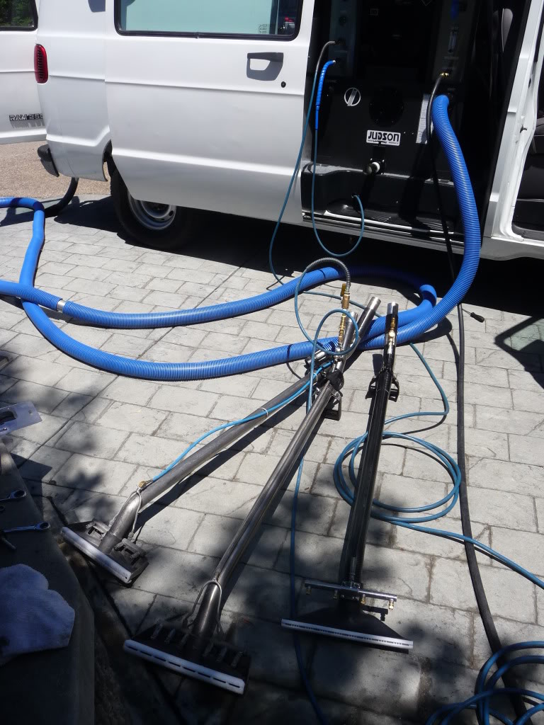

Hey Mike....how about some pictures of the lay out inside that van....??
