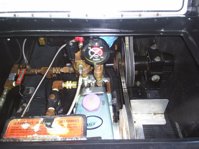

So I was cleaning today and I changed over to cleaning tile after finishing up the carpet. I turned my last step chem pump on my CDS off and bumped the pressure up to about 900 psi. I cleaned as usual but when I came out I noticed that my truck was dripping on one side of my van and made a decent sized puddle. I also noticed that my solution tank was empty which was about 3/4 full when I turned the pump off. So I finished the job and went home worried I had a leak of some sort. When I got home I pulled the cover off my machine between the seats and turned the machine on looking for the leak. I found the bottom of the chem pump dripping. I have between 1200 & 1300 hours on my machine.
I am guessing I need a new chem pump, but I am not sure if I'm going to have to need to do any work on the cat pump in addition. Based on what I'm supposed to do from you experts I'll order what I need tomorrow to fix it.

the chem pumps are only good for about 700 psi....with the CDS you are not really turning off the pump you are just turning off the flow ...so when you switched over to do the tile it finally let loose.......these pumps need to be more isolated with a shut off valve before the pump to kill the pressure.........on the CDS it is tight fit and may be hard to do.....you can rebuild these pumps pretty easy and much cheaper then replacing them....the hours finally got to it..........

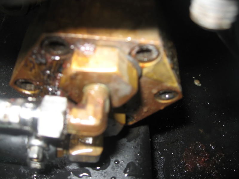

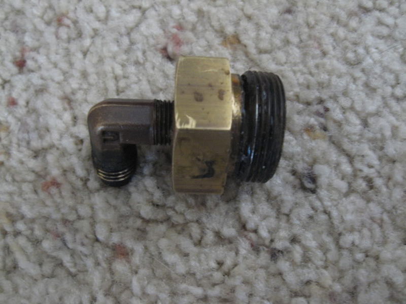

Ok I replaced the diaphragm and that wasn't the problem. I didn't see a problem with the one in it but I changed it anyway. I tightened everything back up and tried it out. I filled the solution tank with water and it gushed water everywhere from the top right of the chem pump. There is a small rubber ring that connects one of the two lines that feed solution or whatever they do. I think it has been pushed out and has sprung a leak I'm going to try and pull that off if I can and see if I can get it to seat properly for now.

FCC said:
looks like its just a hex reducer ....shouldn't be hard to find
I've checked the local hardware and local small engine place and nothing. The thread is finer than standard plumbing.

I tried Ace. Remember I live in the woods so finding crap is next to impossible and I don't want to drive 2 hours total when I can just have it shipped to me.

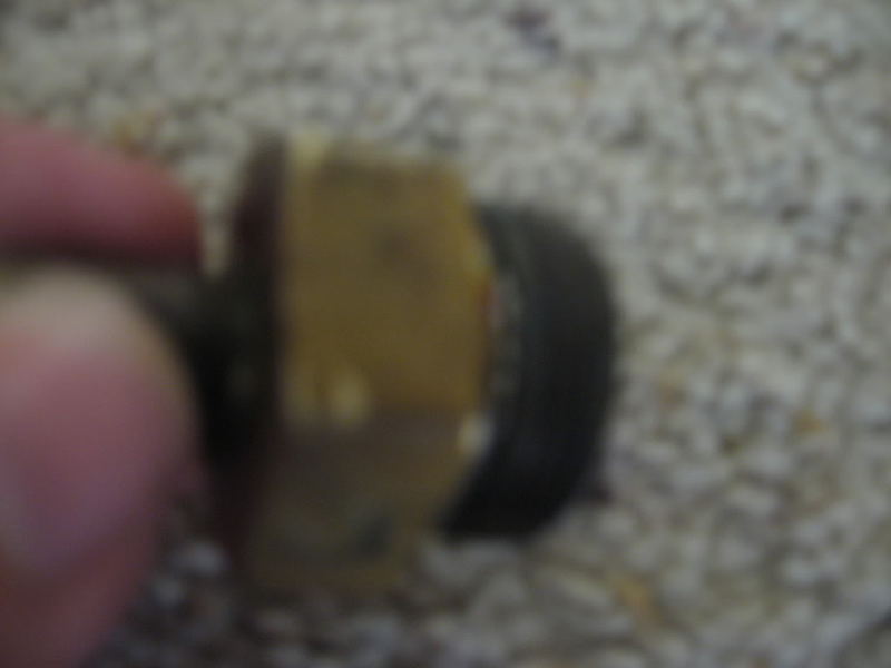

Here is a better picture for the Macro A-hole.

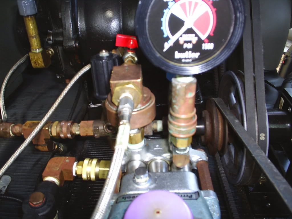

post me a picture of the pump itself so I can see exactly which one you have....If it is the same one as a few old ones I have laying around I will pull the fitting and send it to you.......I also noticed in the picture there is no O-ring on the fitting.....did you take it off and forget to put it back on when you put it all together..............

I took the o-ring off for the picture. I was going to try to reseat it then replace the ring but I found that the fitting was cracked. I've got the fitting on order and I should have it tomorrow. It would be too much trouble and costly for you to send me one. I appreciate the help Jim. Anyways I should have the machine ready for next week.
