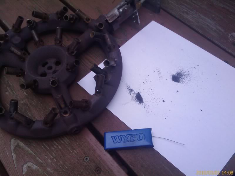

Finally got the burner out of my LG.
One jet was almost plugged, the rest were quite closed off and took a bit of cleaning out.
BOY did I notice the difference when I fired it up. Much larger flame, more heat, faster start.
I changed the heat sender for my temp guage as well. She went right up to boiling and right past it when I cranked it.
It's going to be like a new TM!!
All that black crap came from inside the burner after I cleaned the jets.
Thanks Les for the help. Came off really quick once I
One, bought a big enough wrench to fit the swivel, and
Two, cut the hole big enough for the burner ring to slide out

I've 800hrs on this unit plus some playing time in SC at Les' place.
I don't know about any schedule but I'm going to pull it once a year. I could hear the difference so now I know what to listen for, and I could feel the diff in heat.
As for ease of maintenance, now that I've done it once it'll be a breeze. They happened to make the 4HT with too small a hole to pull the burner ring out so it required some surgery. NBD
I wouldn't have wanted to clean those jets in place; too darn awkward. It was nice to have the ring out, sit at a table and file out the holes under good day light.
