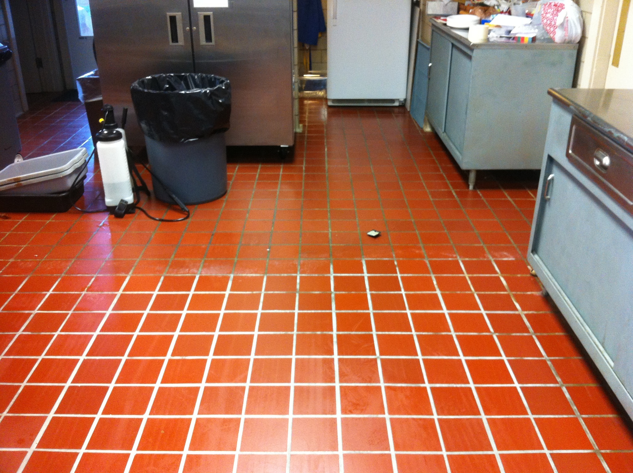

As we know there is no magic bullet, (but I’m always looking for options) so with me sharing I’m not complaining. Viper venom, Prochem (alkaline), Procyon hard surface, 2790, flex w citrus, oxi blaster... I think best results have been when I boost w/ 27% vol peroxide
115,963
IMO High pH Presprays like Enzall, Flex, Blitz, Code Red, Citra Solve etc all work just killer on grout, especially when you boost with Oxy Clean or 40 vol and some LIQUID D'limoline.
and scrub the damn grout.
Listening to dickheads like Rob who say they've created an all in one powder that does not need boosted will earn you a permanent Goober Title.
But keep in mind, a clean like you Joe, should not be seeing many floors that need boosting, imo.
