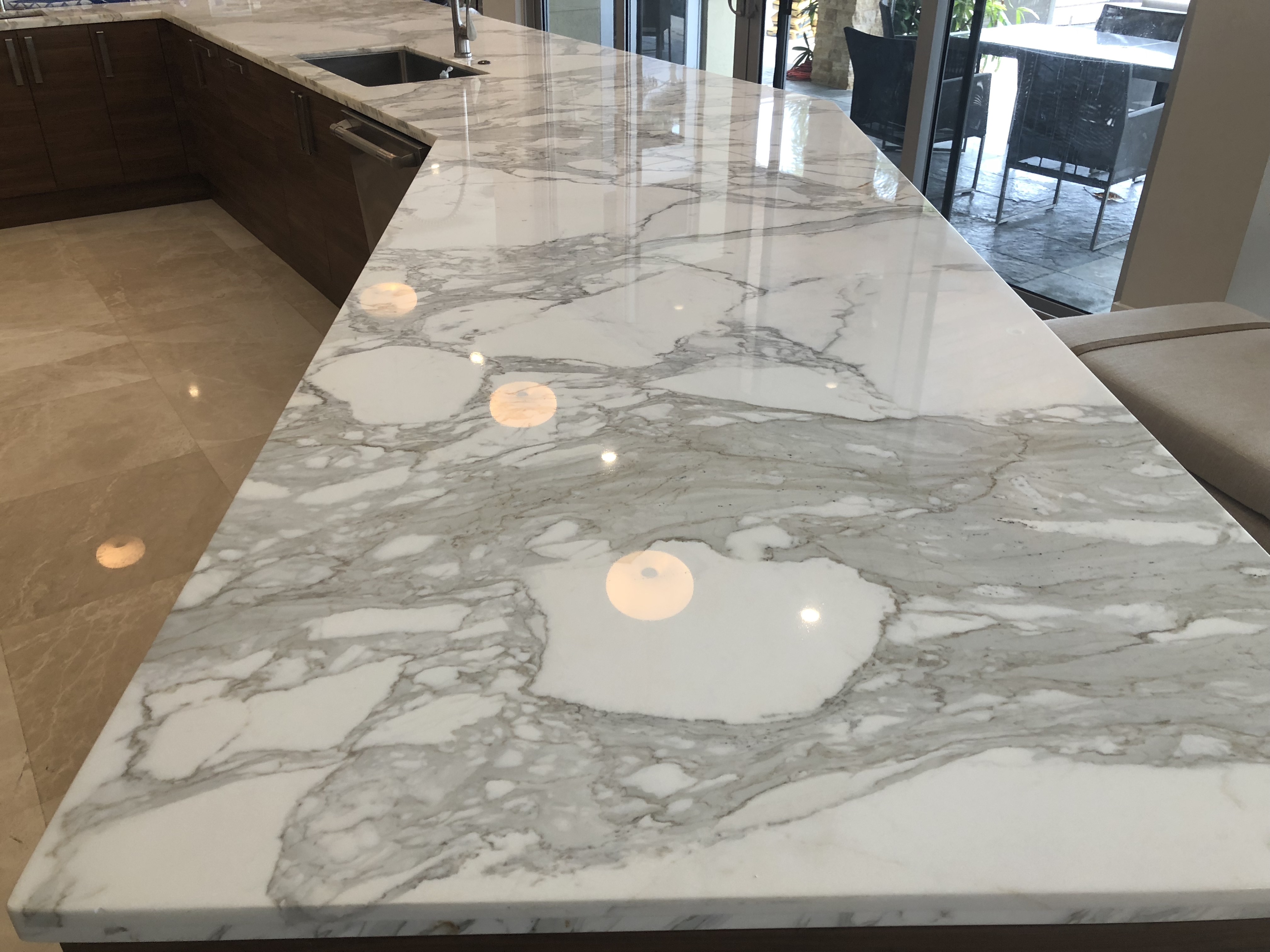

with the proper tools you will love it. Here is an example of resins and powder on marble bath counter..
Big DAN
Sep 5, 2018
2
O-Town
Doug Nelson
Agree with Sincity870 100%. Resins and powder (True 5X powder). That's what we teach
