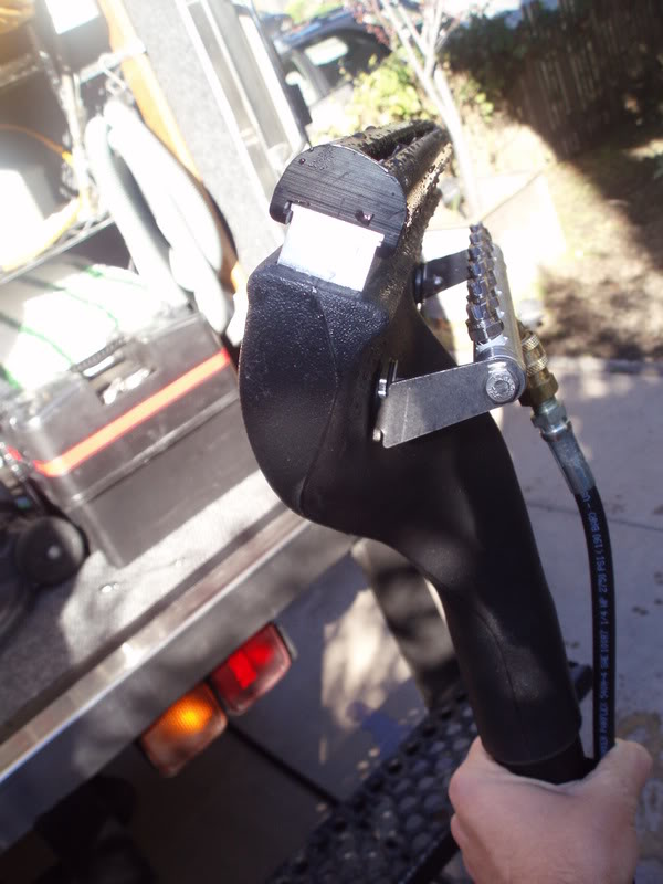

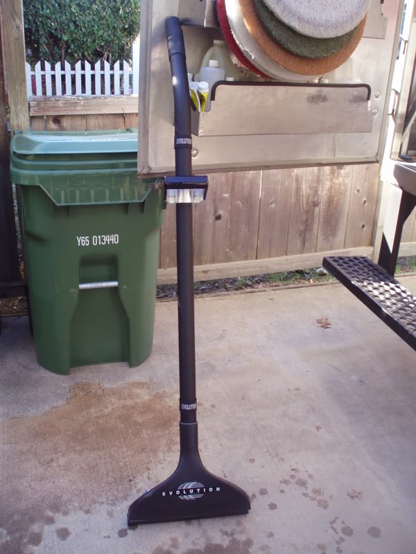

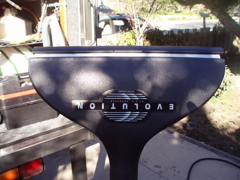

I know it is pretty easy to bash this thing, but i am really curious about it. i cant wait to get some reviews after mikefest and all i ask is for everyone to give it an honest try and let everyone know what you think.

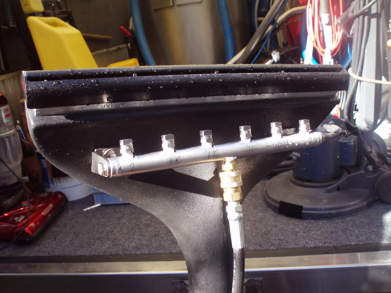

I am also curious why they are using two #2 jets and the rest are #1.5 jets.
They should be the same size across.
Is the glide Teflon?
What is the Quick-Disconnect for ??

As I understand it, Mike asked them to send it with .02's and they only had two in stock, so they put the two they had on, and used the .015's as fillers. It comes stock with .01's. It is not anodized. The head is plastic, the tube is aluminum with a powder coat finish. Mike didn't buy it, US Products was kind enough to send it out to demo at Mikefest.
James, I believe it's retailing for around $900. The 12", 1.5" tubed portable version sells for $550.

Actually, I thought the jet size difference would be an interesting experiment. Usually there is lots of jet action in the centre but not much at the sides, esp when cleaning against baseboards.
The quick connect would be for maintenance/ hose replacement possibly, but how often would one really need to replace that? Just another point of failure esp if used with high heat.
I like the design, couldn't it be made from SS?
