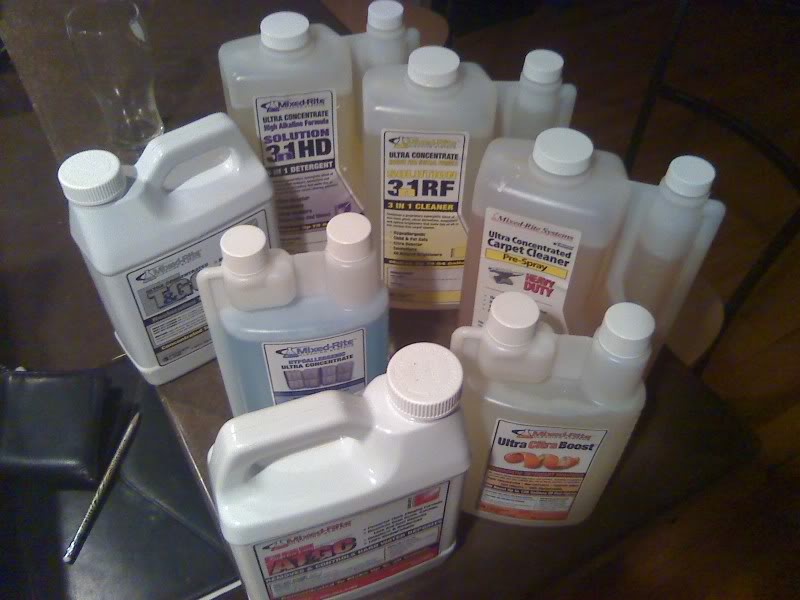

Mixedrite delivers..
116,102
now lets see what they can do..
Their all right but not as good as the Havard Chems but they
do have great bottles! :lol:
116,102
I'm a bit surprised that a rinse/emulsifier was not in the package.
two different heavy duty presprays, a neutral pre spray, a deLimeO booste,r baby blue spotter, a tile cleaner and a soap scum remover.
Maybe we could get a run down on the virtues of each product here....

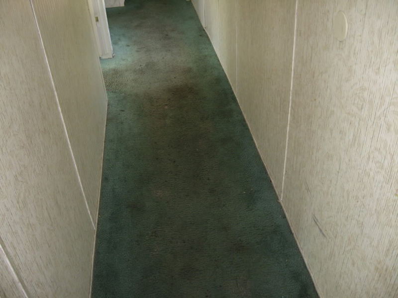

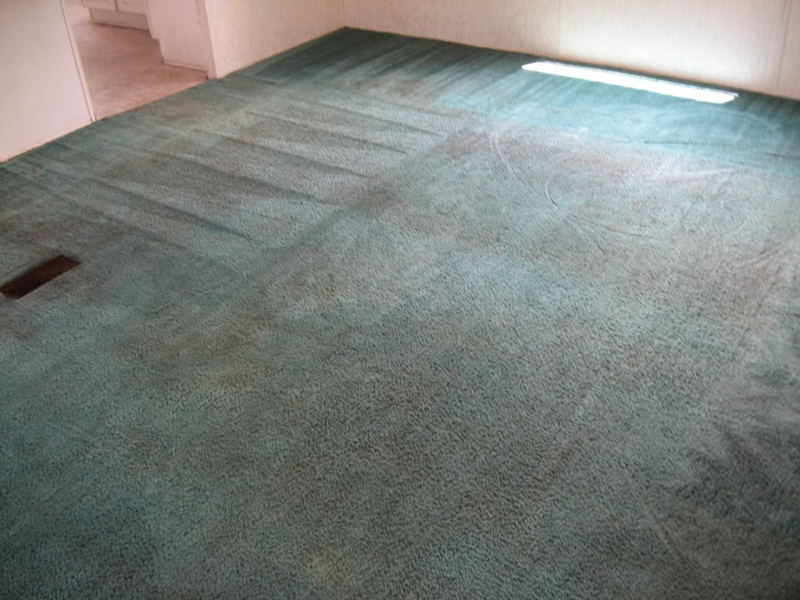

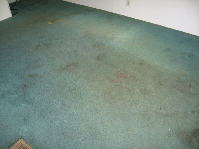

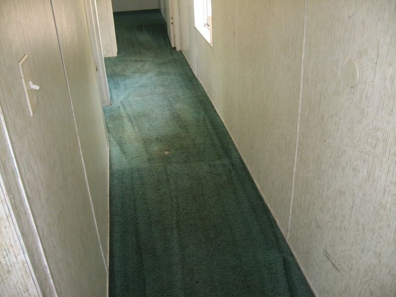

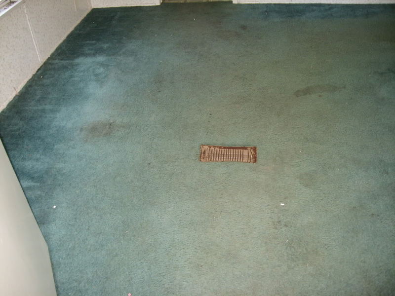

I got a call to do a rat nasty move out trailer today. I tested out the mixed right high alkaline 10.5ph stuff. I don't think it's quite strong enough for this kind of work but it does ok. I give it an 8 out of 10 for trashed rentals. I don't know if it would be good for restaurants unless they were nylon and not filthy. I'd say it's a mid strength cleaner. Powerburst probably would of done better, 12 ph was needed but the owner was happy and I did better than his previous cleaner. Took me 2 hours.
Before and afters

Perhaps. But its a trashed rental. People rent places like that for a few months never clean them. And move out or get evicted. Places like these just get trashed again. So cleaning them to make them livable for these kind of people is the only option that makes sense.
Also the carpet was heavily worn because it wasn't vacuumed in probably 9 months. Probably only swept with a broom.
I would of roto scrubbed this job but there was no power. I ran my vacuum off an extension cord but I wasn't gonna try running my scrubber off the extension cord.

I couldn't roto scrub this bad boy like I said no power.
As far as chems I mixed accordingly to the bottle, probably 8-10 oz of the stuff. I sprayed down the whole place very heavy and gave it plenty of dwell time to make up for no rotoscrubbing. And I had maybe an inch left in my HF with a yellow tip on it. So I nuked the hell out of it. I put 3 cups of point blue as my rinse and rinsed at like 5-6 to nuke this place. It just wasn't coming clean. I'm thinking they may of done engine repair in this place....but I don't know. Peroxide may of helped but face it it's a rental and the extra effort just wasn't going to do anything for me or my customer. All he cared about was an improvement and I did that, 90% of the crap was gone and he was happy.
I also love how people say they can do better just by looking at a picture. I even went over many of the areas 2 times with prespray and many many passes with the wand. It just comes to a point where it's not worth it. I'm also beginning to think many of you guys have never cleaned filthy carpet, not everything will come completely clean. And if I was getting 50 cents a ft I may could of done a mikey type clean, but rentals you clean as quickly and cheaply as possible and spot cleaning is not even in the cards.
