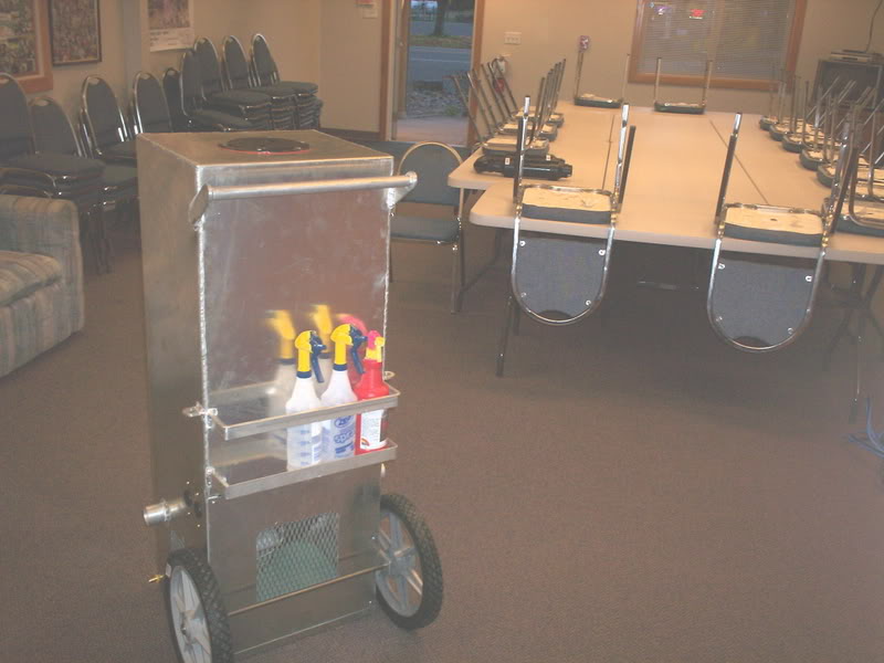

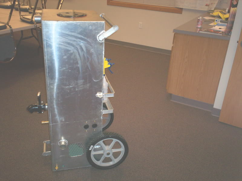

This is terrys unit

I have looked at Terry's unit before. Looks well made. His website doesn't list specs. Anyone know what that unit weighs and is it
Auto fill only?
