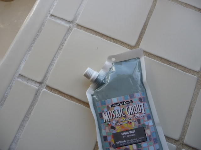

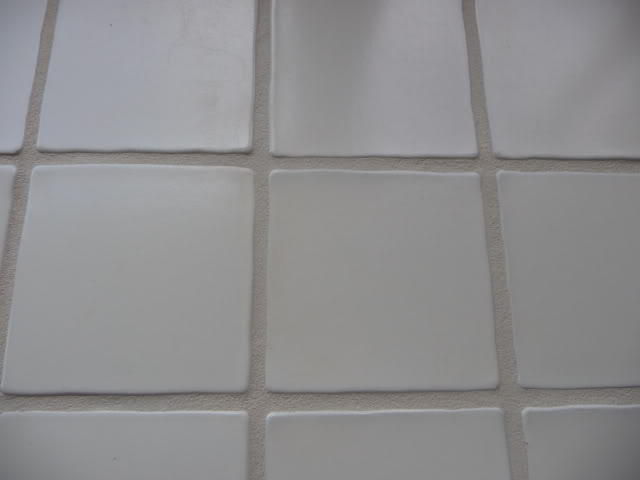

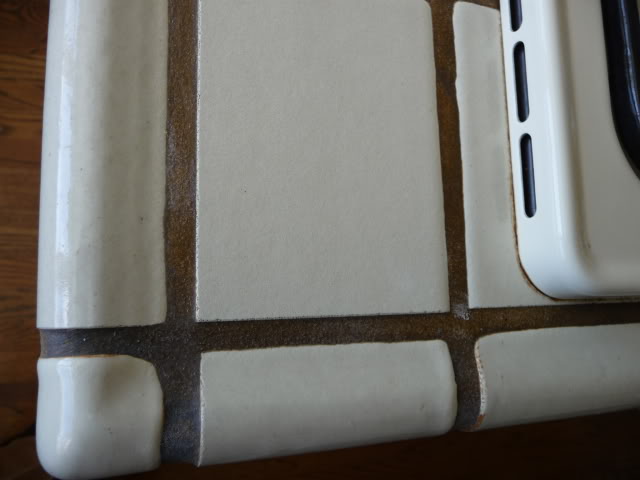

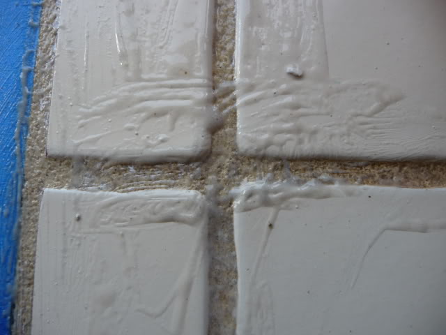

This lady though using some premix grout to cover her stained counter top.
Not only did she goop it up real bad but she used the wrong color.

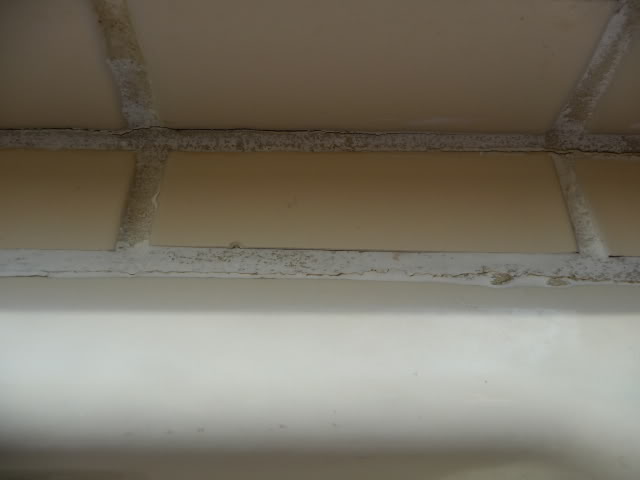

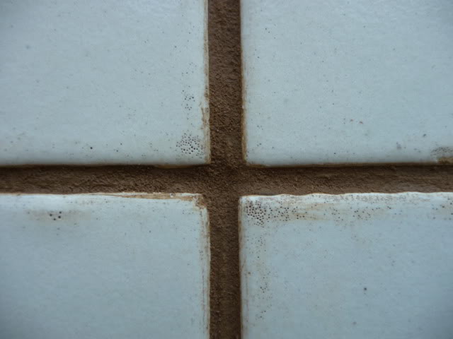

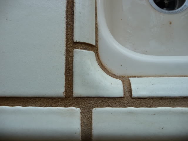

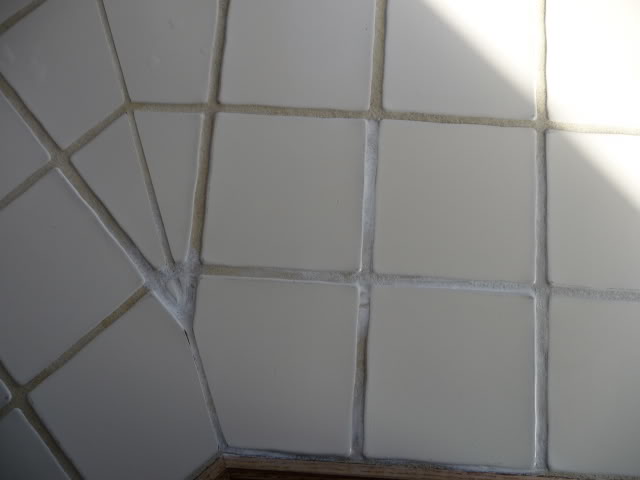

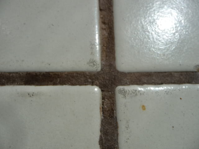

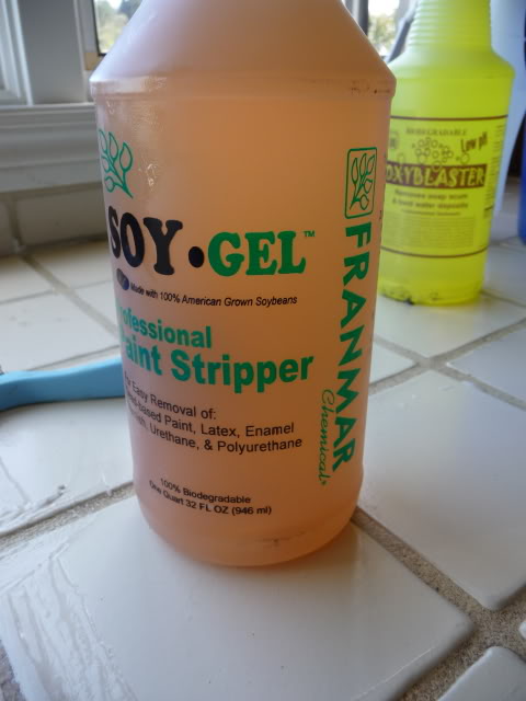

I used Franmar Soy Gel stripper. Nice safe stuff. No odour and not skin burns.

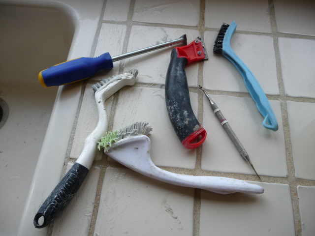

and a few tools..

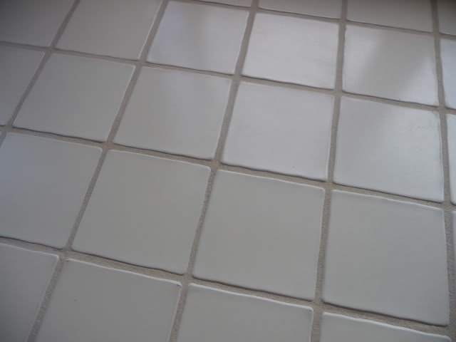

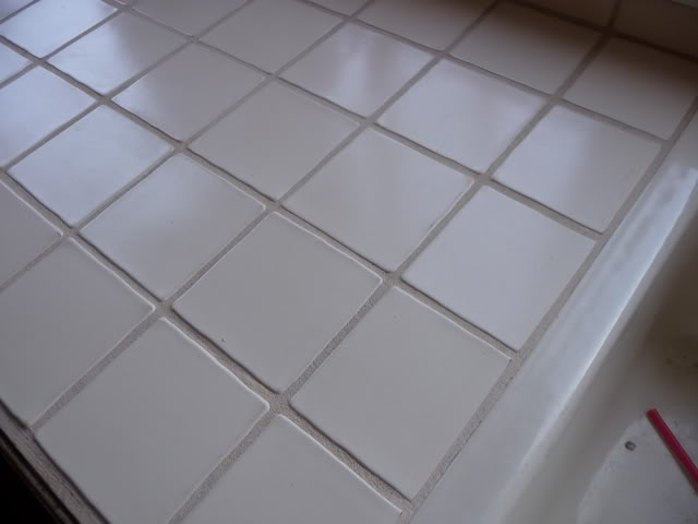

Power washed it off, color sealed it with Grout Perfect and voila!

Thats a great job. How long did it take and what did you charge. Alot of money in tile cleaning a repair.
Great job!
Have you ever used that Soy Gel stripper before? And is that a Magic Wand product I see in the background there? :shock:

Do you always use those dental instruments. I just realized I have boxes and bags and more boxes of them
that my wife has used/autoclaved/retired over the years. Now I have some Ideas!

Magic Wand Acid is weak, I prefer Restore but want to use this stuff up.
