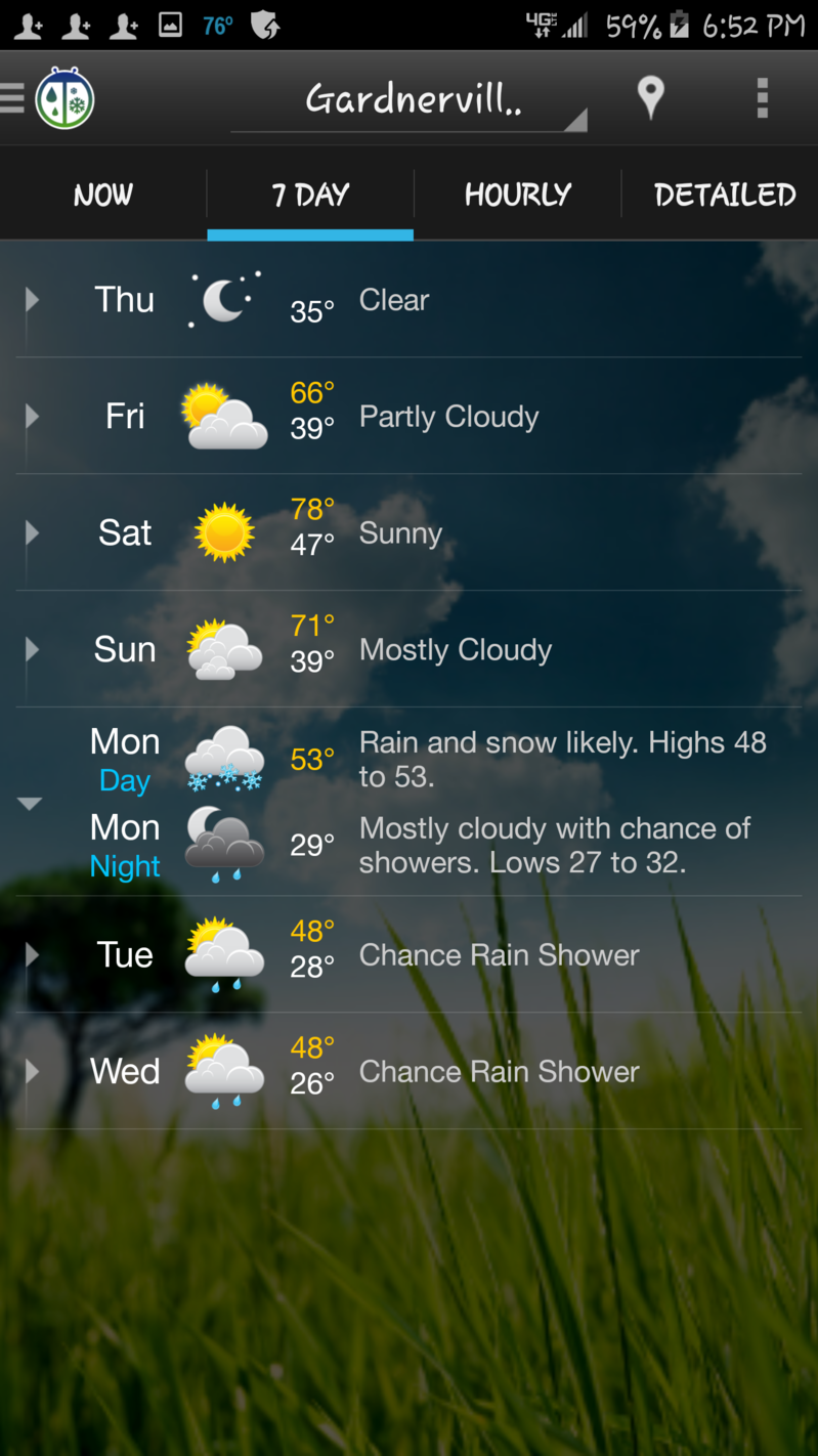

Monday is our first freeze
116,029

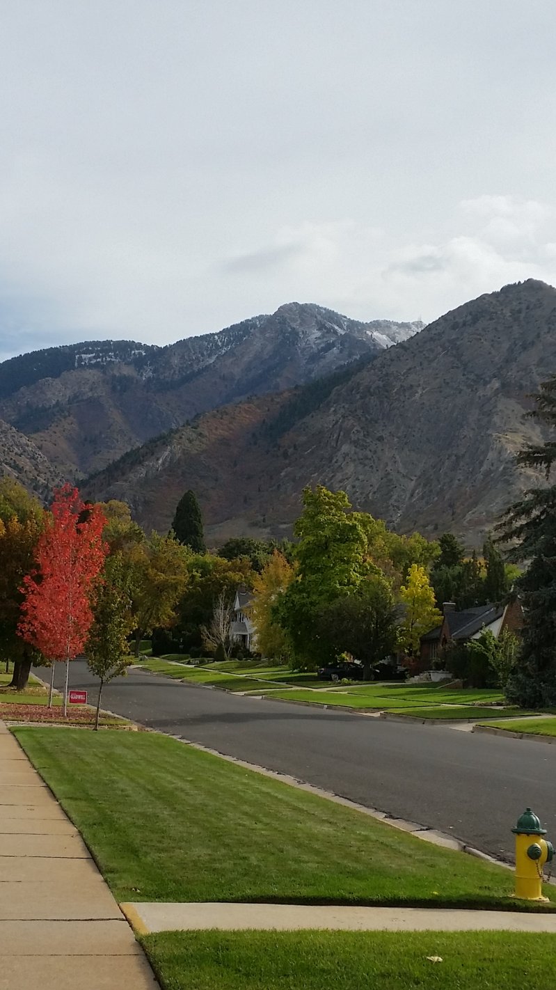

15" of snow above 7000
Dusting on the valley floor and high winds..
Tell me again what I should do with this 370?
It will be in our attached insulated garage..

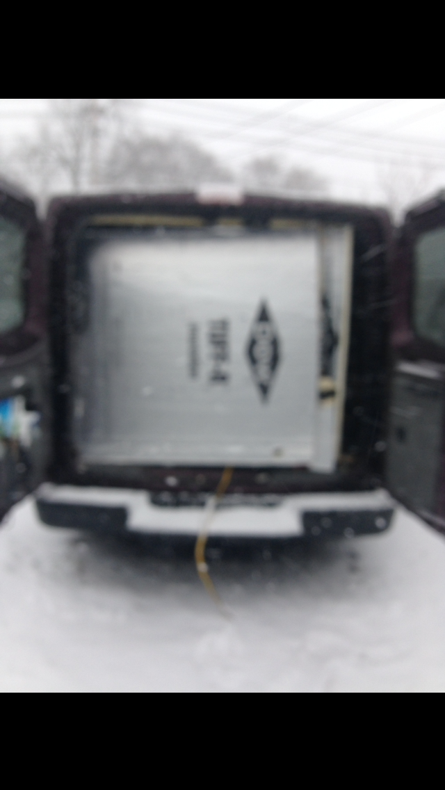

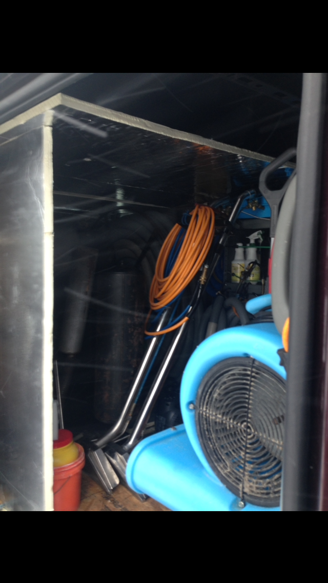

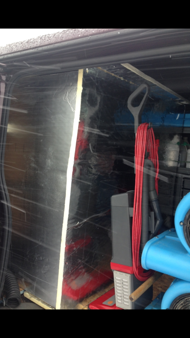

We have a freeze warning tonight. All the TM's in but one. Our north garage has fire contents we need to move into the building next week.
The one tm outside has a single heater in it. Mike its not single digits, run one heater just to make sure the temps don't drop too low in there. Your day temps are so high its not going to be cold enough to be too concerned yet.

That's not too bad really yet....
Inside your garage ....especially with insulation, just the heat from the van having been run will help, and setting some type of heater in it too a preventative can help....
But I bet you will be good....close all windows and doors too.
If you ran the TM for awhile before putting away, that heat exchanger and unit will help keep some heat in there too...

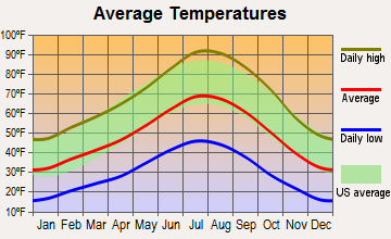

How low do the temps get in the Winters there Mike?

Looks like awesome weather, maybe even 4 real seasons!
I bet you won't have to sweat it too much. It's the sustained teens and below that can cause trouble. A decent little electric heater should be all you need. Set it at 40 degrees in the van and relax.

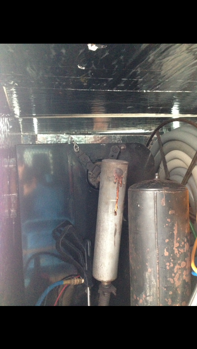

The freeze issues I've dealt with start at the bottom of the truck. Watch out for your fresh pump if it's on the floor of your van. Those ag pumps can freeze up quick, I'm pretty sure it's because there is so much metal in them.
Glad my Cleanco doesn't have one.

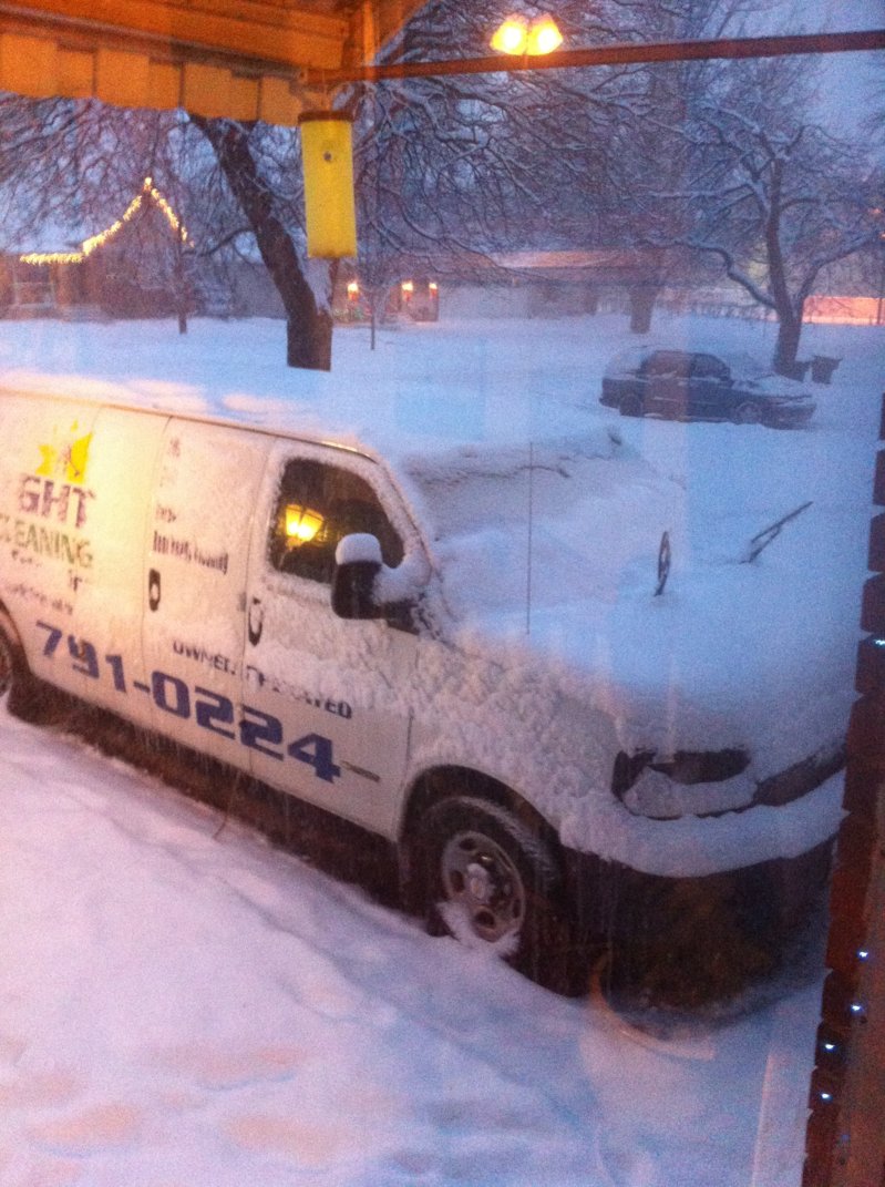

I wish I had the picture of my van in the driveway with about a foot snow on it that melted and froze all the doors shut in about two inches of ice.
It got parked inside after that.

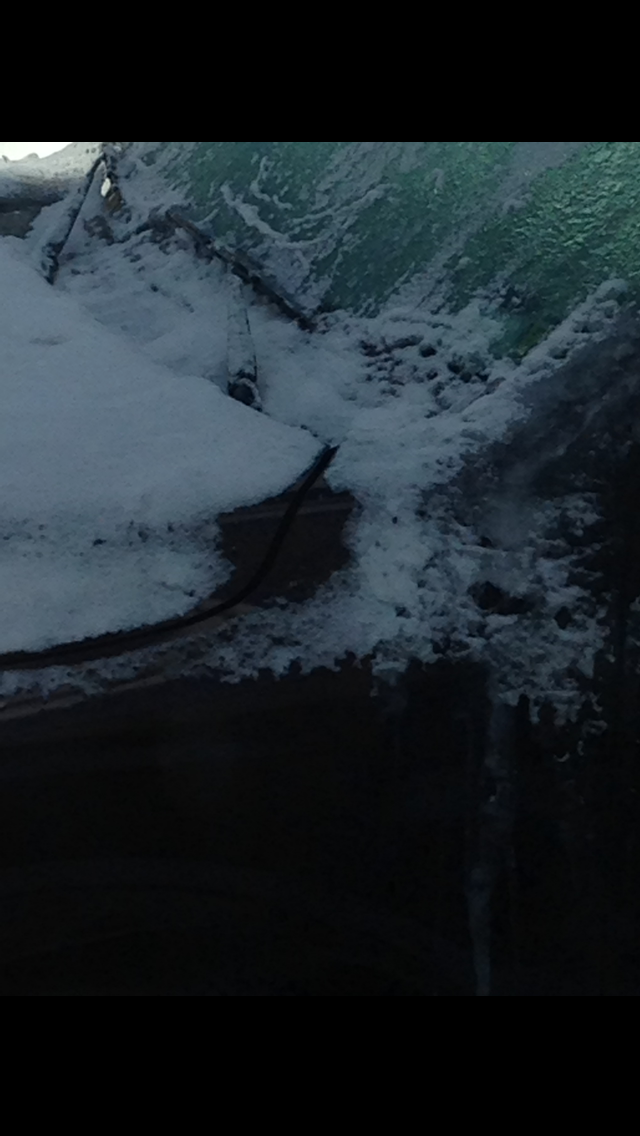

My 1st house I insulated the garage and didnt have to plug in a heater until it was less than 10 degrees out. This past wintewr was the first with parking outside and will be the last. Pluggin in the heater melted roof top snow then as the water flowed down the side - it froze the doors and wiper arms. There was like 2-3in of ice around the arm that had to be chipped daily along with chipping the door cracks to avoid bending the metal.
