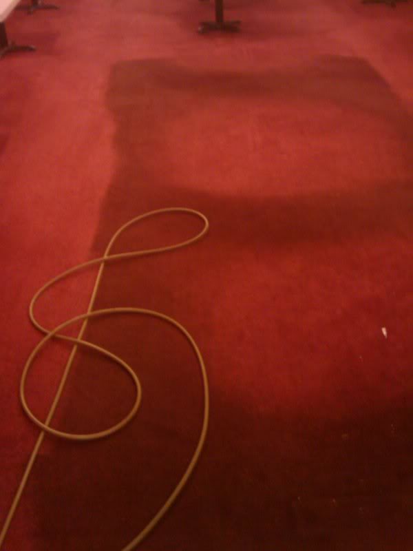

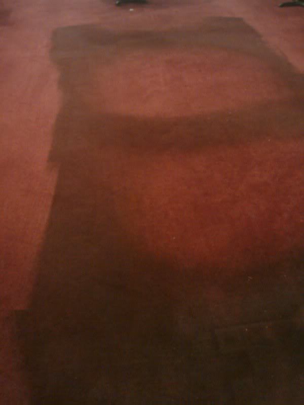

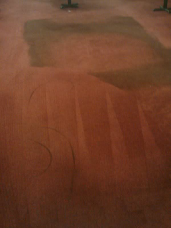

Ron Werner
Used Cleanco's Attack, pH11.5 with enzymes and degreasers
Whatever this stuff touches, it cleans.
Running CBS emulsifier, but not very strong
Before
Presprayed over the hose
Rinsed. Where the prespray didn't touch, didn't come off!

Regardless, it proves that using a prespray is gonna be better than just a hot water rinse. Then again any moron who wants to do a decent job already knows this.
