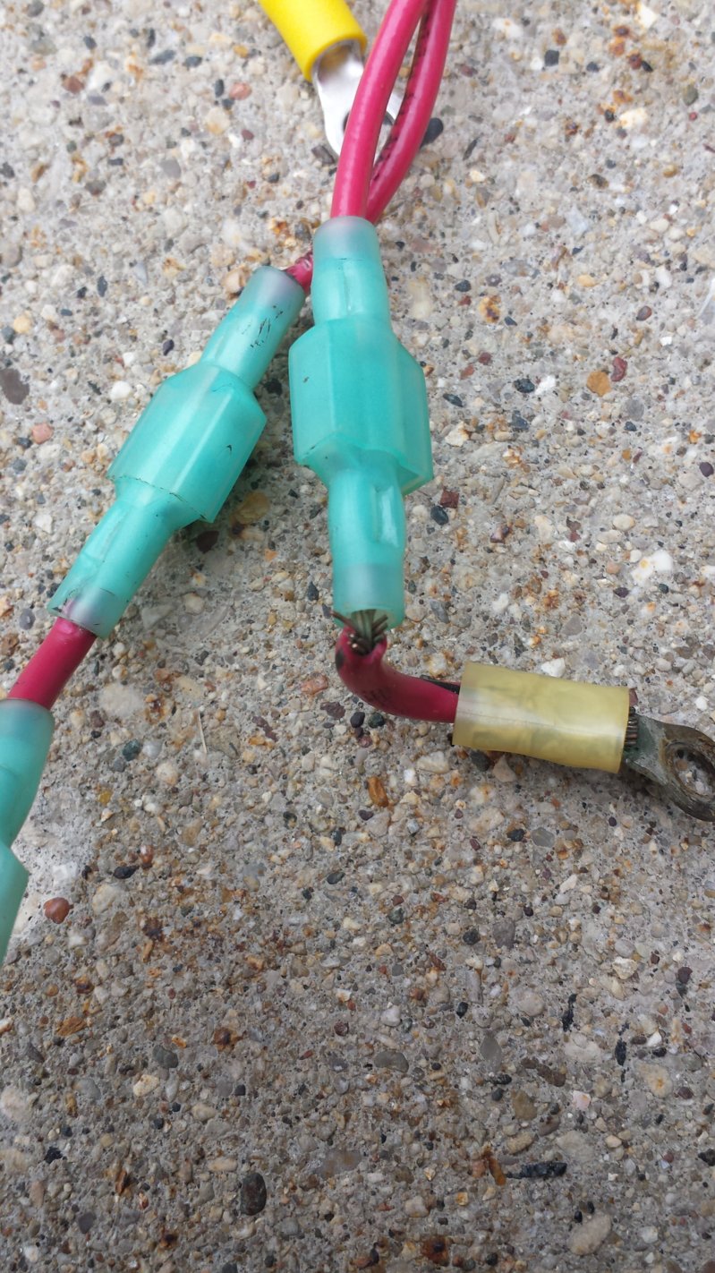

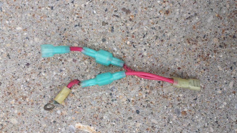

As I was poking around I found this gem!!
Hope this is it!!!!!

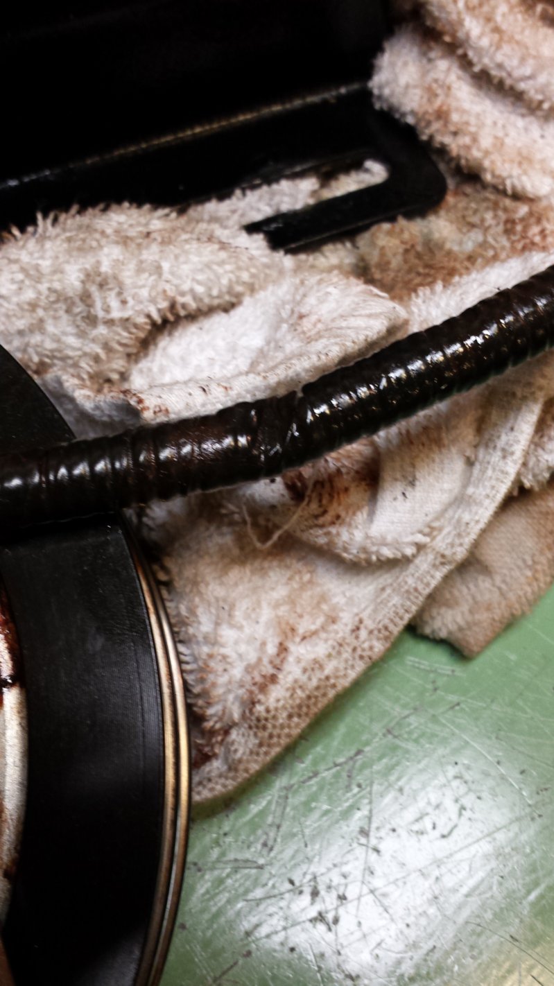

I did one at a time, it has that black wrap around the wires.. Though I will take another look..

I had two wires inside all that wrapping that had rubbed together enough to lose its shield. I ended up making an entire new harness. I got all the colored wires from wire barn and made it myself. It was slow and tedious but I got it done. My neighbor had the tool to crimp the ends before inserting in some of the special plugs. I was able to buy most of the plugs I needed from batts racing. It has to be a sensor or a wire in my eyes. Definitely where I would start. If it's a sensor removing them one at a time will locate it. If it's a wire that won't work but will tell you it's not a sensor. You can also test the sensors with a meter. They should all be open except the float which you've already solved. The spot can be so small it's easily missed because you have to look all the way around each wire.
