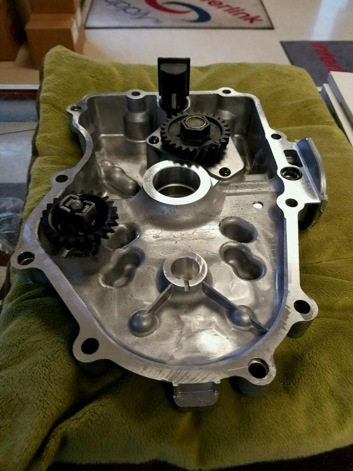

Back end has an oil leak.
I guess it so common than Kohler has modified the back to help the RV THREADS do its thing..
See that bevel on the lower inner edge?
That's where the RVT will gather to do it job..
Kohler is covering the whole tab.

There is no gasket kit for this
RTV
RTV
Well, sometimes the engineers get it wrong the first time...and the second.
If that were my engine a gasket would be made for it before I reassembled it.
I've pulled apart RTV long after the stated cure time just to find uncured wet product.

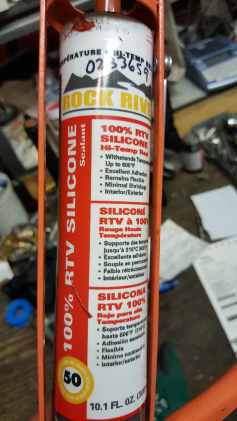

I hope it works out well. The only info I can find on that sealant seems to indicate it's for interior/exterior architectural use, along with ovens and boilers. No mention of oil resistance. Maybe it said so on the tube?
A lot of mechanics just don't like the idea of spending 25 on a tube sealant.
Apparently that's true - the sealant used is $5.99 at Fastenal....
Cheaper is better - as long as it works!
