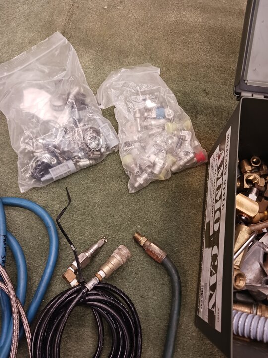

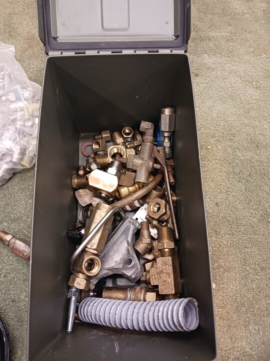

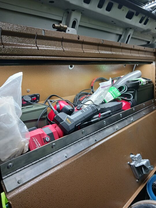

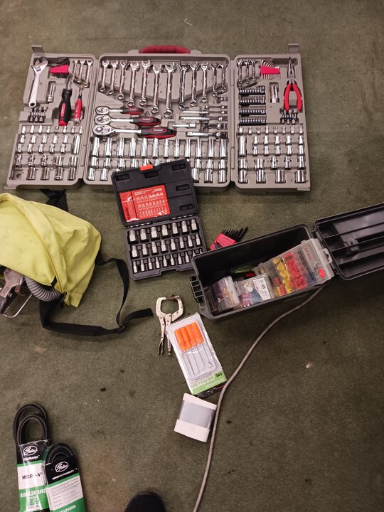

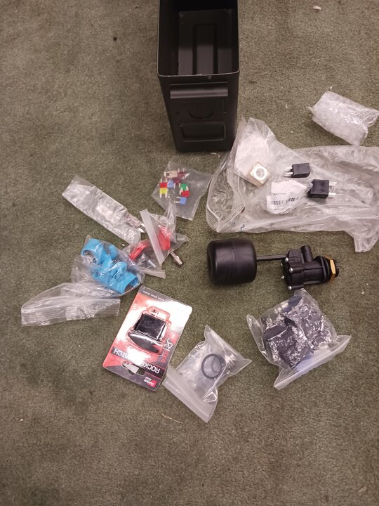

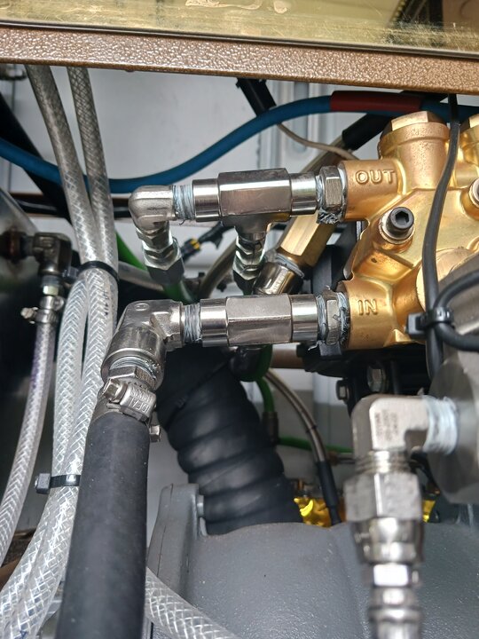

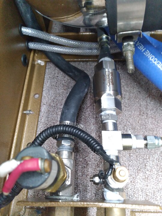

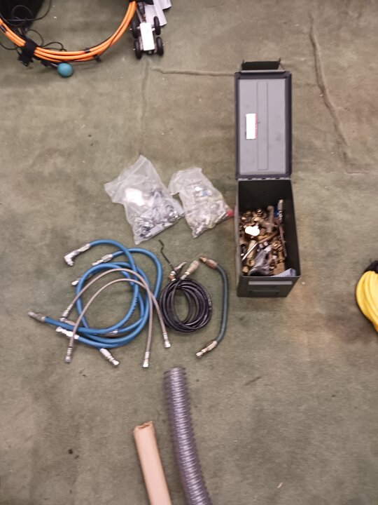

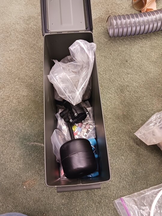

Here's what i carry. It tends to be a bit extreme but im regularly 4 hours round trip to my shop. All the parts fit into 3 ammunition bioxes with the exception of the of the belts. I have a few wrenches and screwdrivers handy at the machine. The big folding tool kit sits behind my driver's seat it was a 129.00 well spent every tool has a place.i carry a complete extractor set but in reality you only need about 3 or so sizes
20230126_142157.jpg 20230126_142656.jpg 20230126_142716.jpg 20230126_142727.jpg 20230126_143021.jpg 20230126_143159.jpg 20230126_143202.jpg 20230126_143207.jpg 20230126_143215.jpg 20230707_123503.jpg

I check all belts,hoses,fitting,general condition inside covers of machine, grease blower ,clean wastetank & wipe down outside of machine every 100 hours. every 500 hours i also change blower,pressure pump and waste pump oil. My pto drive shaft has sealed bearings so i have no driveshaft service except replacing bearings whenever they start to vibrate approximately 2000-2500 machine hours i replace Serpentine belt at the same time. As far as the van checks go each and every morning i open the hood check oil,coolant, brake and power steering fluids and i peek at the Serpentine belt in addition, each time i move the van i glance at where it was parked for fluids on the ground (that is a good habit to get in to if you don't already do it especially with pto's, they operate unattended sometimes for hours) most leaks can be found early that way, before they become big problems as far as fluid changing goes my Van's computer tells me when to change motor oil but with the older ones i changed engine oil every 3000 miles & 5000 on vehicles without pto's tires are rotated and brakes are checked at that time chassis & ujoints are lubed every other oil change. transmission and rearend fluid 25,000miles power steering &brake fluid every 3 years or when maintenance is required. Coolant hoses replaced every 5-7 years silicone hoses last much longer. Thats what i do but then i do have my own facility for that and not paying someone to do it . I generally get 16-20 years outa a van and 11k+ hours on machines. If there was 1 thing outa all ive said so far i consider most important that would be always look back where your van was parked for fluid leaks that one simple habit not can, it will save you several thousands of dollars in major repairs

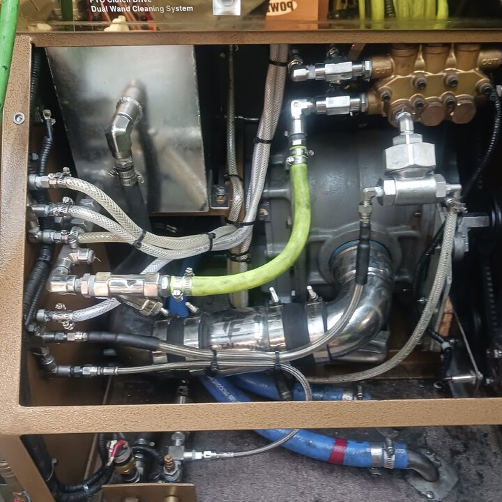

Thanks for the tips guys. Dwain, your the mechanic man for sure. What the heck are all those belts for?! 😲 My van has a serpentine belt, and my tm has a blower and pump belt. I do like the simplicity!
I see a float assembly for a water box, fuses, relays?, a switch, some vac hoses, a variety of solution lines, and a boat load of brass and stainless fittings, O rings, and way more. I suppose every time I need a part I'll buy two, and some day I'll be half as prepared as you are! Epic.

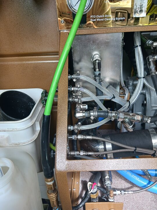

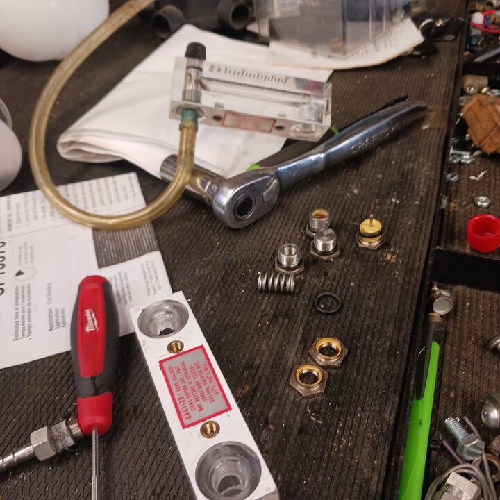

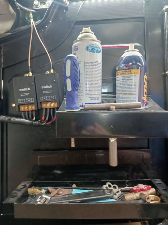

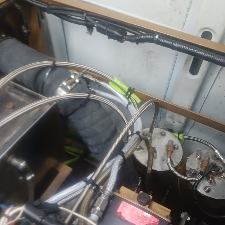

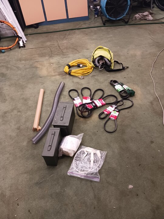

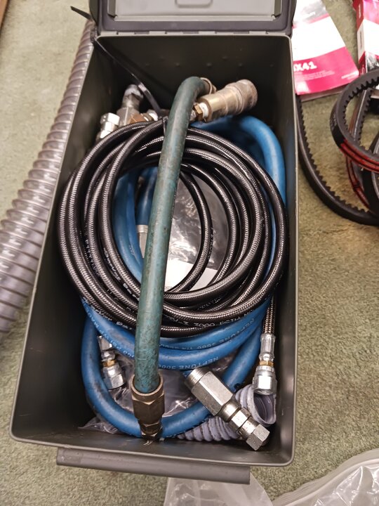

I spent 6 years in the coast guard working in engine rooms. One thing that you learn quickly is that if you don't have the part you need when you need it you and everyone else on that ship could die. I spent a November, December, and January in the beiring sea where i witnessed that first hand . That life lesson has stuck with me ever since.The belts are my machines it has 2 B belts to drive the blower and an A belt for the pump And Serpentine belt for the engine. I carry 2 sets each incase i damage or contaminate one during installation ( old habit) my machines fittings are all stainless . The stainless fittings in spare parts are left over from the build. All the brass is spare parts from a decommissioned machine. To stock all stainless is very expensive and unnecessary so i keep the brass for the unlikely event that a stainless fitting fails i can repair it till I can order the proper stainless fitting and schedule a time to exchange it . Also all hoses are double clamped so wherever there's a hose clamp there's a backup already installed
20250208_160119.jpg 20250208_160041.jpg 20250124_143410.jpg 20250124_142659.jpg 20190406_125809.jpg 20190406_125948.jpg 20220725_153657.jpg 20220925_125050.jpg 20220925_125139.jpg 20220925_125229.jpg

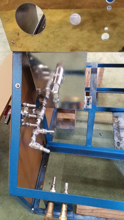

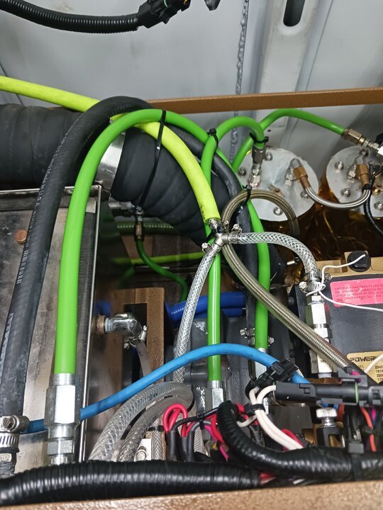

Since taking all those pictures in order to avoid black death i up graded all the hoses in my machine from regular 100r soulition type hoses to 3/8" stainless braided teflon hoses with 1/2 jic stainless female fittlngs. In the past when black death was detected all the hoses had to be replaced because it was all but impossible to find the one that was bad. as a bonus i was able to reduce my spare hoses down to 3

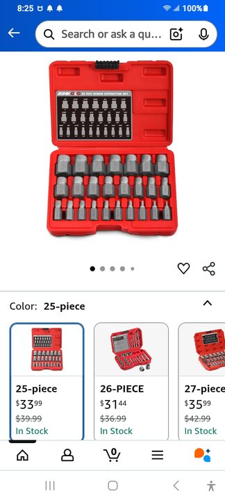

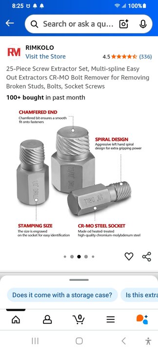

I've struggled massively the few times I have snapped bolts. You mentioned that you carry an extractor set and that you only typically use 3, what style of extractor do you find works really well? Also what is black death in solution lines? You're inspiring me, as money and time provides I will slowly be upgrading my machine for durability.
To tell you the truth i don't know what size screw extractors you'll need because i have sets. One in each van and 1+++at the shop and i grab the smallest that'll fit and work up if necessary. On the van there mostly used to extract broken brass fittings. If ya drops the wand and snap off the quick connect you can remove the broken end grab another piece a little teflon tape( in spare parts of course) and your back in business. Black death is what we refer to when a hose degrades from the inside. If you cut the end off a soulition hose youll see the black inner hose that carries the soulition. What happens is youll be running fine thinking the universe is treating you well and you pull the trigger on the wand and a black licorice colored water suddenly comes spraying out onto the carpet ( Murphys law says itll only happen on an all white carpet with your customer standing next to you) anyway thats black death that inner hose has deteriorated from time/heat/chemicals . It'll clean up if you get on it immediately but can be at the least embarrassing and time consuming to find the hose thats the problem. So in my machine I eliminated all the hoses that had that inevitable problem and now my machine hoses are teflon lined so when black death happens in my case its eighter the hose i connected to the machine or a hose on the wand in using much simpler to deal with on the job as far as my travel goes i live on the rugged northern California coast 141 miles north of san Francisco. 1 road runs the the length once i leave fort bragg theres only 1 traffic light for more than 90 miles south and none for 50 miles north but the coast is dotted with small towns i seldom go more than 5 miles inland but i travel from Westport to the north to Timber Cove to the south. Mostly all residential I do not charge travel fee but my price per sqft goes up geographically. in fort bragg/Mendocino area i charge .50 or .55 per sqft 100.00 min in timber cove i get .70 or .75 per sqft 400.00 min (2 house min also) im not makin a killing but its a good life
Screenshot_20250710_082553_Amazon Shopping.jpg Screenshot_20250710_082534_Amazon Shopping.jpg Screenshot_20250710_085551_Maps.jpg Screenshot_20250710_091442_Maps.jpg Screenshot_20250710_091451_Maps.jpg Screenshot_20250710_091502_Maps.jpg Screenshot_20250710_091520_Maps.jpg

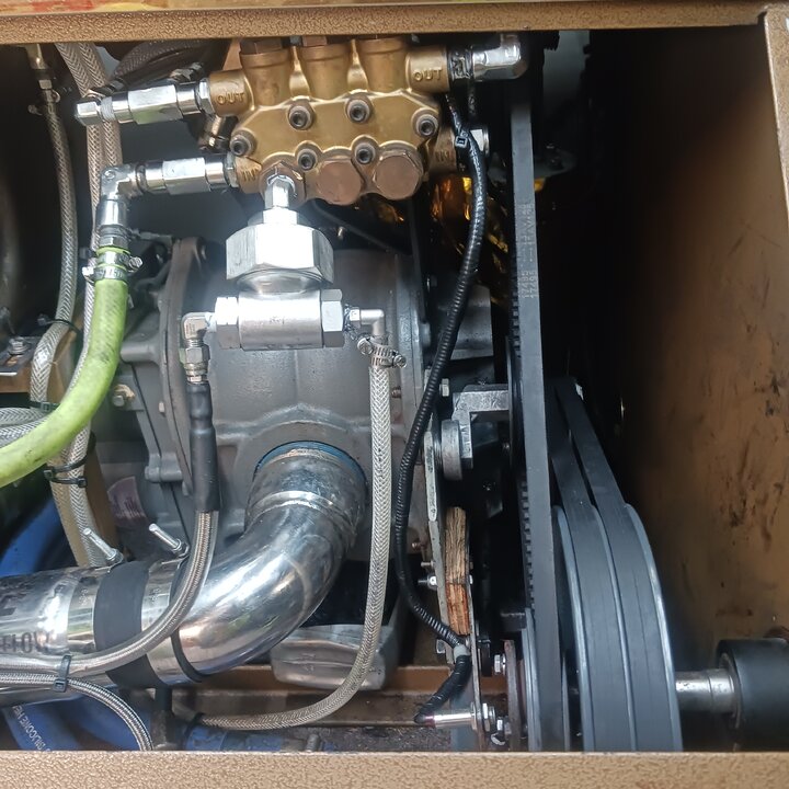

I just discovered that one of the mounting bolts on the blower is sheared off. A fitting question I asked you this morning. the whole blower is pitched slightly downward on that side so much that the pulleys are not aligned, its obvious just looking at it but my square confirms it. Might have something to do with the squealing belt. I think this will be a bear to get out. I've never had much luck extracting bolts that the head sheared off of. Does this look like it will need to be drilled out and tapped?

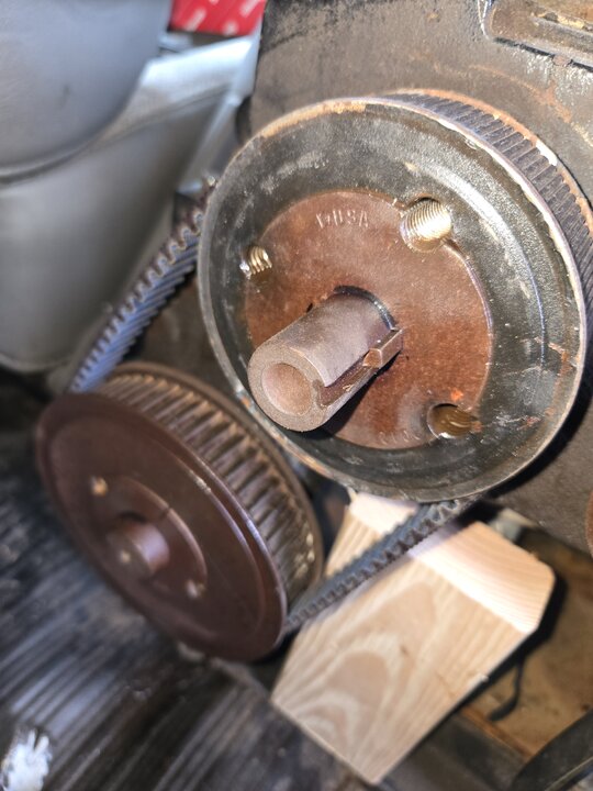

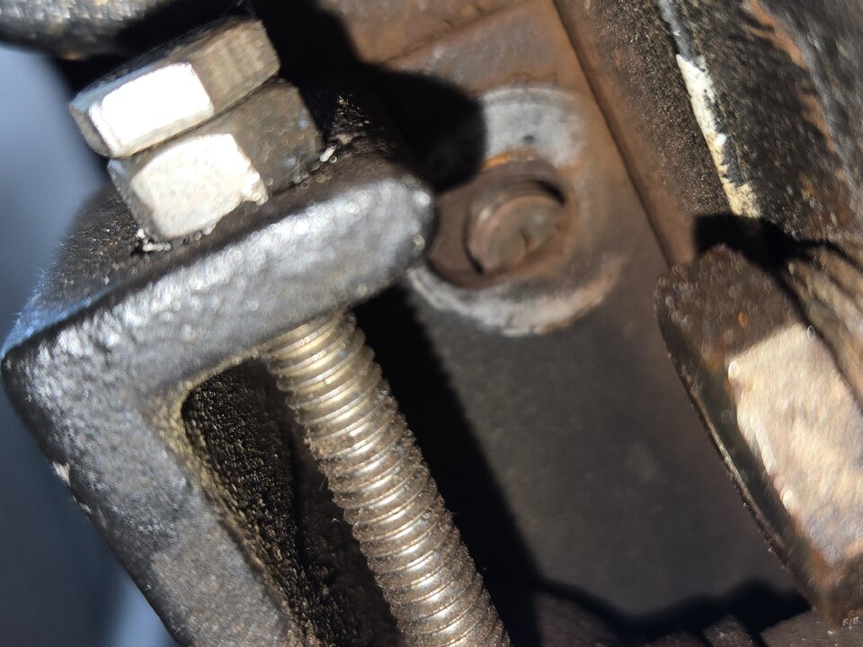

Dwain do you have any tips for removing a stuck taper pulley? I used a torch and finally got the 2 retaining bolts out, but the pulley only has one threaded hole to use a bolt to press the pulley off of the bushing and it isn't doing anything. I've been wrenching on the removal bolt, used wd40 many times around the bushing, and been tapping the pulley with a hammer while wrenching the removal bolt.
Not sure what to do next aside from start smashing against the blower pulley very aggressively, but that feels like a bad idea...

Well, of course the bushing forms the bond holding the pulley to the shaft. I think I know what you’re thinking. You’re thinking the pulley has the back off the bushing for the bushing to be removed first. Maybe that’s true in some cases, I don’t know, but I’ve never had to do that. Once the set screws are removed, the bushing and pulley slide (or screw) off the shaft.

As far as I know a bushing has a split in it and when the pulley and the bushing are screwed together, they are basically jam nutted on the shaft. As for how this comes apart, I would guess the pulley needs to be pushed back towards the blower to be separated.

Using a puller to pull outwards on the pulley would simultaneously tighten the bushing on the shaft wouldn't it? I watched every video I could find on taper pulleys and the pulley is always pushed backwards away from the bushing, then the bushing is freed up to pull outwards off of the shaft. If need be a flat head is used to wedge the split on the bushing apart further loosening it...
I got it off anyways. Blasted it with a torch and it finally popped off using the grub screw in the unopposed threaded hole. I am planning on replacing the blower belt anyways but next time I think I need to loosen the pillow blocks and move the lower pulley to remove the belt first. Torching the blower belt with the pulley on caused some of the blue paint on the inside of the blower belt to rub off on the pulley teeth.

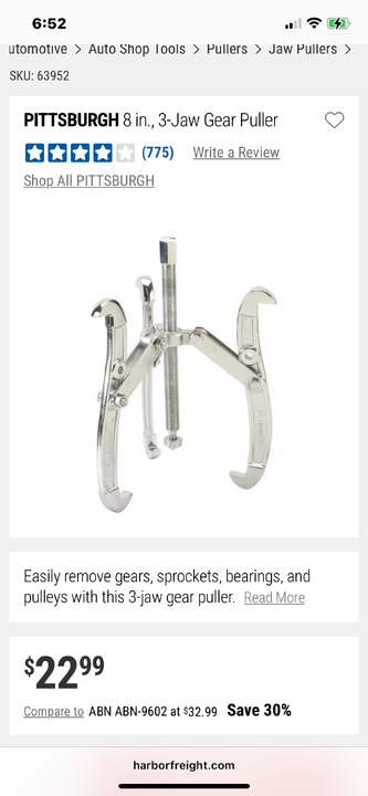

I’ve only had to use a three pronged pulley removal tool once. I had to use it to pull a seized pully and impeller out of a blower. Every other time I just reversed the set screws and ā€œpushedā€ it off. Heck, maybe there’s something about your situation I’m not understanding.
It was just stuck like hell. On another note I heard a pop when I was putting the new blower mounting bolt in to replace the one that sheared off. I'm really really hoping it was just the bottle jack shifting when pressure was taken off of it as I tightened the new mounting bolt to the blower. I'll find out tomorrow morning.
