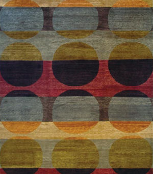

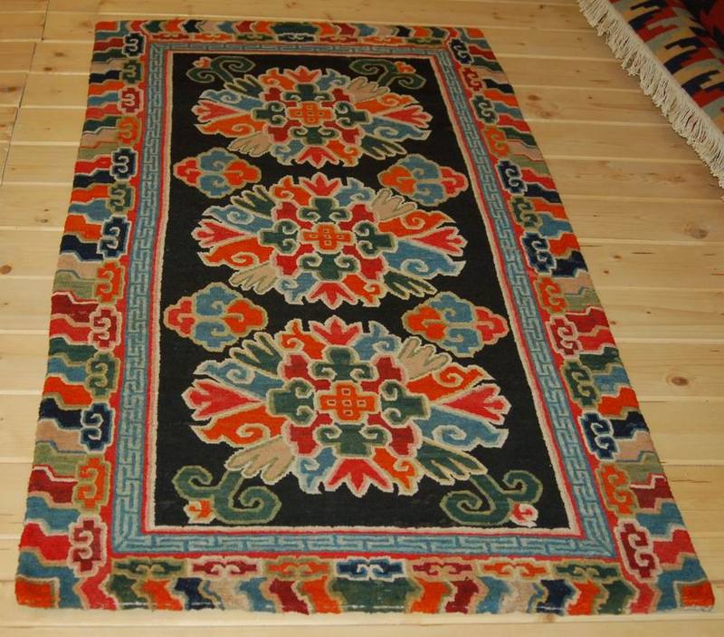

Wool rugs pretty easy deal to clean. Until you get ones with pet urine. Just removing that from the back is joy enough. Don't get them to wet. Fibers can start to fall out easily on wool (especially long pile wool). We use less than gallon of water for the entire clean. For a 5x8 rug you had, would have charged them $90
We did stop cleaning viscose rugs though, colors bleed way to easy.
Wow That is good to know.
115,963
This job is done, most soils come off and the grease spots as well, costumer is happy with the results.
thanks guys again
