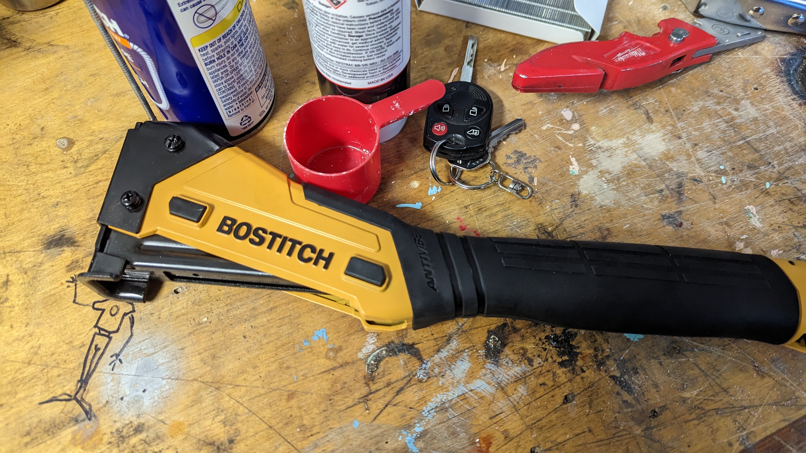

Well in other news, after our leaky flashing debacle two weeks ago and my little sissy electric stapler on top of a wet ladder in a rainstorm, I scored this today PXL_20230109_005508703.jpg

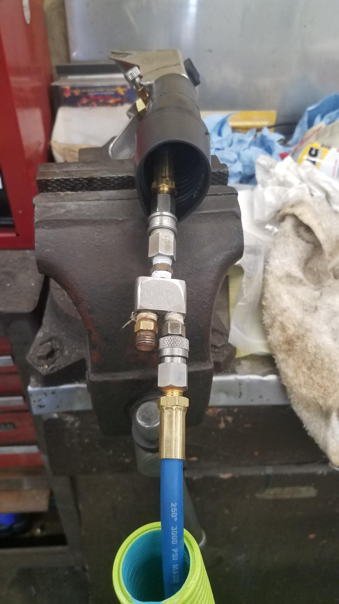

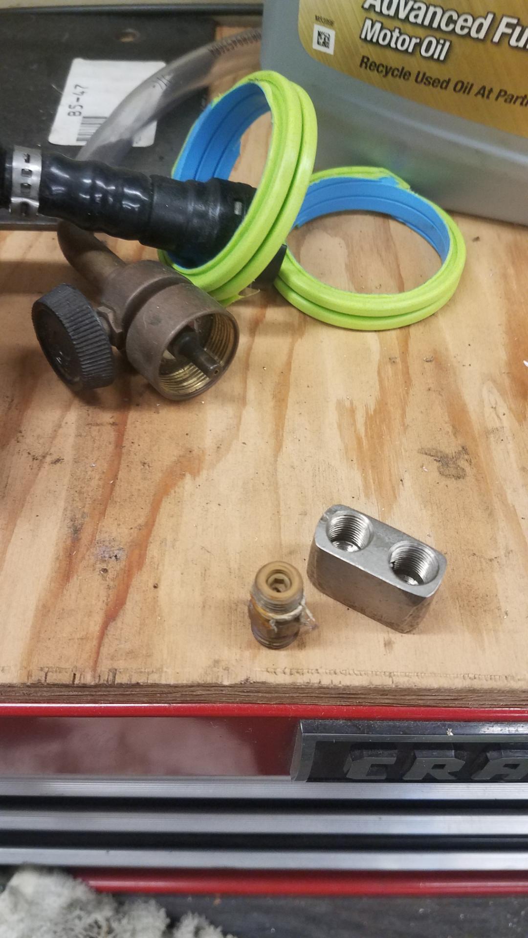

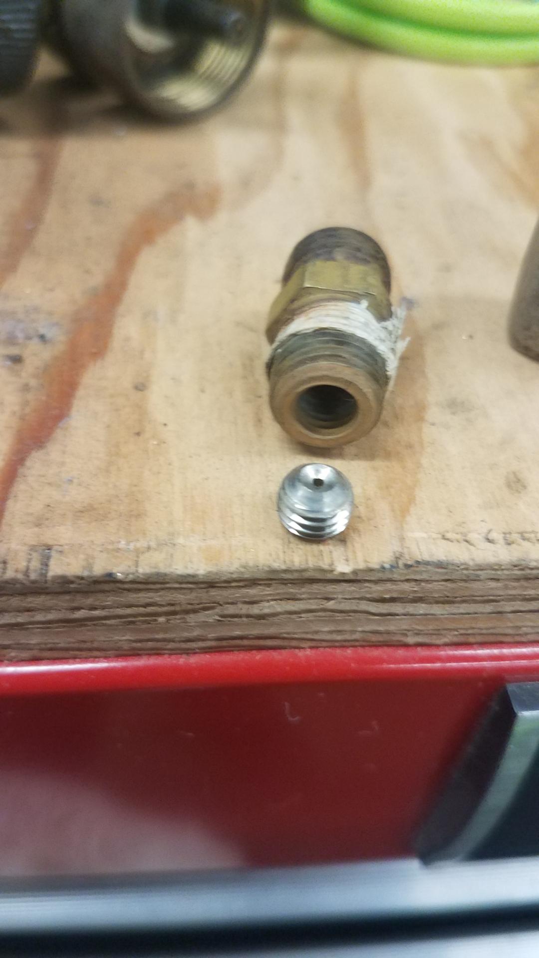

I like the prochem tool with 1 modification i installed a modified kleanrite bypass inside the vacuum hose to keep the solution hot. the standard bypass on the tool only bypasses while spraying, i use it to control flow and my bypass modification keeps solution temperature up when tool isn't spraying
