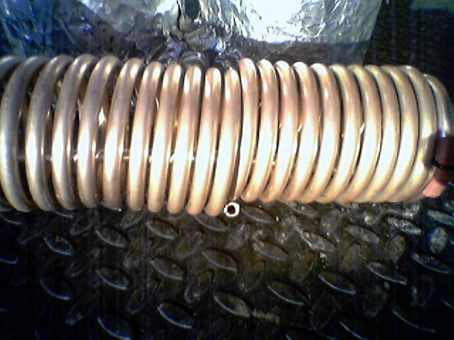

This thread was brought to my attention by one of our dealers. These coils carry a 2 year warranty, not 1 year. I apologize if you have been told otherwise by someone at our location but if you will contact me I will correct the situation for you. We are moving next week to our new location so you may have a difficult time getting me by phone but if you will e-mail me at pcikeith@sbcglobal.net I will get this worked out for you ASAP.
With regard to the comments about using stainless instead of copper, we have been using these coils for about 10 years and I have never seen this type of failure. Other companies in our industry have been using this same coil for even longer and it has been extremely reliable.

As I've said before, Powerclean stands behind their machines if there is a problem. Keith's a good guy.. but back to the coil, If they used a SS coil the heat transfer would be extremely poor for a 3000 psi coil. That's why copper is used for the Pre-heat and everything else is stainless as Gary mentioned. On the pto I'm doing I've tested stainless coils/tubes, copper coils/tubes all of different wall thickness. This is strictly for liquid to liquid heat transfer as on the Genesis. The heat transfer on the high psi stainless (and I'm talking about 1000 psi tops) is almost non existent with any good amount of flow. Copper is the best material to use for this situation. Exhaust is a different story..

I have found by playing around with things in my shop. A 10,000 psi 0.035 wall thickness ss coil does a pretty good job at liquid to liquid transfer.

Floorguy, if I understand your question correctly: "I am still confused about why it says stainless then??? ", you are trying to understand which heat exchange is stainless is that correct?
The actual exhaust heat exchange is stainless and so is the engine exhaust muffler manufactured in stainless steel. So is the exhaust tubing also made from stainless.
The Genesis has three other static heat exchanges apart from the exhaust heat exchange. These are low temperature heat exchanges for pre heating the water only.
