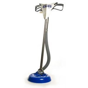

I have proto/beta in my hands and am curious what you owners of the SX 12 did not like about yours
I have not used it yet but I'm liking all the features.
Brush rings comes off sans tools, vac port is easily adjusted, Nice big vac ports, 15 inch head, 2 inch tube shiteatinggrin

vac holes are a bit small on the SX-12 and clog easy.......
the brush on it will aerate and makes your chemical foam up a bit
116,981
the vac ports now are very Turbo-ish.
I'll let you know about the foaming action

I've had it for quite awhile. It is 80% there just a couple of tweaks in my opinion. Not 100% sure if any tile tools need 2"' tubing and the 15"'head sounds good in theory but I'm not out in the real world so Im not sure if a bigger head is needed either. Other then that it looks like a winner so far.

Just picked up a improved from flex sx 15. Really like the turbo force from the good reviews but decided to give this mofo a try.

They missed the mark by 1/2 on this tool. The cleaning path is like 11.9" On a 12 tile having a 12.5 or 13" path would save time by covering 2 grout joints at once. For refernce a 12" turbo will leave a 10" clean line. Anyone know what a 15" turbo will do?

Why do they need the 2 handles? Seems like they would get in the way around corners and doorways. I use a turbo but far from loving it. The gekko is needed in tight areas.
