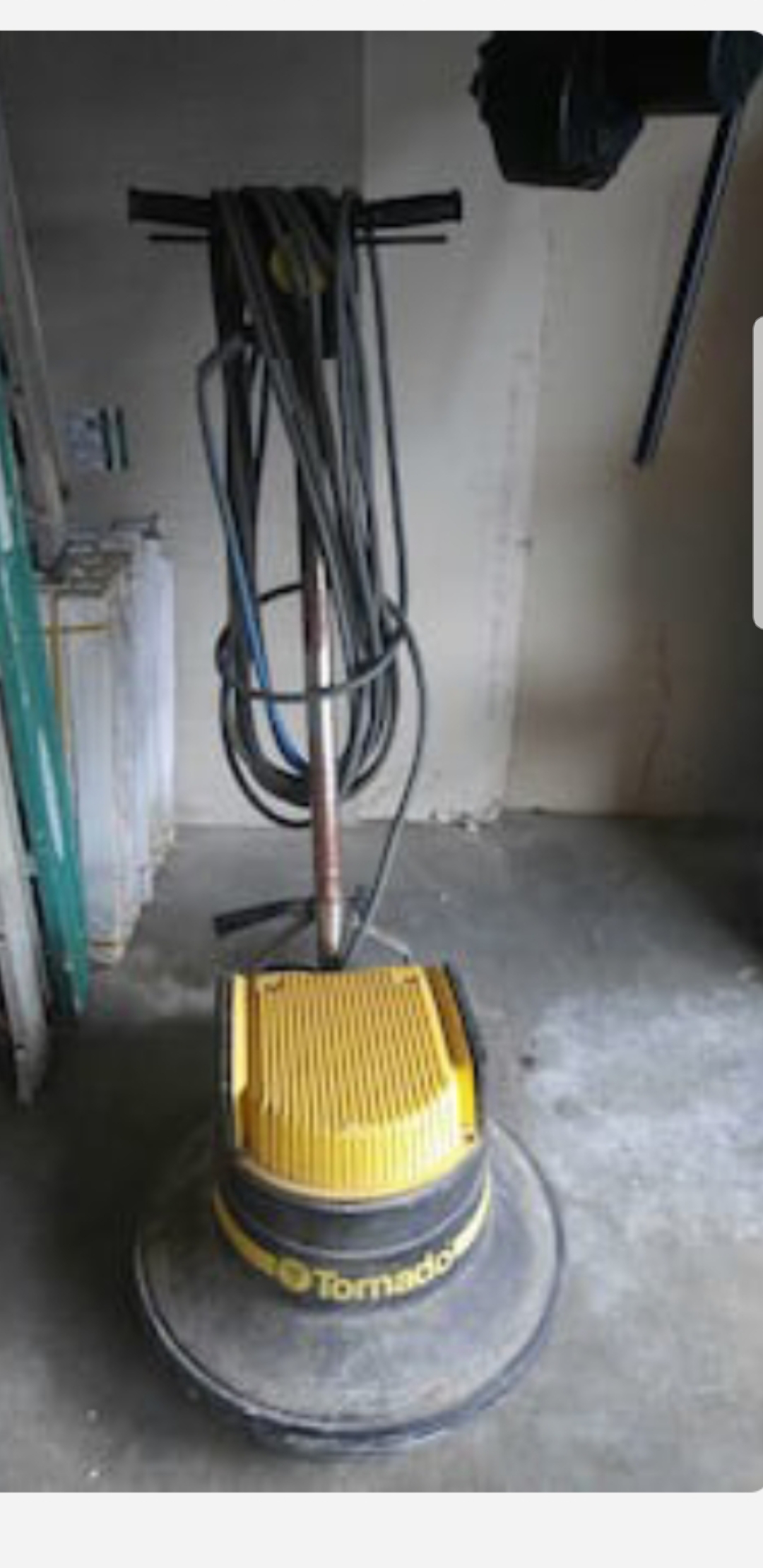

I believe she'll do $150 as Im not sure of situation. But is the Tornado the better of the 2?

Hey All,
I was finally able to contact the guy with the Tornado and picked it up just now. I now have come across another person that has 5 5Gal containers of GEMSTAR Stratus. He said he's " looking to get" $80 for the lot of 5.
Is this what I want to apply? or should I skip it an go with whatever the Supply place carries.

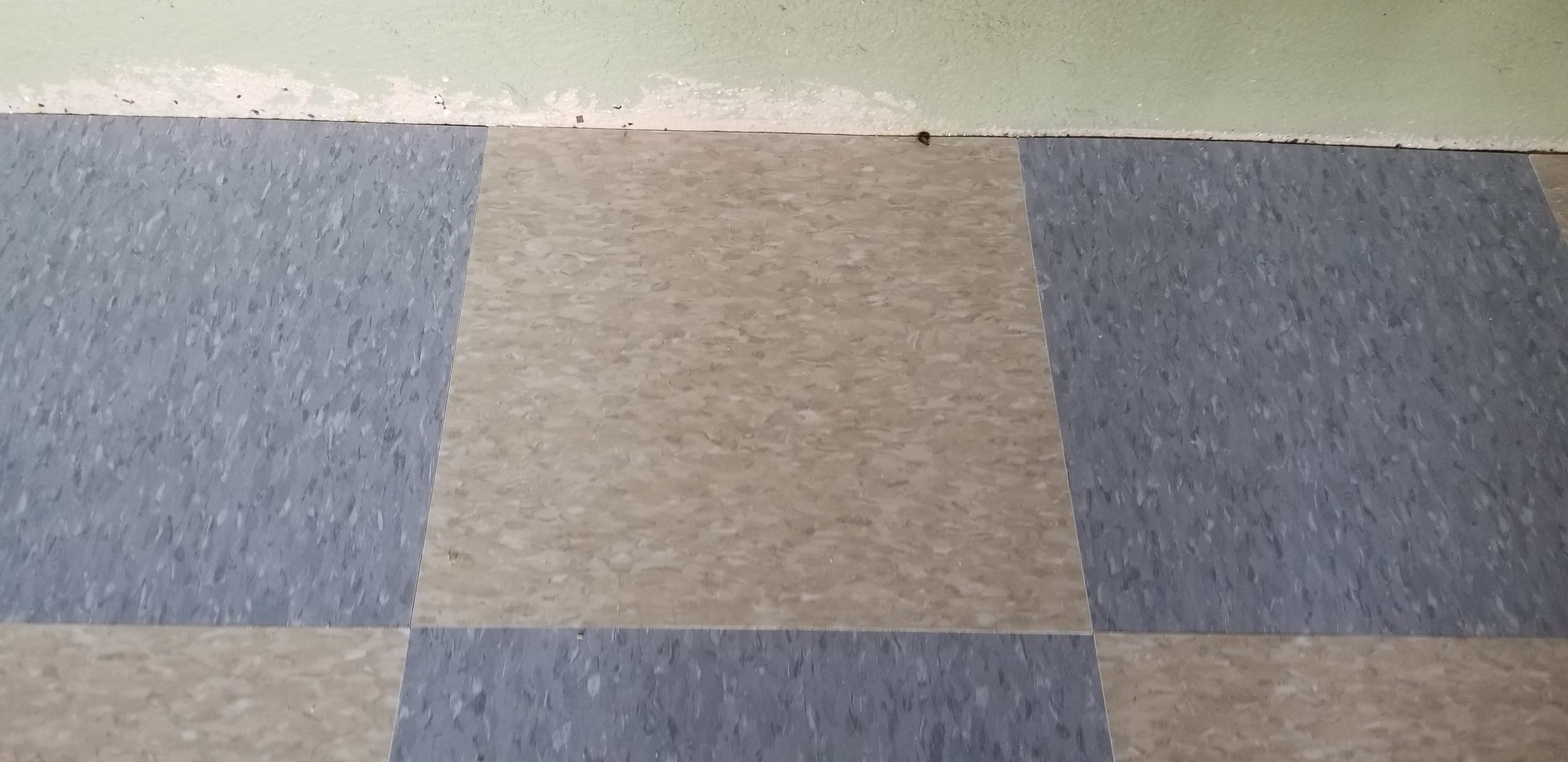

You'll notice that I haven't finished of the front edge of the VCT yet, Because my paver guys weren't paying attention to the pictures that I gave them as to the type of drainage system I wanted. I'm going to replace the cheap plastic one thats there and upgrade it to a larger one, so that it an be properly cleaned when need be

Thanks everyone, nice tip Andy.
Being that I haven't yet decided yet if I'm going to use a rubber cove base, would it be a good idea to squeeze a bead of silicone around the perimeter?
I would cut at least a half inch of that sheet rock off all the way around. Before installing the cove base.
Trust me. Your welcome.
dealtimeman
Everyday is Saturday.
Sep 20, 2008
Michael
If this is your place then do it right.
Allow floor to completely dry before wetting.
Use a light alkaline (diluted floor stripper works well) to degrease and clean floor with swing machine.
Get some floor scrapers to scrape off the glue.
Rinse the floor until the mop water comes out clear with very minimal haze in the water.
Final mop rinse with a light acid,light white vinegar/water Works well.
Use air movers to ensure the floor is completely dry before refinishing.
No matter how clean and dust free you might think The floor is, after mopping several times, it’s not. So you will need to dust mop the floor with a new or washed dust mop.
Order some sealed air diversey fortify floor sealer. Apply at least 2 coats and let dry for at least 2 hours.
Use almost any floor finish to build protection/shine and slip resistance (which is why floor finish was originally designed) apply 2-4 coats using a scale system by marking he floor with different color markers on each coat thus having a visual reminded gauge of how much finish is still on The floor and when it is Time to refinish.
2 days after completeion of finishing you will want to use a ultra high speed burnished and burnish the floor.
EVery 30 days or so mop the floor and clean with neutral cleaner, grab a sprayer with water in it and lightly spray floor and burnish with a hog hair pad for a like new shine(renewed slip resistance) every time.

I do what I call "2 past awesome" which equals six coats of finish, here is why. The first 2 coats of finish you apply are to protect the tile, that is the main purpose of putting finish on VCT. Coats 3 and 4 will give you an awesome shine like your floor looks. Coats 5 and 6 are applied to protect your awesome shine, thus "2 past awesome"

Andy,
I really wanted to, however i was fighting potential rain and daylight, then having to bring everything back inside again.
Question:
Can i apply additional coats, by moving half shit to one side and then coating, then after it dries, do other side?
This is the finish i ended up picking up from my local supply house
J Scott W
Oct 16, 2006
4,061
Jeffrey Scott Warrington
Andy,
Question:
You will have a line where the two halves meet. To to make the line fall between tiles rather than in the middle of one tile, and you will have a pretty good result. Maybe some painters tape to make the line straight.
