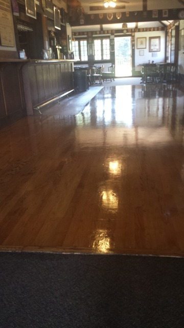

My Aptos house wood is done...
All that work just to let dust, grit and pooling fook up the finish.
Only a floor geeek like me would notice but good lord.
Dont skimp on the most important part for cripes sakes..

Did you coat it yourself?

Looks good Willy. What did it look like to start with?

Will it stay adhered to the old finish? That is not a real aggressive pad to prep with is it? I use Woodstar by Pioneer on some commercial accounts that is a floor finish that can be burnished and they recommend using a black pad. If I were doing a floor with conventional finish I would screen or use a 3M prep pad.
Keep us updated on how it works out, looks good thoough.

Always holds, No prep to speak of other than cleaning it really well.
