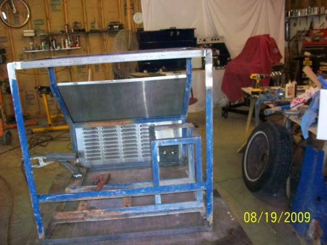

The Start:
very bent up!
much massaging later
finally straight see the new legs

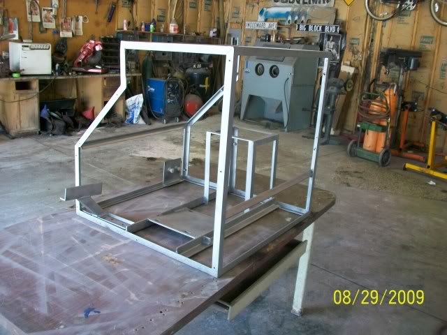

we're getting there..

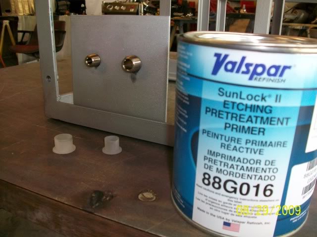

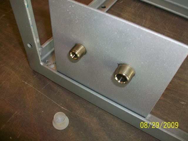

Stainless Steel Hex close nipple fitting welded on...
first it'll be primed wit the sef-etching primer..followed by the 2K epoxy
ready to spray!

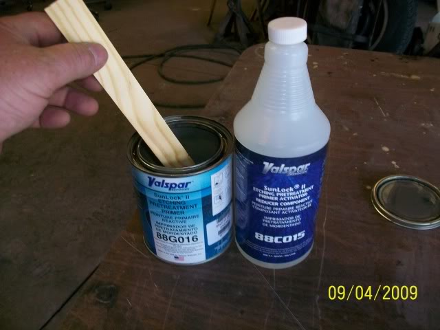

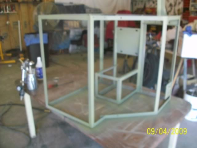

Next comes the TWO PART self-etching primer....this stuff is pretty much bullet-proof........
as you can see it dries to a GREEN color.....
next comes the two part Epoxy 2K primer after this....
Who do yous guys think yor dealin' wit here....
