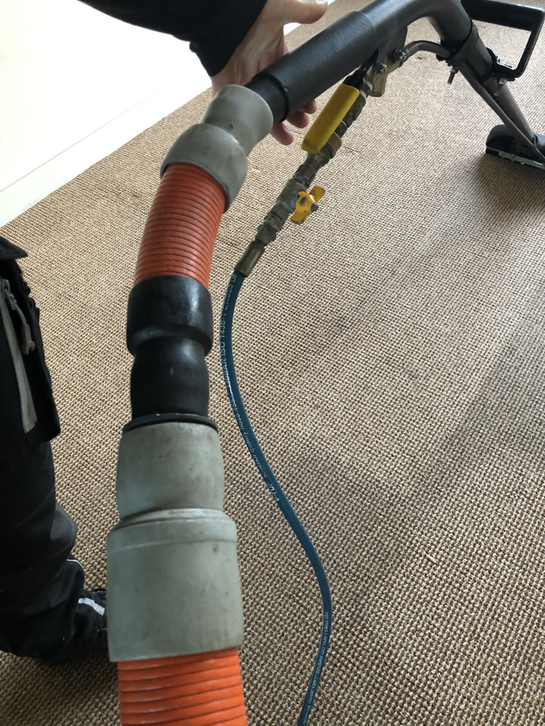

I use a 10 foot whip flexible 2 inch hose right up to my 1 1/2 wand

So 2.5 to 2 to 1.5 makes sense?
Brilliant! 🥴
Why not try 1.5 all the way to the truck. Its easier to handle. 🙄
Not so funny....
We did a job last year, and there was a resto company in the next building. He WAS running 1.5 all the way....IDK how long his run was, but I watched him peel off at least 100’...
I’m sure that carpeting was really dry by the time he finished...
