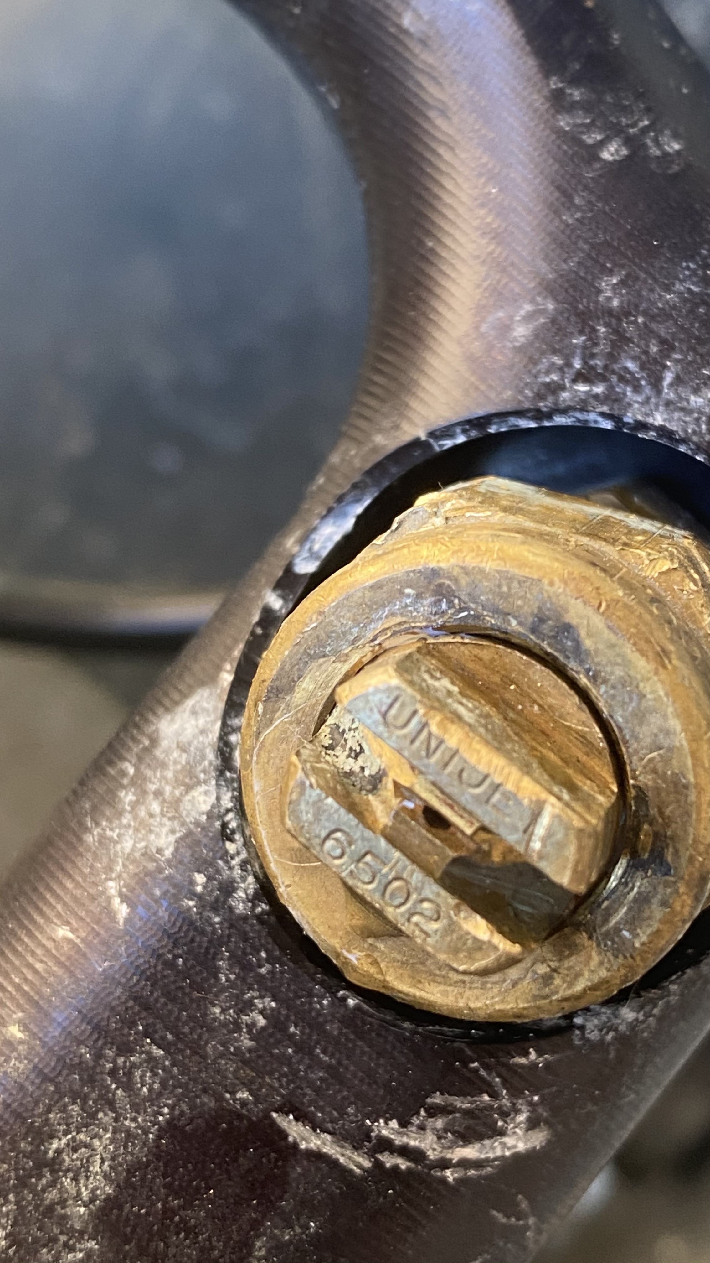

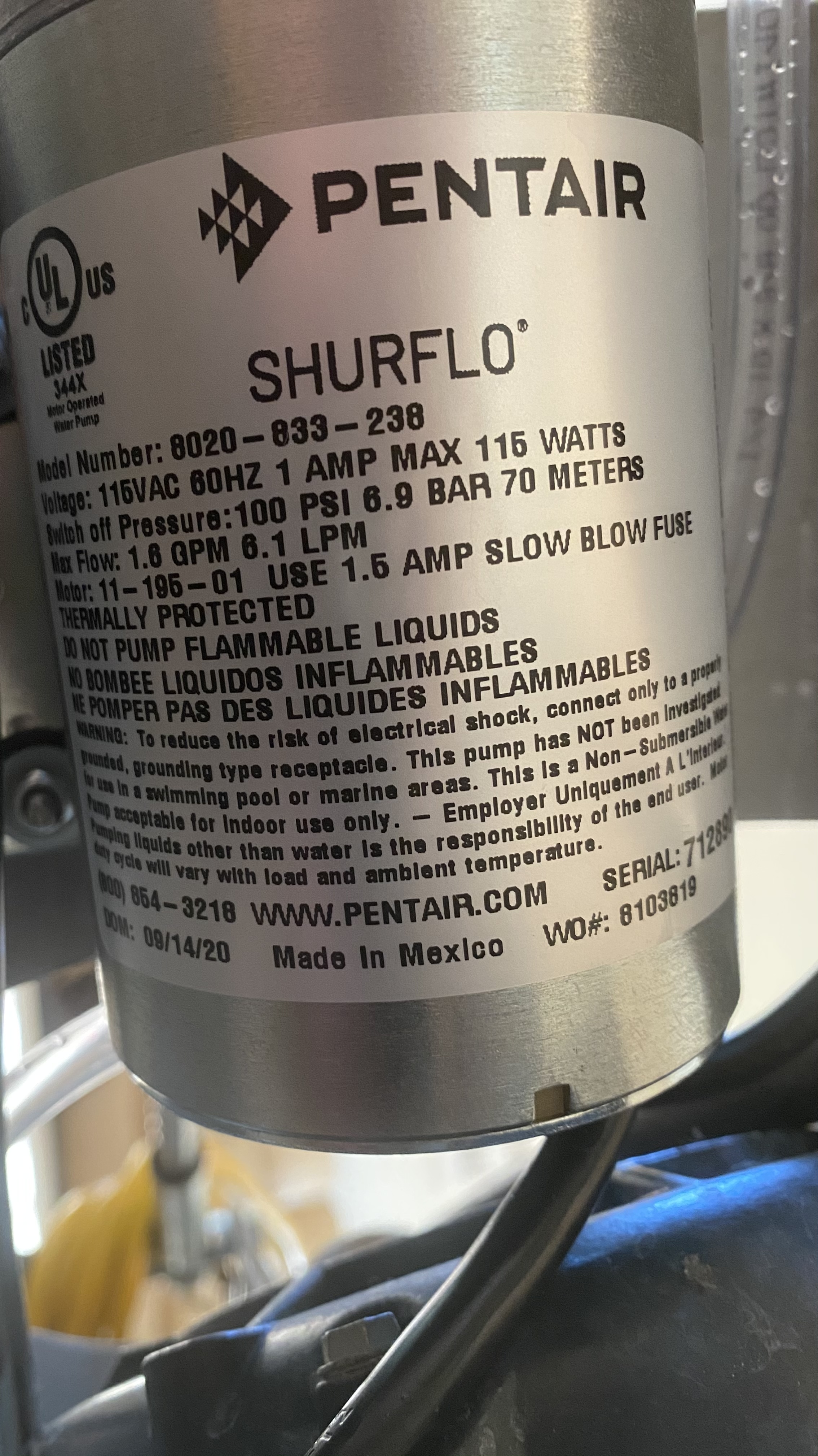

Here are the specs of the new pump and the jets.
The jets are two 6502 Unijet. The pump is a 115 volt 100 psi. The original was a 90 psi.

thanks, it looks like 02 jets is common
the 2 small jobs I did had cut pile and though it looked good I wasnt sure if was putting out enough juice
