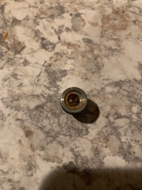

If you are running ANY peroxide based cleaner through your HF, whether powder, or liquid, you WILL blow the seals on the spray gun, and it will leak….(kinda like old man drippy d…,never mind).
Probably exactly what caused the problem you were inquiring about it on your other thread.
Don’t ask me how I know.
Yep, thats what happened. But now I just dont close the cap tight on the jug so the pressure does not build up.
If you are not rinsing the dema valve out of your HF after work each day , and you keep using said product, it will just keep happening if you continue to use peroxide based products.
I keep a hard, 2 gallon jug filled with plain water for just this.
I’m my last job, I pull the HF setup out of the container, put the acorn and short hose into the plain water, and spray for about a minute into my vac line…
Haven’t had an issue since doing this…
The peroxide will continue to eat away @ the seals and steel inside otherwise overnight.

i did that every week but looks like I will have to do it every day. From the photo it looks like you are spot on.
Thank you for the advice.
