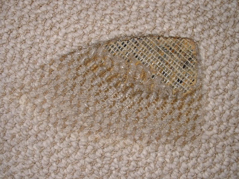

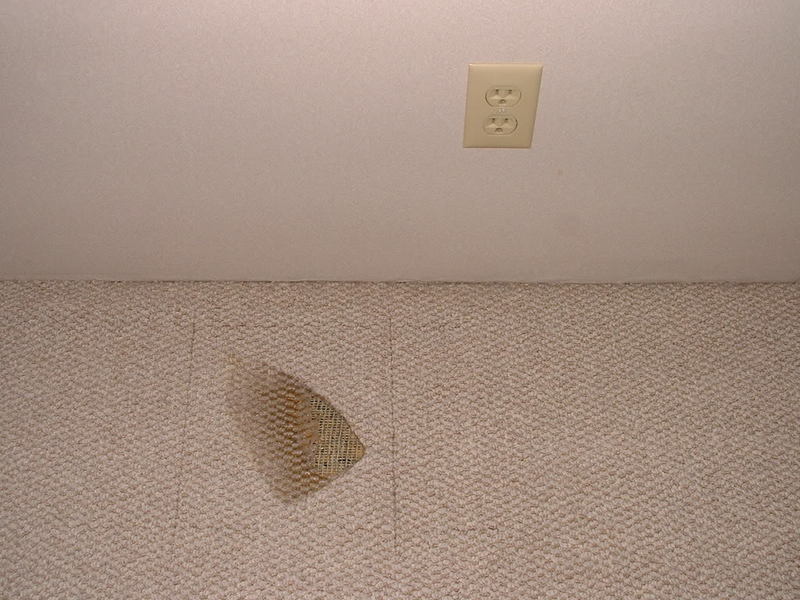

Here is one room that had two 'Iron Burns' one moderate and one 'severe'. There was also damage along an edge that was repaired.

severe iron burn, so deep even the pad was burned
Here was another burn but much less damage

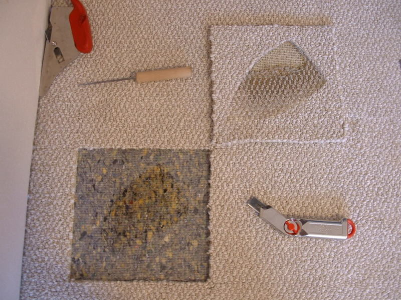

removing one of the burns

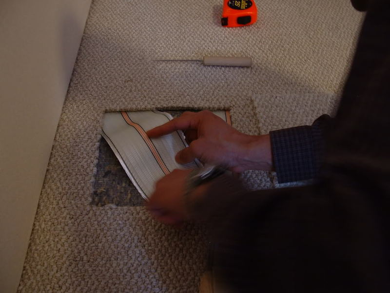

setting up the repair

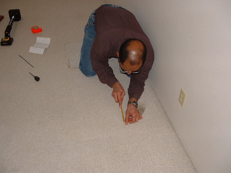

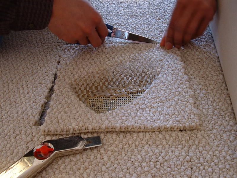

cutting out the donor piece

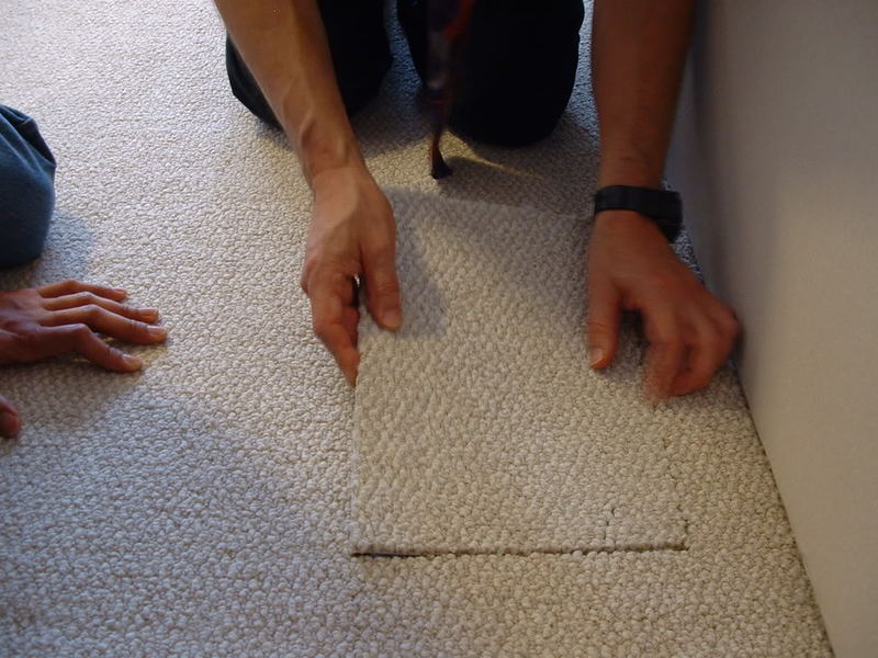

being sure it fits

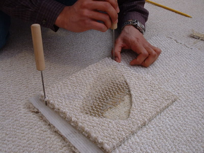

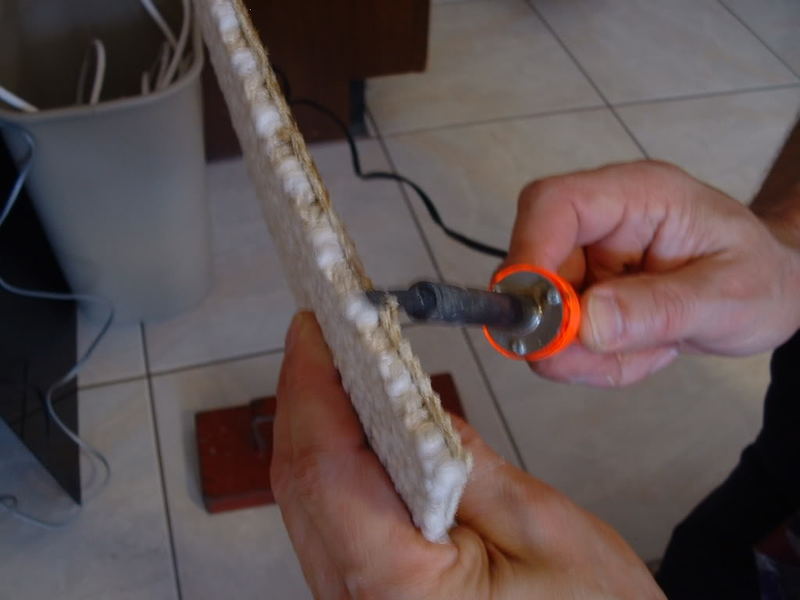

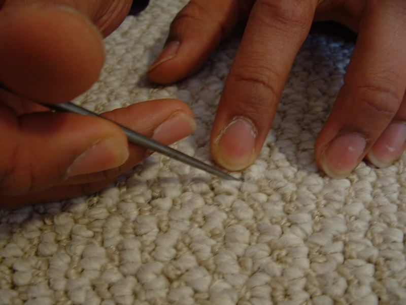

detailing the donor piece for a precision fit

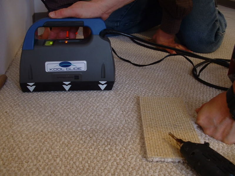

using kool glide after sealing and securing all edges with a glue gun

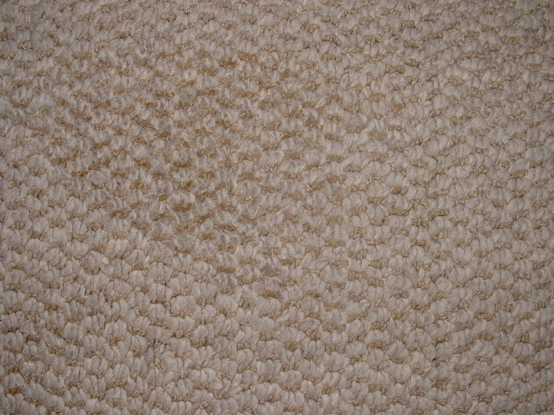

Final details

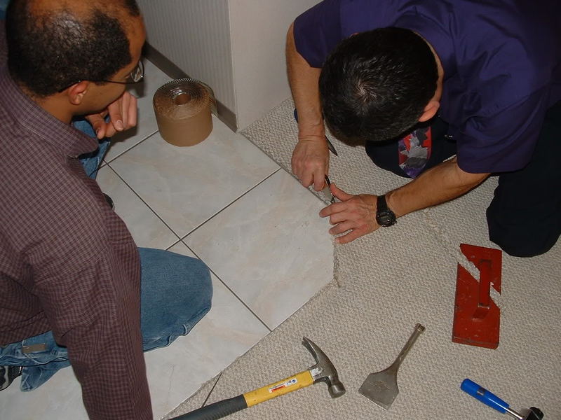

Repairing edge damage

You mentioned in the one caption that you sealed all the edges with a glue gun, Doesn't the the solder iron do that on the donor piece? Why not also use it on the main?

I use both but I prefer the longer shear for cutting between rows as a general rule.
John,
While the edges will get sealed with the hot knife, it is used to bevel the edges and make it fit much closer. This is something few will do but it will give such a precision fit. The glue gun will make the edges very tight and will allow a close fit when rolled. The added heat will allow for a little 'extra' manipulation and keeps the seam edges from 'hinging' and helps to hide them. As seen in one of the photos, the edge is very tight. Then, when the Kool Glide is used, it melts it all together and fuses everything into 'one' piece. Just the way I do it, it seems to work very well and does not come apart.
