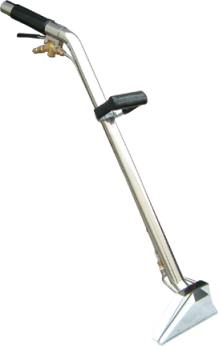

Larry Cobb
5,795
Dallas, Texas USA
Larry Cobb
This is the stair tool that most of my customers use:
29" long; 10" wide head
Larry
