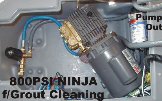

Here's a Ninja we built for High Flow & Pressure with Pump-Out.
2.2 GPM @ 800 PSI

Larry, that looks pretty sharp, what vac motors are you running on that unit? How many amps does the 800 psi (general?) pump pull?
Can it hold a steady 800, or are you getting more or less from it?
What size jets in the spinner tool?

The pump & motor hold a steady 2.1GPM @ 800 PSI.
Several of them have been in service for about three years.
Most have one 3-stage and one 2-stage to operate on 15 amps each circuit.
One has two 3-stage vacs which requires 20 amps on the main circuit.
