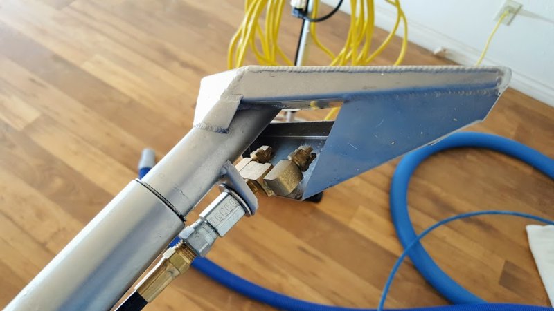

This is a Ti version made with two jets because they like me.
I used a 15" 2-1.5 tapered vac hose.
I hardly ever see stairs out here in Ranch land but I'm finally getting a hang of this thing.. I likes it!
Jimmy, youz a MORON.
No way do you need a 2" tube on this thing, It screams louder than than a stuck Marty.
Want better dry times?, do a third dry stroke.
Odd shield thingy. :headscratch:
Personally I wouldn't want a swivel and can't go back to 1.5 8nch tools. We don't use or carry a whips, our whole team is used to 2 inch.
Not saying you're wrong. :shifty:
Next! :winky:

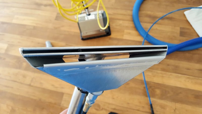

View attachment 20020 View attachment 20021

in the video...the spacers I took out....I RECCOMEND KEEPING THEM IN.
Seemed to do better and better spray yet....
And the loose head is fine in this case I would say...easier to flip....
(and I honestly like the 1.5 inch on a stair tool as well.... :) )

I like the splash guard Tom, it also helps keep the slot at the correct level.
The hose is an inch too short though.
I wonder if that was why I hated the swivel

Sorry Mark, but the critical part of the stair (the nose) is not really being cleaned.
Makes sense, once you look at the jets' angles due to the length of the tool and not being able to bend following the contour of the stair's nose.
That's always the worst part of the stair. Due to ground in soil and wear. It is also the area most susceptible to wicking.
Unless you get it cleaned well (in close and personal:winky: ), sorry Mark- No cigar.
Pull it over the nose like any other wand as needed....
Use the cuff to extract any excess...if still soiled...hit again.....
No really problems....actually faster for now.
