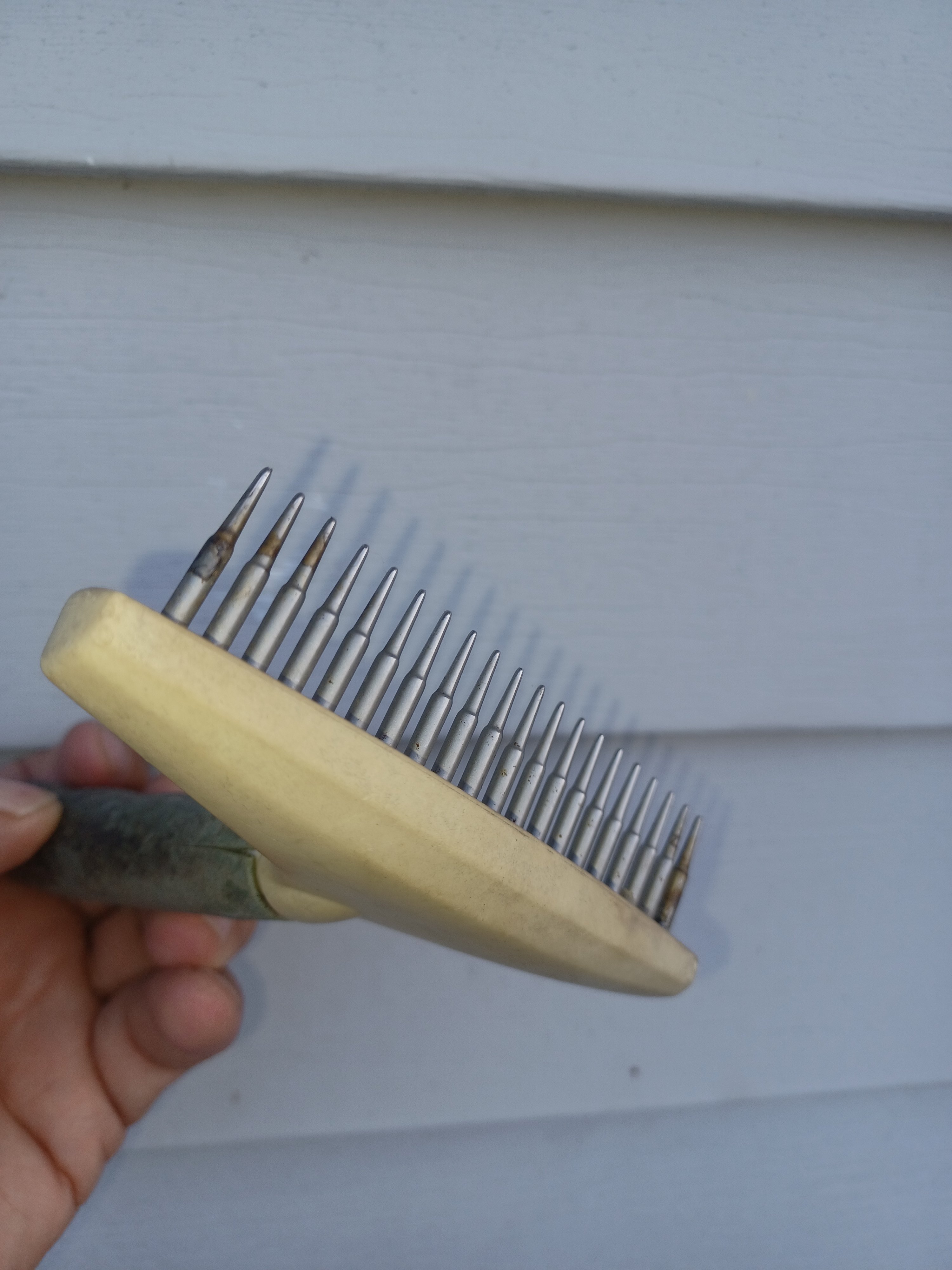

How about this baby to "FLUFF" up beaten down olefin on stairs? 😛
dog aggressive desheder.
Don't laff, tried it! Nope! LOL
