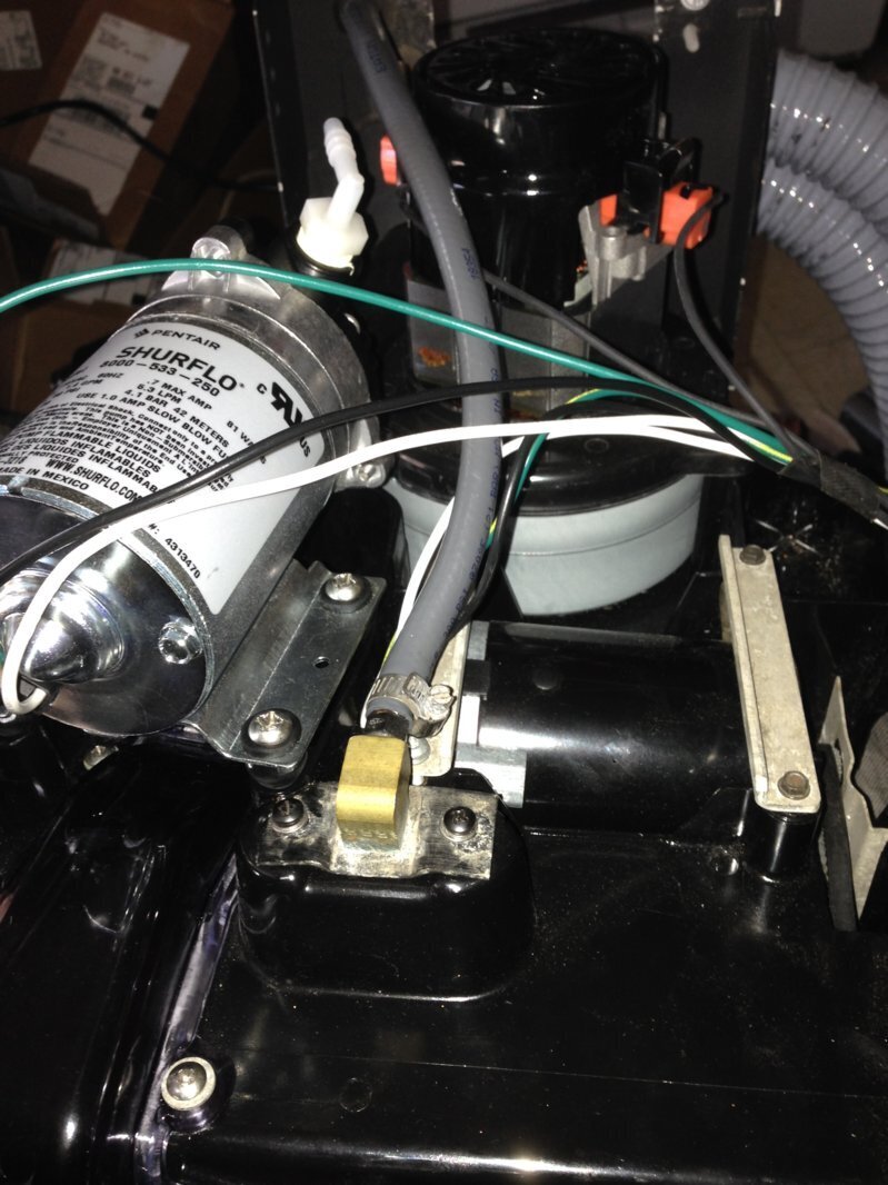

ok I have been out here for months getting involved and picking people's brains, I rebuilt an EDIC fivestar, new vacuum, new base, new brush, new pump, still has some older parts and I have checked best I can the nozzle seems clear, the pressure lines are not great but for some reason I'm not getting the flo I get in my other EDIC units, the clear top shows the soapy water, but not a lot, how can I test the volume. How can I check the volume. Only used it on an area rug and it works nice vacuume wise, but not much solution. Don't see any kinks. I'm going to check the pickup screen on the feed line, I did add the stop valve on the attachment line

Sureflo 45psi
It's a ball stops the solution from running out
I can find problems
It sounds great could be the pickup
Def needs a cleaning
I'm going to try the 1 min test

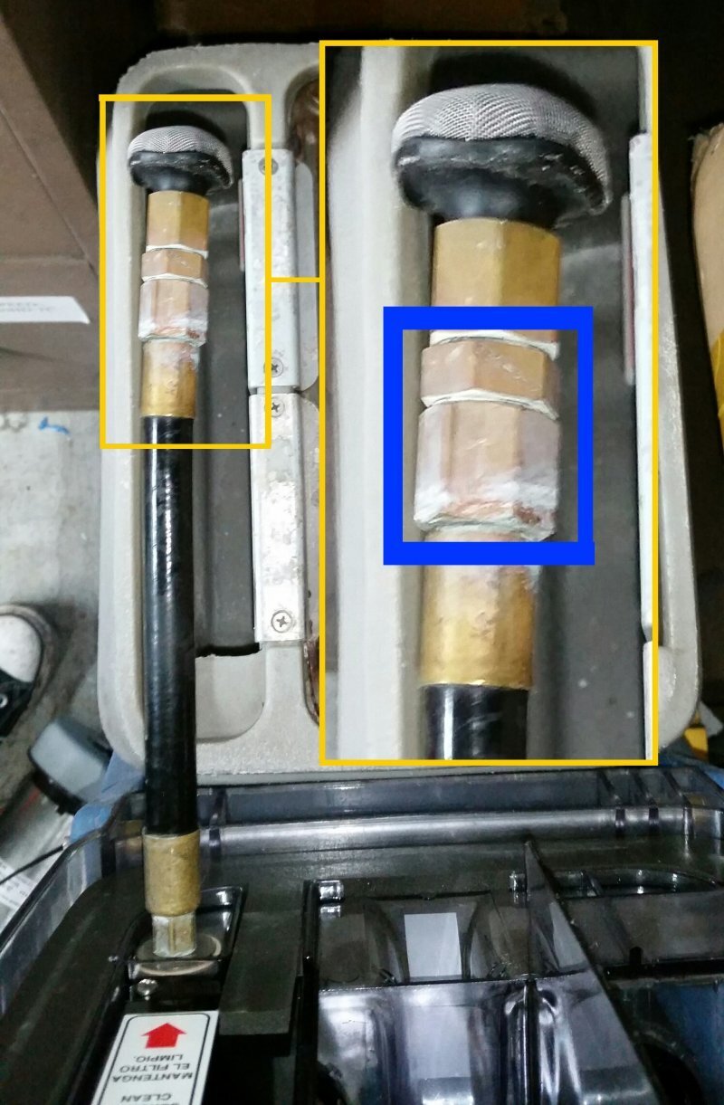

The check valve is new

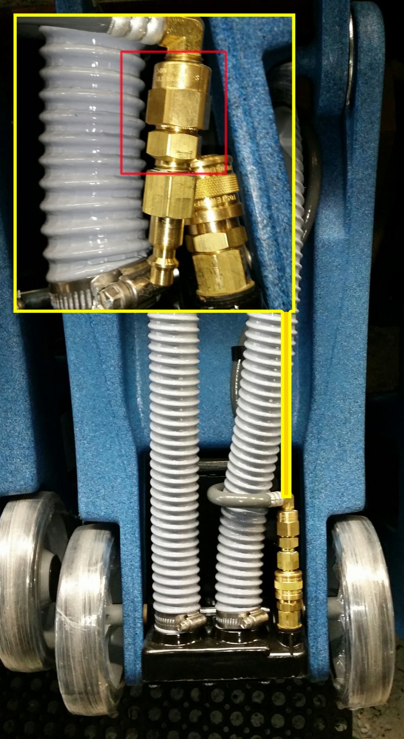

This is not new on mine
I don't have the valve in the blue box, has to be here, everything else seems fine

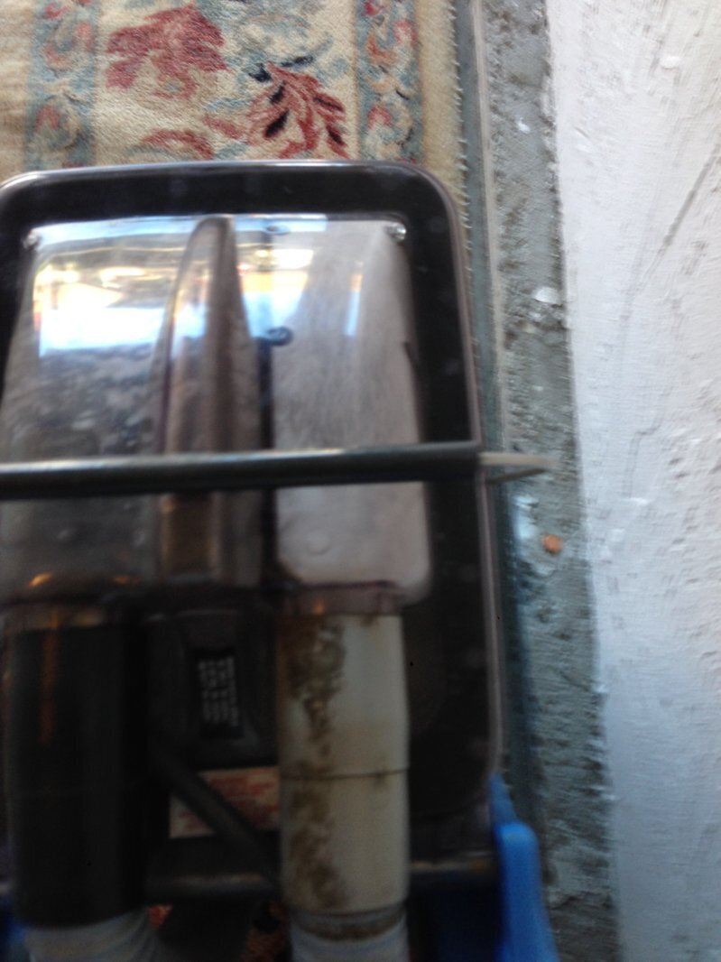

It's great suction, it lifted the carpet off the floor, the dome is not showing the waste water at much volume to another unit I have it's a new pump, I'm sure it's the feed hoses, there crap 1997.

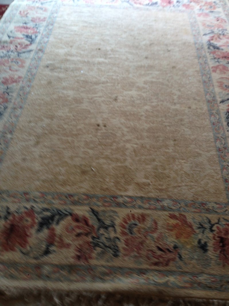

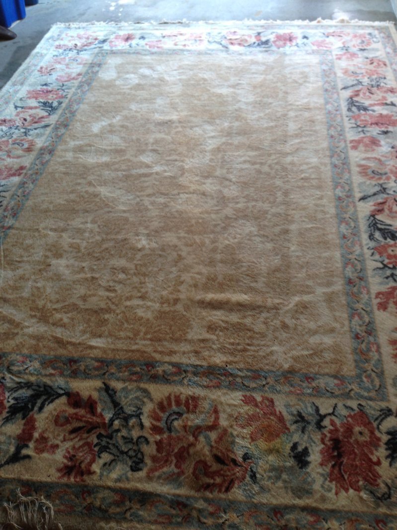

Here is a before and after
