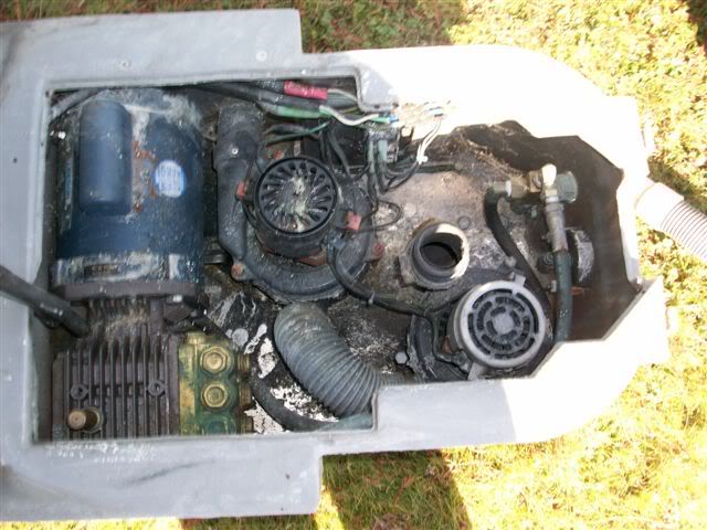

Base- General pump, dual 2 stage, on HP, one normal ( Singed, but you get the idea)

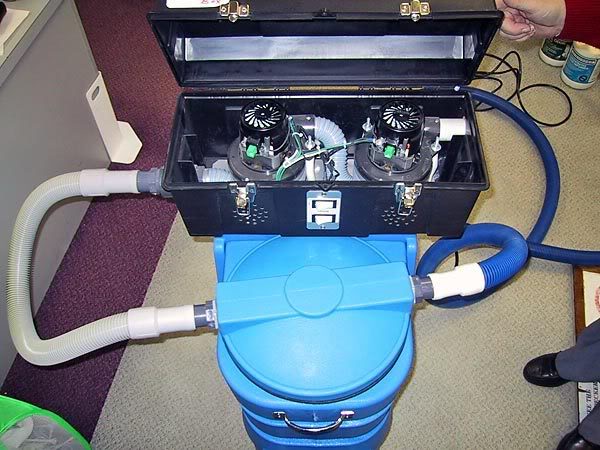

Vac booster. This came from KleenKuip. Same vac configuration, both in series. You'll have to put another vac barb on the head nut you suck dust off the moon. :wink: . Talk to Larry Cobb to get the parts to do this or Ted at Kleenkuip.
PM me if you need any help.

Mytee also developed a nice inline booster to help if needed on any long runs. This is the setup I will be buying soon. You can run it from a van with a generator, or bring it upstairs if needed. Since I am in NYC, I need a versatile setup to start my business with. This video may give you an idea of it's power, although it is a 1003dx, it uses the same high performance vac motors as the M-5.
