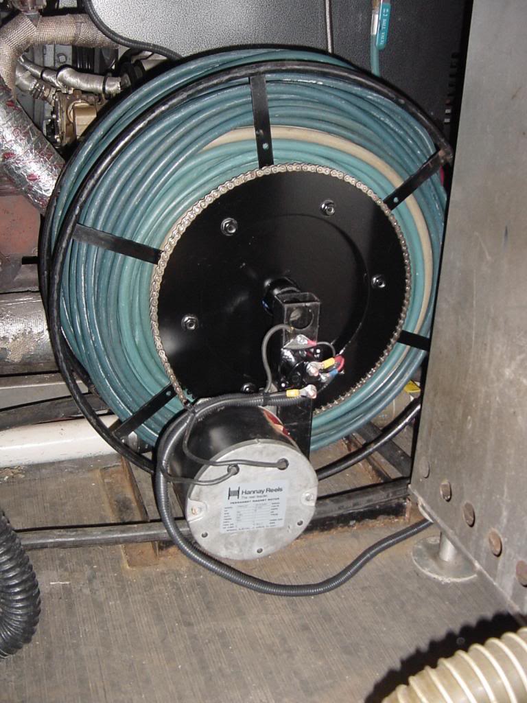

It's about time I got 1 of my hose reels powered. My best friend finally had time to weld up the bracket to my hose reel to mount my motor and tension plate. I could have just screwed the bracket on, but I rather have something more solid.
Got the parts from http://www.hannay.com/store/10Browse.asp with the help of Keith aka Able1 on the boards. Now I just need to get it mounted in the van. I also want a foot switch instead of a push button so 2 hands can be used as I run 2.5" hose.
I can post a parts list if anyone wants. The total was close to $500 with shipping I believe.

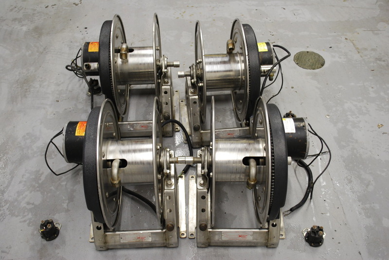

I have two sets of Hanney Stainless Steel 12 volt power reels for sale. They can be wired directly off the truck battery, they have their own relay. They cost $1000 each new, I am selling them for $1100 per set. Call me if you are interested (814) 931-6919.DSC_0322_zps9nejxg9a.jpg
