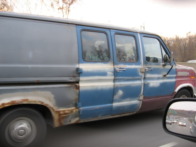

I saw your van going down the road the other day and snapped a quick pic.
Doekilla was driving fine, BTW.
not reckless or speeding, but tell him to cruise in the RIGHT lane so i don't have to pass on the right side.
PLUS..when that POS van breaks down, he won't have to coast to the left side medium
...L.T.A.
