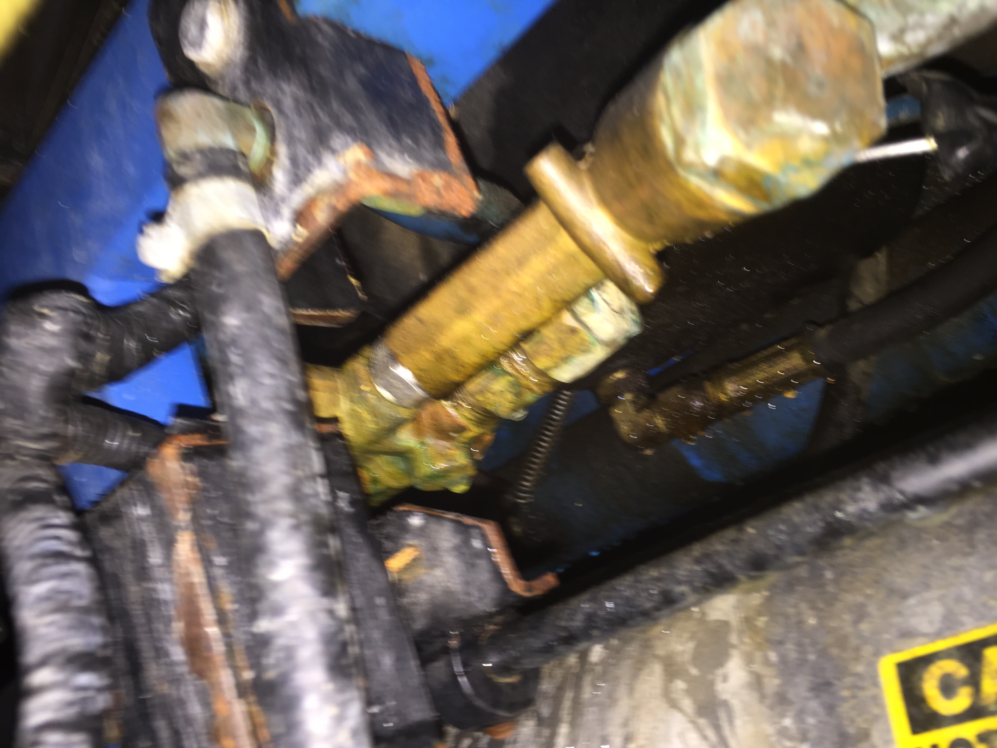

It's leaking underneath behind heat exchange above black back hose in photo like a water fall can't see actual break

Not your return line from the bypass. Probably just a blown high pressure line. Maybe coming down from the helicoil. Could also be the line to the bypass solenoid.

The path is:
Pump
Regulator
Graham hx
Exhaust hx
Manifold
Hose between each.
You said leaking like a waterfall so I thought not the small lines from solenoid or manual divert valve.
The line I first mentioned empties into the waterbox. It is heater hose and will blow if subjected to full pump pressure.

I think it's the helicoil line because it runs right through were the flood is coming from

I dont know they fixed hose replaced a coolant hose that was olld and charged me $275 with a few brass fittings.

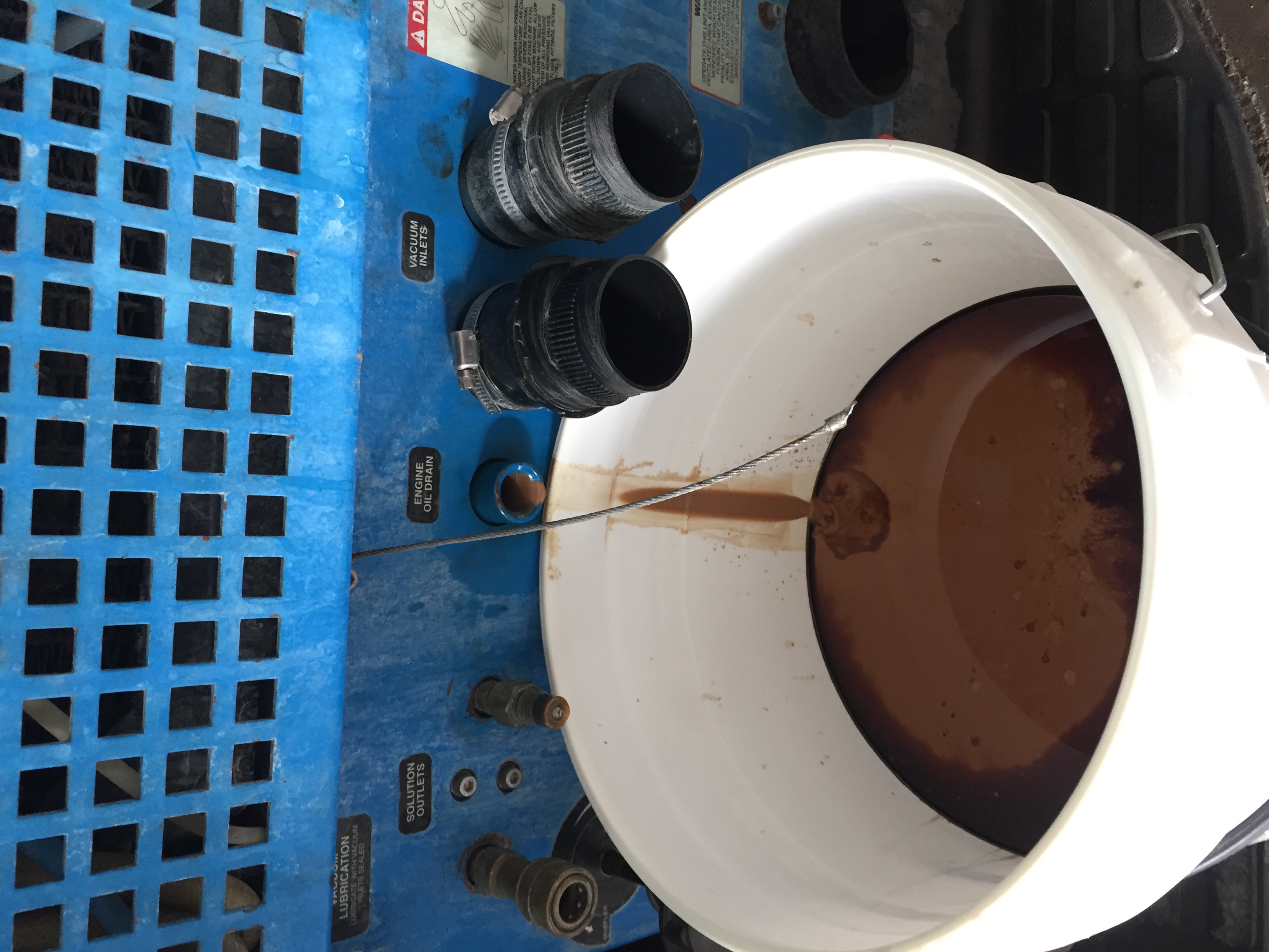

I pulled spark plugs, drained oil and threw out oil filter and I got 3 gal of sludge in a bucket letting it sit for a few days then new spark plugs and an oil change. Anything I'm missing????? I was told I might have to do the oil change 2x to get it right

Get it running as soon as possible to heat up and boil off the remaining water. After running it for an hour or two I would change the oil again and call it good. The main thing is not to let it set with water in the crankcase.

I would run it with the original plugs until the final oil change unless they're completely gunked up then change them. But I would do so only once either way.
