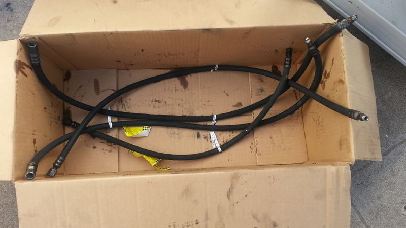

PTO hoses on your VAT..
116,030
is your Vortex or AT getting on in years?
do yourself a big fave and spend $200 and replace the 4 hoses coming off your PTO solenoid/transmission
if they go it will be when your in the house sucking away and by the time you figure it out the drive way will be covered in tranny fluid and your 10k transmission will be ca ka ca ka lunking away...

also, when you order a new pto it comes with new hoses too.

hi Mike,
do you know the psi and temp rating of the pto hoses. i am going to get a set made up and was wondering?
