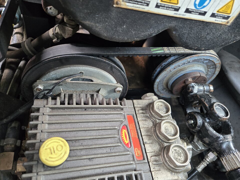

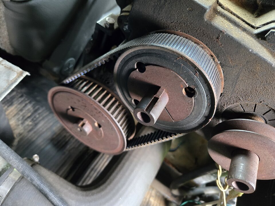

I replace my idler pulley every time I replace my belts. I also pack it with hi temperature grease.
Sounds like a bearing gone dry in your idler pulley.
There isn't an idler pulley on this machine. The drive shaft has 1 pulley in front of the blower that turns the water pump, and another pulley behind the blower that turns the blower. So 2 belts and 4 pulleys in total.
I can't see any wear on the belts. The belt that powers the blower feels really loose compared to the one that powers the water pump. I don't see where these pulleys can be adjusted in or out for alignment, unless the whole blower is moved to do that...

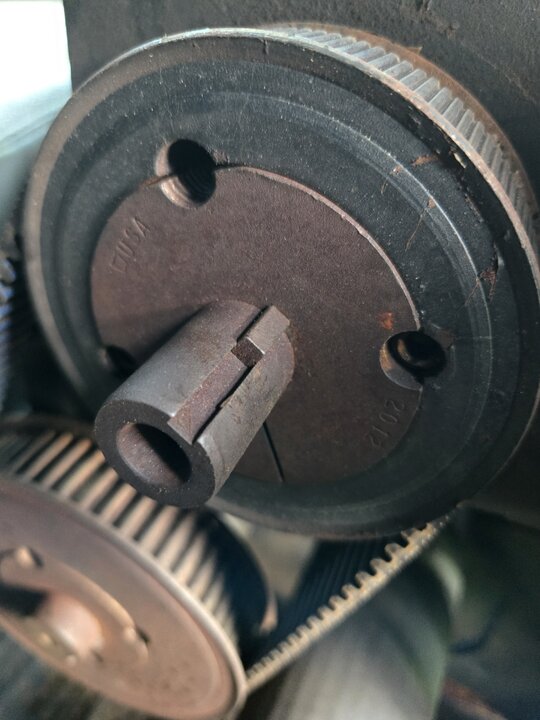

The belt attached the blower pulley is running off to the left side of the blower pulley. I can't see any wear on the sides of it though. It seems really loose though, at least 3/4" of deflection. Any tips on how one would adjust the alignment and tension on that pulley? I'd rather not unbolt and adjust the whole blower to do that if there is a better way. It doesn't seem like some automotive pulleys that have a threaded shaft that allow the pulley to be pressed in or out...

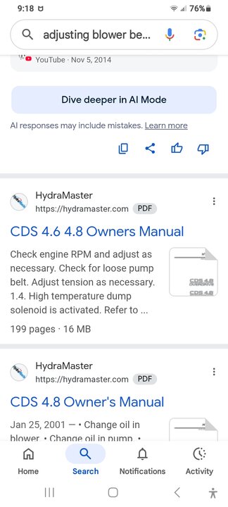

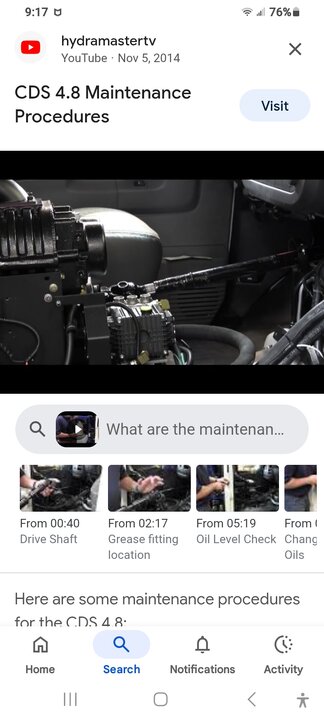

If you haven't already maybe download a owners manual also theres a few long youtube videos on maintenance
View attachment 131608 View attachment 131609
Thanks Dwain. I have read through the manual and it describes how to do an oil change and daily lubrication for the blower, importance of cleaning the filter screen and avoiding foam, and troubleshooting things like low vacuum. But unfortunately nothing about adjusting belt alignment or tension, or anything at all about the belt.
I had watched the Hyrdamaster maintenance videos once before and don't recall seeing anything about that but I will watch them all again. I searched extensively on YouTube and can't find many repair or diagnosis videos on Hydramaster CDS machines either.
I don't know what caused that scratch on the backside of the water pump belt. The aligment and tension of that belt seem much better than the blower belt. But I don't know much. I'll run it this afternoon and see if my stethoscope will tell me which side is louder. Will a squealing belt like that typically just wear a belt our faster, or might it do some greater damage putting stress on other parts?
