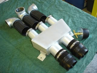

On older vortex (pre-2.5" set ups) we send out this "Vanifold", you remove your stock plastic tank elbows and filters and connections, and screw these three 90º fittings on the tank (yes the third unused port too), run a few feet of 2" hose from all three ports over to the 5 port vanifold, and bolt it to your hose reel, or run the hoses through the floor and bolt teh vanifodl under the truck. The use of some black CoolCuff parts keeps the diameter of the hoses large, it's an amazing increase even for a Vortex.
