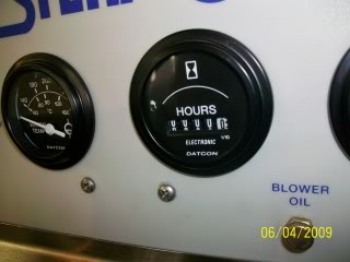

I thought I'd post pictures here to show the degree we go to when doing a reconditioned system. Note:
  • * New gauges
    * New plumbing
    * New belts
    * New Idler and Idler adjuster
    * Refinished face plates
    * New wiring
    * New exhaust and muffler
...In addition to new paint.
The pictures speak for themselves, I think. (And, "Yes", this is typical of the extent we go to on a refurb.)
This "Hammer" system (designed by me, originally built in 1998) was delivered yesterday. Originally they were built with Briggs Vanguard 18's. This one had a Kohler 18 from a Prochem (I know, the breather cover says it's a 25...) we tore down and parted out.
In the demonstration for the customer, it delivered 250 degrees of constant heat, with the trigger held open continuously, at 600 PSI, through a wand with (2) #3 jets, at the end of 150 feet of hose... measured at the wand.... for a 15 minute period. (Of course, that temperature is fully- adjustable from ambient to maximum.)
It sold for $4,500, plus installation and included a 90- day warranty, as all refurbs do.

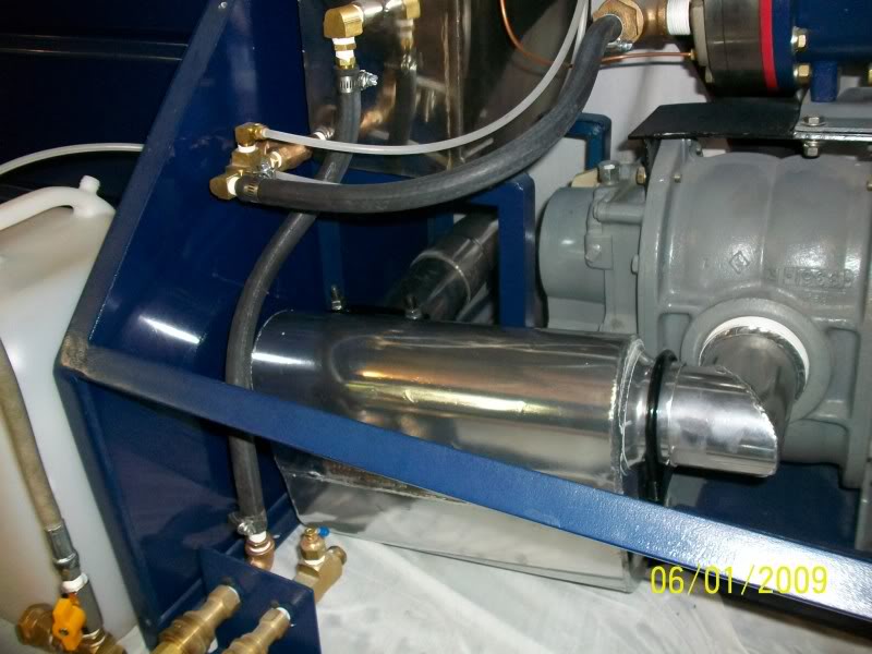

Duane Oxley
Ron Werner said:
The blower exhaust. Does it do a U turn? Why not straight down and then T into the mufflers?
Ron:
Yes, it does. It does so, to allow more length for longer mufflers. The system in the picture used two "Thrush" mufflers. I did that in order to see how well they would do, compared to the ones I normally use. The Thrush ones are considerably shorter, but I had the system ready to change over to the longer ones, "just in case". In truth, that particular system was louder than I wanted. But it wasn't outrageous. But setting it up the way I did, I had the option of swapping them out easily, if desired.
The blower exhaust tube, by the way, is 3" square tube. Except for the inlet itself (which uses a 45- degree deflector plate internally) it has no hard 90- degree turns, but uses (2) 45's instead, making it more like a "sweep", where it turns, except where it spits into the "Tee" and both sides of the Tee are also 3" square, with 2.5" tubes for the mufflers (which are ported at 2.5" each, in and out) to attach to.

Duane, the mufflers look awful close to the vans floor and could cause heat damage.

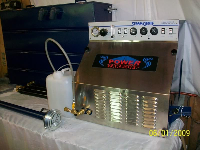

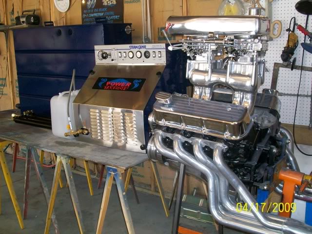

Bawb that 454 650 hp is overkill for dat SteamGenie. See ya in Vegas

Duane Oxley
You have good attention to detail there... They look closer than they are there. They weren't all the way "on" and didn't have clamps on yet in the picture.
Also, keep in mind that because there are two of them, they actually run cooler than if there was only one. There's a lot more surface area with two to dissipate the heat.
But they were closer than I wanted. On the next frames, they were raised up an inch.

Ron sez:
"Bob, your blower elbow looks a little restrictive. Nice weld, but too sharp."
you'll havta blame Steam Genie R & D....that's EXACTLY how they built them....and no it poses NO restriction at all......it's Stainless and required a TIG weld!
may we see some of YOUR projects.......
Ron Werner
8,726
Ron Werner
If I put one together from scratch, I'd be using all the latest tweaks we've learned, copying the good things I've seen on the Big Red and the CanAm, and other machines.
No 90's unless 3" min and sweeping, keep the air moving with minimum restrictions.
Every machine will have something that could have been tweaked, in hindsight.
