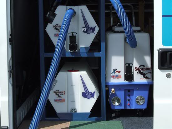

Are you telling me that the owner of this "unit" is using the resoil to create vacuum ini t's tank AND that top waste tank?
AND he is running hose from the van into the house?
Come on Fontanot, I see you over there kissing Ed's ass, tell/proove to me this system can recover more than 20% of the water used and I'll pay for a new head shot for your website.

200 feet from the reSoil with 55 gallons of air to fill with vacuum from 3 lamb vacs??
How about 2 lamb vacs and 180 gallons of air? :shock:
Even Ken Wainwright on those UKs boards admit hooking up a Recoil to a 55 gallon tank dropped the performance. If I remember correctly, he said it was like you were cleaning with another 50ft of hose.
Savage and Greenies pimped M5 have the right idea with the small tanks and APOs. The savage is about 5 Gallons.
John, Ron pulled that quote of the UK board. That was a Scorpion with 3 3-stages.
The lift on the Recoil is between 99" to 117" depending on how that tiny third 2-stage affects things. I believe but have no proof that that combination will reduce the static lift to 99". Ed tries to make people believe on the Recoil board it has 150". Then he gets mad when John calls him on it. :roll:

Since CA has a 40 gallon tank as pictured above and you guys to seem to knock these tanks why did ,John Lebarbra Double his tanks to 80 gallon.
John What are your tanks for to run the distance as well or to have your porty at the door with 80 gallons of fresh . Im not being a dick just want to why yur tank is double the size of CA tanks and no one has said squat about mytee.... I would have thought you would talked about your new tanks in this thread maybe with yur explanation of how your tanks work . Just seems like All you guys are haters of CA ,and Mytee had done the same thing but im not hearing any feed back on mytee tank

Hi Erik,
That is a fair question. If you go to my web site you'll see I market my tanks as TM tanks. They were made to replace corroded tanks. They will last longer than aluminum and are less expensive. I didn't build them for portables but some one could use them that way if they want to. I put auto fill/pump out on many of my models. However, the larger the vacuum tank the more cfm and water lift is needed to displace the air in the tanks quickly. Positive displacement blowers (like Roots) are the best for that. This is the same problem running a long hose from a portable extractor has to deal with. While you can run 200' of hose off a Rug Doctor, it doesn't mean it's a good idea. Portables perform the best when used within their limitations. Trying to play TM with current technology is not taken seriously. Savage and Brevik come the closes to the target at his time. That's not to say we aren't getting closer as technology improves and I don't fault anyone for trying. (including Ed Valentine)
I don't know Ed, he may be a nice guy. My only issue is that he purposely conceals pertinent spec's (like water lift and total amps on a cord) that perspective customers have a right to know but don't know to ask. Any other manufacturer will readily provide such info when asked. Only CA won't. It isn't a trade secret as he puts on. Whether Ed sees it as pertinent or not is not the issue. Manufacturers are accountable to the industry whether they like it or not. You, inadvertently, posted vacuum lift in err, Ed never posted a correction on that board. If you recall, I only asked how you arrived at those numbers, since I know enough about vacuum to know they were not correct. If you think his machines are a good value, and don't care what the spec's are, go buy it. As the economy worsens, we are all going to be better shoppers, and wanting to get the best value for the dollar. I've have always said to shop and compare no matter whose machine you buy, and that includes Mytee.
This shoot out at Mikeyfest is not to negatively compare one machine to another but instead to have a comparison chart so that PCC's can make an informed choice. Is there anything wrong with that? My question is why isn't Ed for that?

Are you telling me that the owner of this "unit" is using the Recoil XPS to create vacuum in it's tank AND that top waste tank? AND he is running hose from the van into the house?
Yes
Come on Fontenot, I see you over there kissing Ed's ass!
Really was he enjoying it?
Tell/proove to me this system can recover more than 20% of the water used and I'll pay for a new head shot for your website.
Why; I don't sell those Machines; I just use them !!
Sorry Mikey; I can recover a lot more than that; And kissing Ed's Ass; well I am not sure of your meaning; maybe I tell everyone of my great experience with the Recoil 3 XPS 500 psi machine. And why does it concern everyone so much on the Recoils performance; I hear none of the owners complaining. And as far as the manufacturers are conerned; I praise them both on there products which I happen to use. Although I seems to post more on the Recoils XPS 500 psi machine a lot; I also post a lot about Mytee's Hot Box and Turbo. And will continue to do the same.
Now as for your head shot proposition for my website; I really ain't into that homo stuff; if you are speaking of my mug on my cheap ass website; well I just got out of jail when I took that because me a few of my friends had a little too much parting the night I retired from 22 years in the Navy; Oh I hope I didn't offend anyone on this board by saying Navy; I know that is an Americanism and all; Guess us PATRIOTS are just use to speaking our minds!! :wink:
And as for my sauce; it is kind of a promise that I made to an old timer that taught me to make it; And no it doesn't dry up or exploid while in use; just during making it!! :lol: :lol: :roll:
