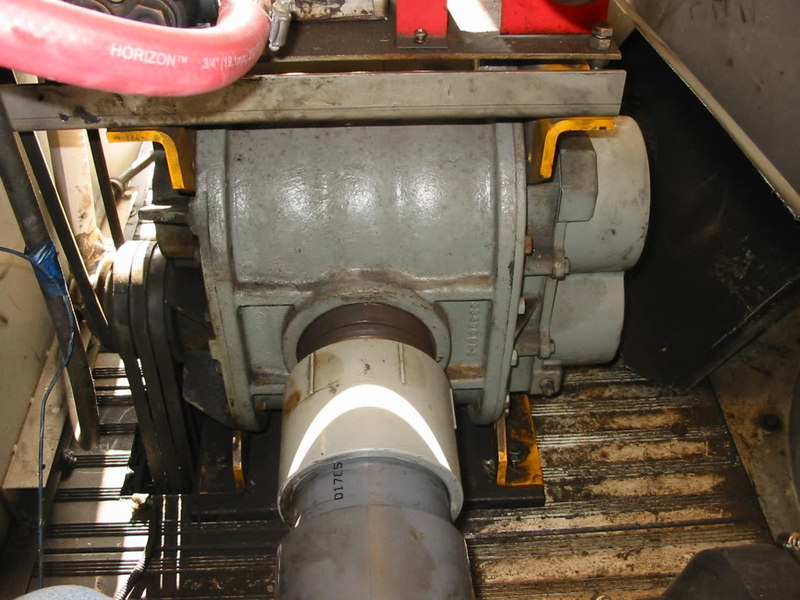

Ok Ron......some where along the line..someone made a few bad choices and gave you some bad advice...and it seems like your problem just snow balled from there....when ever the new legs were made for the blower..who's idea was it not to shim it.....and what exactly did they think that they were going to accomplish by not doing so...the welds alone on the blower stand is a sure sign that it is going to have some type of torque in the metal and it is not going to allow that blower to sit the way it needs to in order for the shaft to run true to the belts....
the only thing that is going to get this back to where it needs to be is....you are going to have to put the angled plate back into the truck and mount the blower back on it...put the pillow block back under the truck the way it was before..as straight and as ridged as possible....line the belts up and take a straight edge and shim the blower right to left and front to back until the belts are as close to being perfect with each pulley as possible....you want to carefully watch how the "V" sits down into the pulley..this will tell you a lot about how it is lining up.....the angled plate is going to put you in line better with the PTO shaft..... no welded or cast part is ever perfect and almost always requires some shimming along with being torqued down properly .....if this is done the right way...then the soft foot issue is never even a concern...there are a great number of theses blowers that are running like this trouble free for a very long time...the angle on the plate is not even close enough to effect this blower....once you are 100 % sure that you have this thing set up as close as it will come....tighten the belt up and give yourself about an 1/2 inch of play.....once it runs for a few jobs the belts will seat them selfs and stretch a little and it will then be closer to about 3/4 inches of play...that is where you need them to be so it does not put stress on the shaft and blow out another seal....

Notice on Brads blower...all he has is angle iron holding his blower in place it is shimmed level and bolted down solid to the plate....
notice my old one....small little wings that both slots are not even being used...you can't see it in this picture but I have shims on the back side to level the belts.....
and now notice yours....probably one of the most rigid I have ever seen...nice and strong...but it starts to taper up to the right...the foot should of been shimmed instead of brought down to meet the plate....way to much torque on this...that blower is under stress.....and is causing the shaft to ride uneven......you can tell just by the way the bolt holes are not lined up from where you removed the one on the side.......be willing to bet it probably needs a shim or 2 on the other side also....
